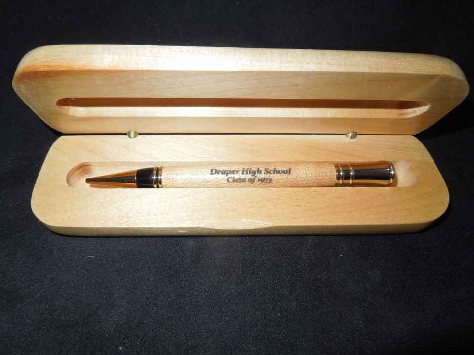

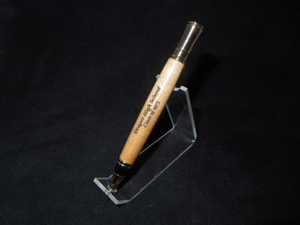

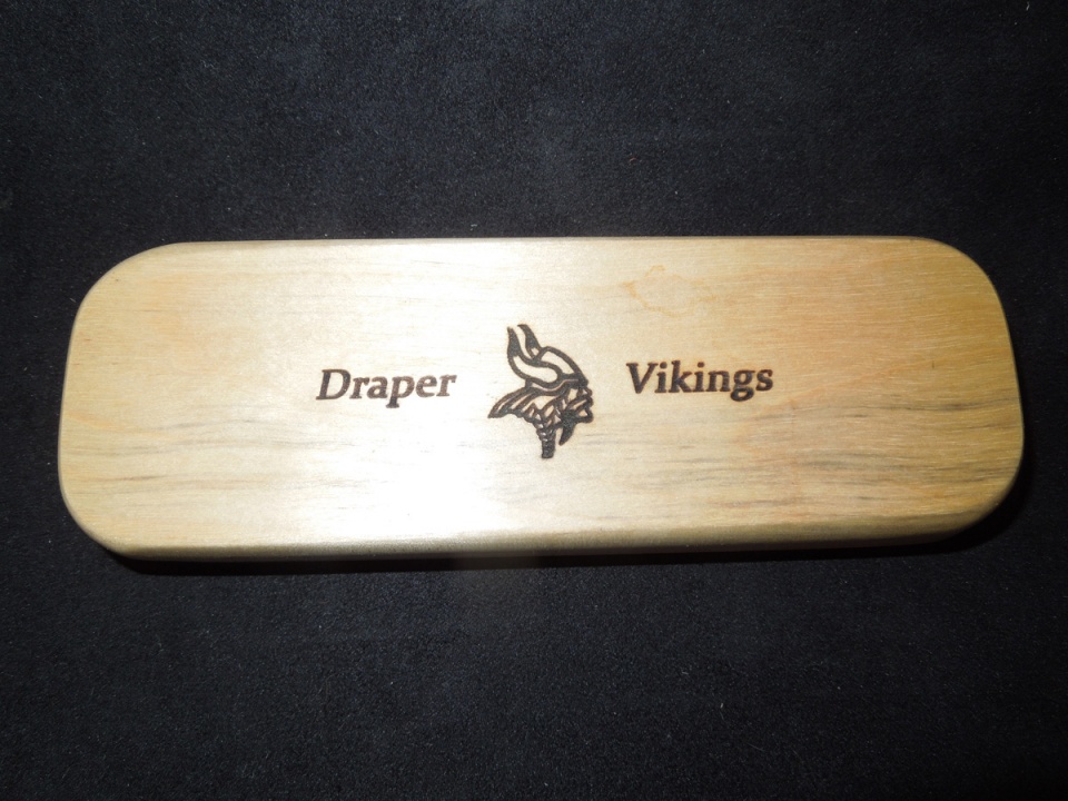

I got my 1000mW engraver in the early fall, but with all the shows I do then didn't really have much time to play with it. Here's my first real project with it.
My old High School was abandoned for years, and it's now being renovated and converted to apartments. I was able to buy about 8' of bleacher wood at the ground breaking ceremony they had in late summer. I'm going to make pens for alumni.
Here's a couple of shots of the pen (PSI Executive.) Also, I was pretty happy with the engraving on the pen box. I did the logo first, then the left word and then the right. I was fortunate to get a very nice clean .jpg of the logo.
Gary

I use MS Word, then use Snag-it or the like and save it as an image. Then I drag and from the image onto the field that the laser s/w provides. There is no leveling, spacing, or orienting involved. MS Word was the only application that I was familiar with; I am sure there are better approaches out there.
I get that part. But he makes it sound like he engraved the symbol then repositioned for each word. That's the part I'm curious about. Interested in how to reposition the piece and keep that level of accuracy.
Very nice!! What did you do to make sure the words were level and spaced correctly?
Yeah, that's the part that I worry may not be as repeatable as I like. I put a light pencil line across the box first, then marked the end of the 1st word and the start of the 2nd word on the right of the logo. Then just ran the preview function until it seemed like I had good alignment.
Maybe I was just lucky that my first try came out well (although I had run a test on a flat piece of scrap 1st and it came out well.)
My plan is to make a small jig with a stop across the bottom horizontal edge to butt the box against. At least that should help with the alignment.
Gary
