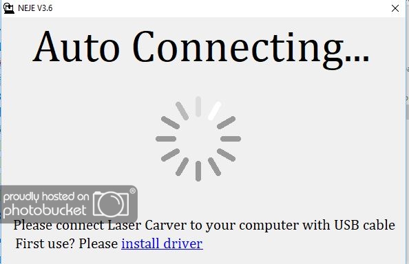

Hey folks. First thank you all for the info you've shared here. It's been really helpful. I recently purchased the NEJE DK-8-KZ from Gearbest. I can't get the software to work or connect to the engraver.
I downloaded the driver/software package from Trusfer.com as the instructions recommend. I didn't run into any problems with my anti-virus software. The driver successfully installed/downloaded. But when I open the program with the engraver connected, all I get is "Auto Connecting" with the swirling icon, and it never gets past that. I know the engraver is powered and connected because when I connect it to my laptop, the engraver and platform zip around for a couple seconds.
So I'm not sure what to do here. Has anyone run into this issue or have any suggestions? I've tried on two different computers, both running Windows 10, and get the same result.
Mine did this also. I found that removing the USB plug from the computer then plugging it back it agin solved the problem
Thanks Bob. So after starting up the program with the engraver connected and you get the "Auto Connecting", you just pull the usb plug and then re-insert it? Tried that and it still isn't getting past "Auto Connecting".
Any other ideas anyone?

My NEJE can't run in Windows 10, can this be the problem???
Compatibility issue perhaps? Just a thought.
The usb lead supplied with the laser causes untold amounts of problems, they are complete rubbish. Most people find replacing it with a new quality lead solves the issue.

I haven't had any issues running the NEJE on my Windows 10 computer, but it did act wonky once when I had incorrectly swapped the connections to the computer versus the power supply. It looked like it was going to work (the laser head moved, etc), then gave me an error message (don't recall what it said) in the software. I'm also using a 2.0a USB power supply, since I've heard that under-powered power supplies also cause wonky behavior.
I had much success with the standard download for windows 10, but couldn't get it to loade on my newest computer. I finally succeeded with this version: NejeLaserPrintExtended.

I got it working. Apparently the software package from the trusfer site didn't work with my machine, or I was trying to use the wrong one (there are many options). It worked using the software from the CD that came with the machine. Thanks folks!

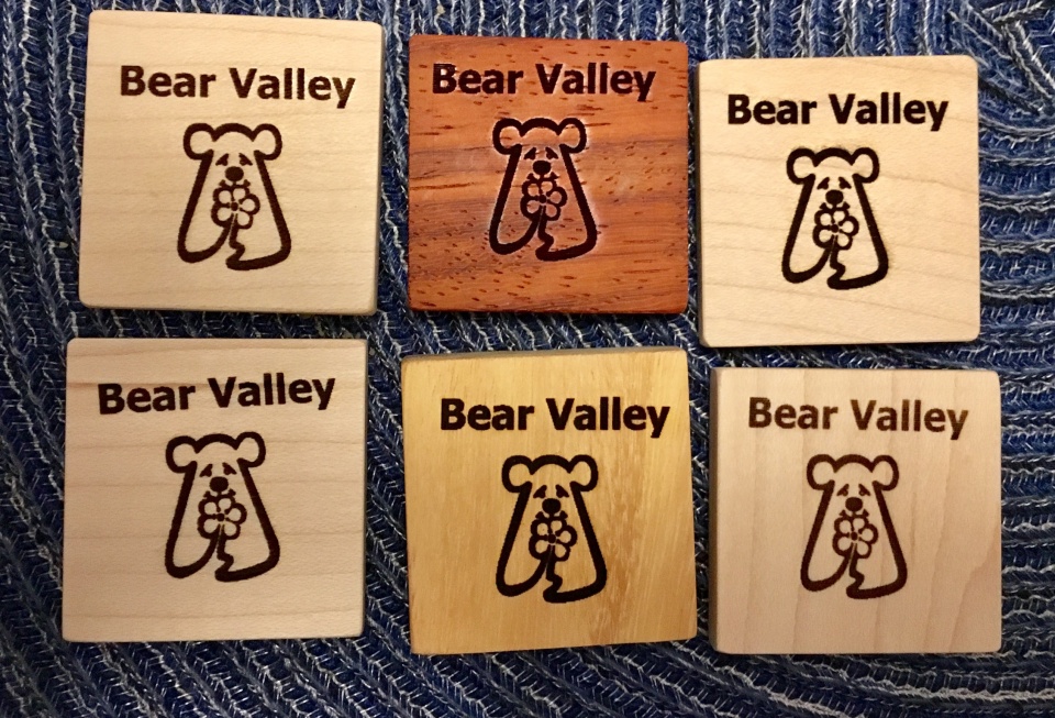

Something else to engrave
Quick success. Frig magnets from my community.
