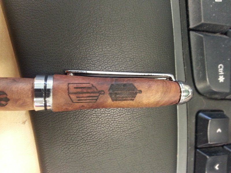

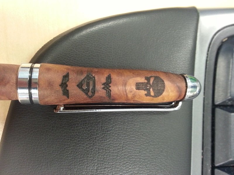

I have the cheap 300mw version. You can actually see it in the background.
This is the first pen I tried 10 minutes after I got it setup. I'm thinking of upgrading it to a 2.5w, or just getting a newer/larger machine.

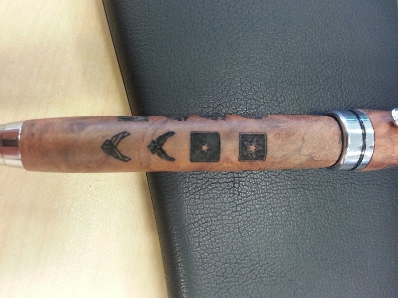

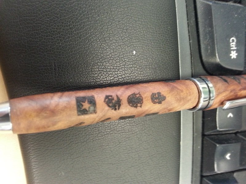

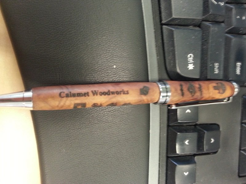

Here are some photos of some of the engraving I did on a Euro style twist pen. The pen is over a year old and was originally finished with friction polish. Sorry for the fuzzy pictures, I just took them at my desk at work. From L to R: Dr Who, Superheroes, Military, more Military, over all view.
I have other pens at home that I practiced on, plus an un-turned blank with various fonts used.
As you can see, the smaller the image, the less detail you can get...but I believe there is some settings in the software program that can change that, but there really isn't a manual.
If these photos should go somewhere else, let me know. Wasn't sure where to put them.

Thanks for sharing, Keith. Did you do the engraving before or after you finished the pens? Also, what did you use for the infill on the engraving?
Right now, no infill used. I do have some powders that I will play with this weekend. As for images, yeah, the smaller they are, the tougher they are to get to look good.
This pen was built last year and the finish was over a year old so it wasn't fresh or shiny. Good results. I tried engraving on a pen that I made on Friday and it didnt look so good, almost as if the friction polish melted a little.

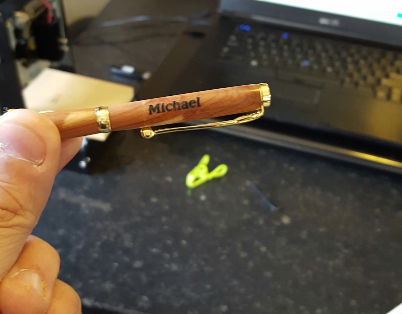

I answered a few questions over on woodbarter about this engraver and thought I would share this little bit of info on the software.
The one I bought comes with a 1GB micro SD card that has the drivers on it. I ran the driver install program and then just ran the executeable. I did notice that the micro USB cord that goes from the engraver to my laptop is a bit funky. Meaning that if you wiggle it, the engraver disconnects from the machine, but the software does not give any indication of this. I end up having to shut down the software, unplug both cords from the engraver, then plug in the power, then the USB to the laptop and then start the software again. Speaking of the software, there NO directions on what the settings do. There is a burn time setting, and a run time setting(?). Other than that, the interface is somewhat self explanatory. I found it fairly easy to pick up what buttons do what. My biggest suggestion to someone using this is to PLAY with it. Don't be afraid to ask yourself "I wonder what happens if I do...". You can engrave on pen blanks to your heart's content. It doesn't burn that deep. You can easily turn the engraving off when you put the blank on your lathe.the one I bought comes with a 1GB micro SD card that has the drivers on it. I ran the driver install program and then just ran the executeable. I did notice that the micro USB cord that goes from the engraver to my laptop is a bit funky. Meaning that if you wiggle it, the engraver disconnects from the machine, but the software does not give any indication of this. I end up having to shut down the software, unplug both cords from the engraver, then plug in the power, then the USB to the laptop and then start the software again. Speaking of the software, there NO directions on what the settings do. There is a burn time setting, and a run time setting(?). Other than that, the interface is somewhat self explanatory. I found it fairly easy to pick up what buttons do what. My biggest suggestion to someone using this is to PLAY with it. Don't be afraid to ask yourself "I wonder what happens if I do...". You can engrave on pen blanks to your heart's content. It doesn't burn that deep. You can easily turn the engraving off when you put the blank on your lathe.
Once I am done with my current commission I plan on shooting a full how to video of this thing.
