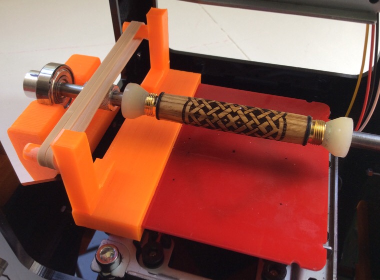

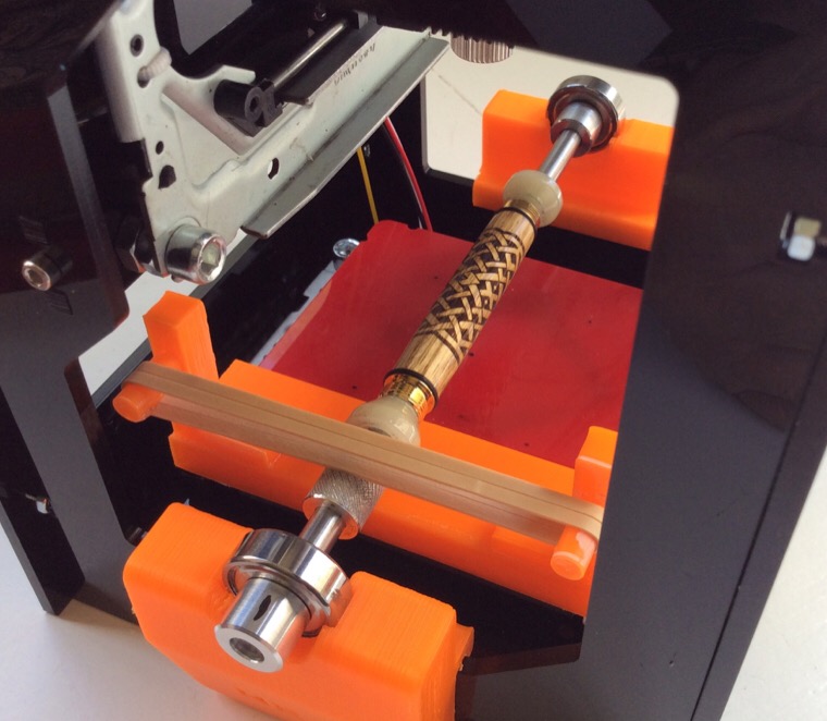

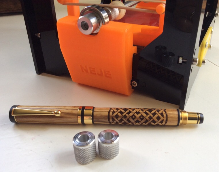

Here's my rotary engraving solution for the NeJe laser engraver. I'm using the 1500 mw version.
I used the concepts and basic design of the various pioneering efforts documented on the net. I designed the brackets and supports in Fusion 360 and printed them on a 3D printer. The mandrel is just a piece of 1/4" cold rolled with the diameter reduced a few thousandths. The bearings are ones I scavenged from some old inline skates. I was able to turn the bushings and the drive wheels on my metal lathe. The drive wheels are knurled to ensure no slippage against the rubber bands. The drive wheels are sized to the various barrel sizes of pens - they don't need to be exact just fairly close. I'm using plastic finishing bushings to hold the barrel square and secure.
Shown is my latest pen engraved with a Celtic knot design.
