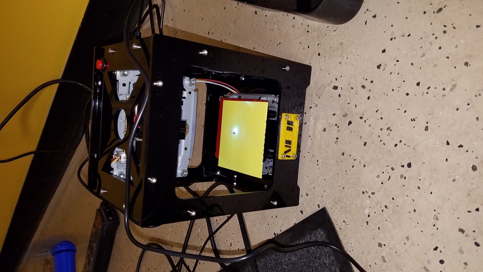

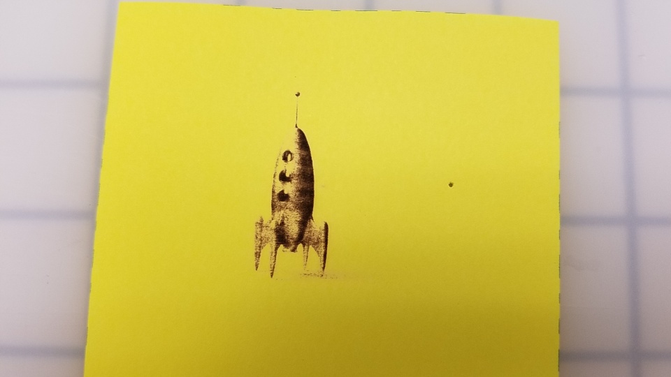

Slight fail.
I used some post it's since the unit came out of the broken. One of the rubber bands didn't make it.
But anyway slight fail. Had the laser turned up too much first time and burned right through. This came our better. I think I have focusing issues.

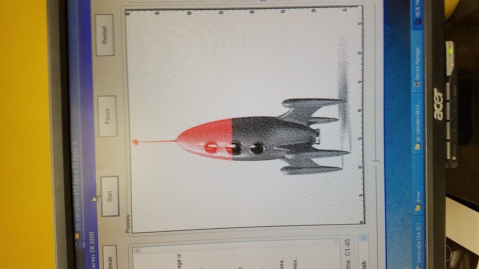

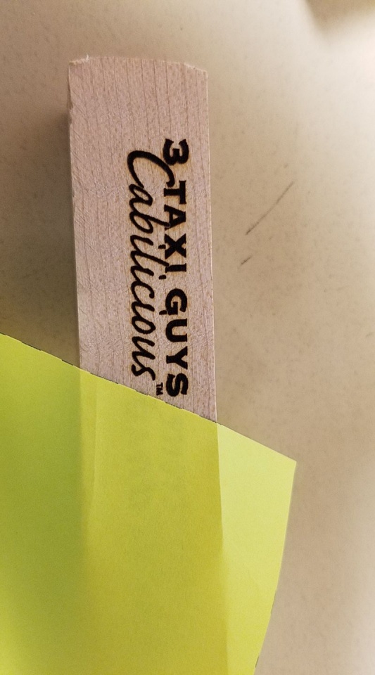

Ok Third real test and I'm very very impressed. I even think I can get it better with more fussing with the focus.
Also for what it is the software is very nice if you don't understand computers much. It scans all your com ports looking for the device versus you going into control panel and finding it out.
Just so you know I'm running it on an old but rebuilt XP machine.
Looks pretty good to me! One other thing you can try (besides focus adjustment) is to give it a very light rub down with 320 or 400 grit, it can remove some of the "fur" around the edges of the burn and really get things crisp.

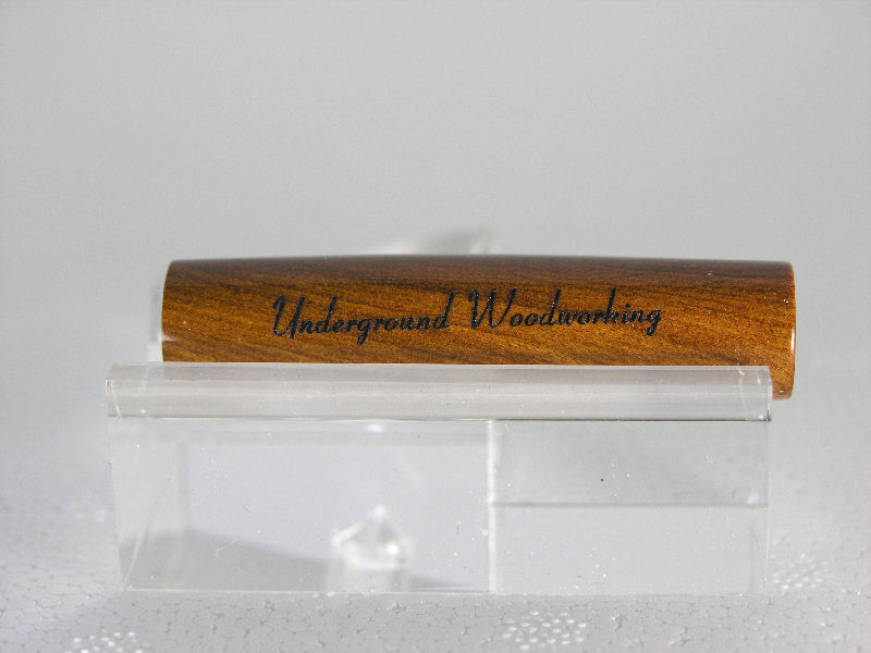

I have used one of these lasers to burn on pens both finished and unfinished. Both work equally well.
Mine is able to burn antler and acrylic as well. Doesn't do amazing on these materials, but it will work. One tip for these materials is to turn the burn time up so the laser stays on longer, and also put a strip of painter's tape over the surface. Light colored surfaces like antler and lighter shades of acrylic reflect the laser rather than absorb it. The blue painter's tape helps combat this since it's a dark color that is non-reflective.
Also, I put a small piece of the non-slip shelf liner on the laser bed. This not only helps hold stuff in place while burning it, but it also gives me a grid to line up to that helps keep everything square.

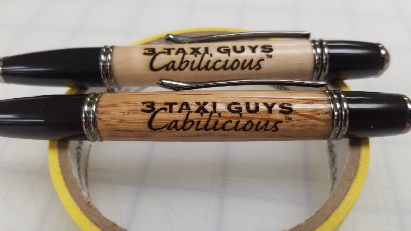

Over the week end I brought home the engraver and set it up on a win 10 machine. Throughout this thread there are posts on getting working in win 10 well no problems, I didn't even have to install the driver.
I'll post pics of the pens tomorrow. I still have to work on my rotating jig. Right now its a piece of all thread on two oak guides. I need to come up with a way to have a little adjustment since the laser is not right in the middle of the machine and its a little crooked.
But my first two pens came out way better than expected.
I'd always wanted something which would fulfill the means of personalizing pens, and pen boxes. I had just recently bought a package of those WaterSlide Decal Papers, for my laser printer. I Haven't gotten around to using them, yet, but learned (after the fact of ordering) that these decals WOULD show slight border lines of the cutout decal's application.
For the past few days I had been looking at - and pondering the purchase of - the very laser engraving device that folks, here, seem to be in much favor of. It is on the strength of this that I JUST NOW submitted an order for one. A responder to this thread provided a link to the one that most everyone had been making reference to. So, yes, my order has been put through at a cost of $67.54 (free shipping).
After having read further, through this thread, I'm kinda feeling a bit of regret for not having paid the $10+ more, for the purpose of expediting the shipping. I think I recall that the expedited shipping translated into a 3-7 business uday shipping time, whereas the free shipping was stated to take between 7-10 business days, to realize receipt of the package. I'm not a very impatient chap, and would have no issue wading through those 7-10 business days. However, I've just read where one purchaser was in wait for at least six weeks and, even THEN, had to get PayPal involved.
Well, I hope to not have to experience anything like that. I'm looking forward to getting that 'toy' :smile:, and putting it to task on some nice pen projects.
Here they are.
They are oak and maple. I know, nothing special about the blanks but I wanted to show off the engraving and its what I had in the basement. Also Rockler isn't open at 10 PM on a Sunday. :(
But I was quite surprised how crisp they are. The oak has a BLO/CA finish and the Maple has a Shellawax Friction Polish. i would have used it for both since I wanted a really quick finish but the oak was of course oak. I can't find my macro lens for my phone so I can't really show how clear the little "TM"
I think I'm not going to finish them any further. The reason is that they still have a nice "campfire" smell to them.

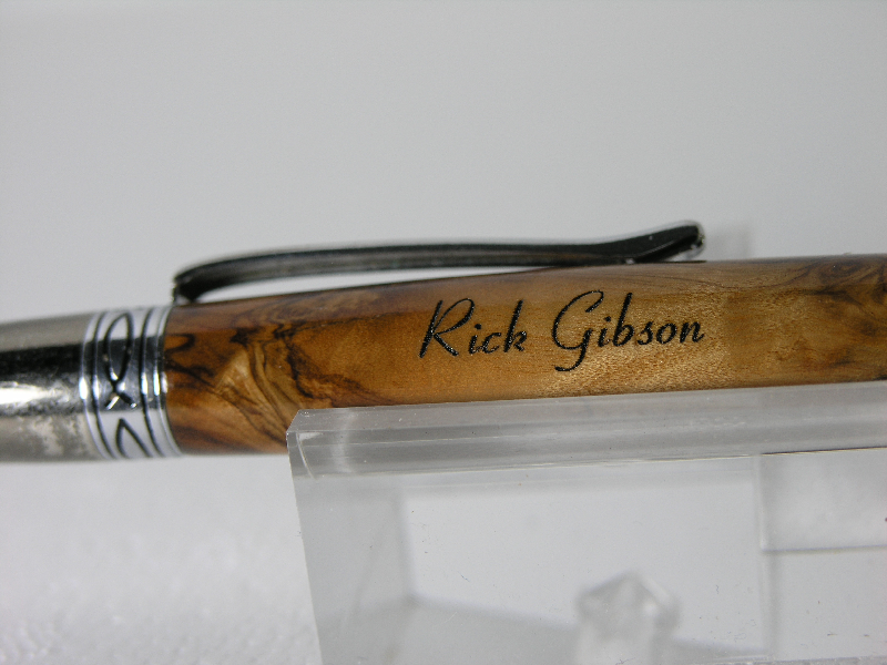

Got it this afternoon. Plugged in the software and got an unrecognized character cannot unzip error. After playing around and checking the internet to see if the software was available on the gear best website (it's not or at least I couldn't find it.) a light came on renamed the file using standard characters and everything worked as it should. I tried it on some veneer I had and it seemed to work fine. Then decided to try a pen blank I had and never used. The blank had my normal CA finish, about 8 coats of CA. For $100 Cdn. I'm happy. The white you see in a couple letters appears to be some CA, a light brush with a toothbrush and they are gone. Considering it costs me $20 to get a name engraved it should pay for itself fairly soon. Next step is to build the rotary setup I've seen on here. It actually looks better than the photo shows.
Hey Rick, that looks REALLY nice. I am truly impressed, and seeing what you've done makes me feel even better - and more anxious - about MY machine getting here :smile:.

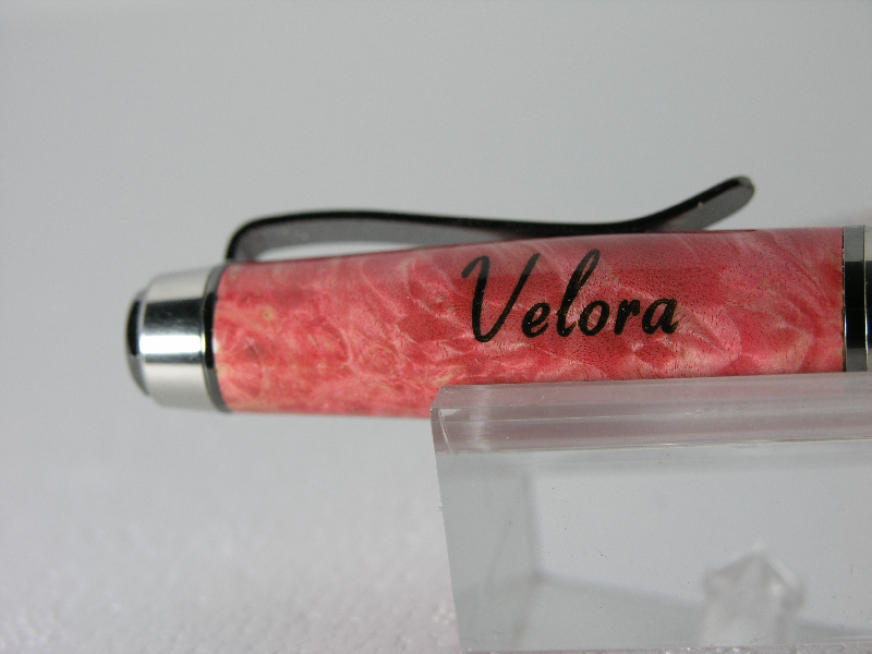

After a couple days fooling around I finally tried it on my pen and one I was making for my wife. Mine was CA finished 4 or 5 years ago and it's been my daily carry pen. I burned it through the CA with a burn time of 72.
The one for my wife I messed up on and had to sand it back to bare wood then added the colouring. Burned it with a burn time of 40 on bare wood. Then applied the CA finish.
Tried building a rotating mech. for the pens but not totally happy with it. The elastic band used to drive it tended to stretch a little before the blank started to rotate resulting in a little compression of the top. Likely wouldn't be noticed by someone else but I did so will have to find another way to drive it.
I played a little with some of the acrylics I had and found some worked and some didn't. If I took a black sharpie and went over the area to be worked on it seemed to give better results. They were mainly cutoff pieces I had so couldn't tell you what they were all made of.
