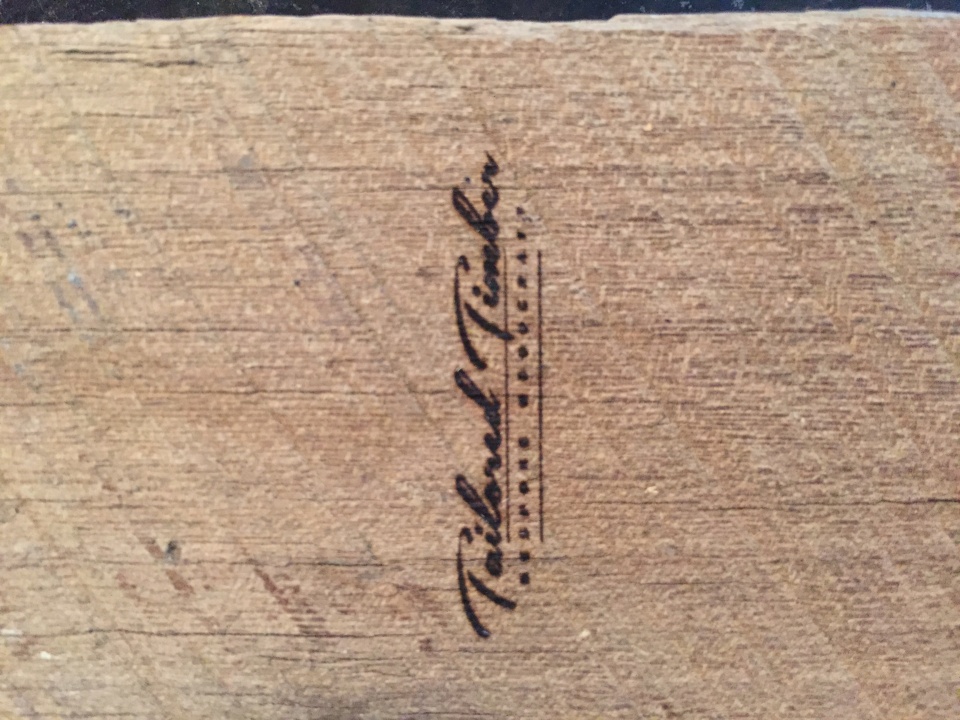

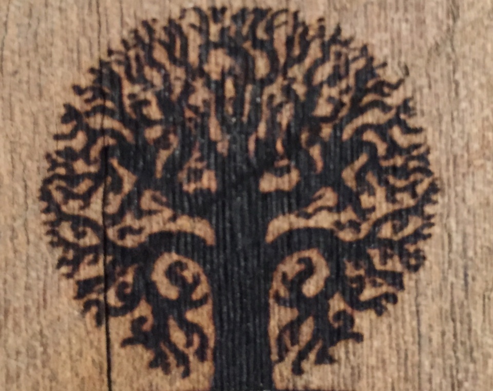

Over a month after ordering my laser it arrived. Turned out decently well for the first burn out of the box! Just need to figure out how to make the image a little bigger. Any ideas?
What are you using for a photo editor? The max size of an image for the NEJE is 500 pixels x 500 pixels. I usually use Photoshop Elements and/or Lucid Press to create an image, then drop it into Paint with a canvas size of 500x500. Then you can re-size the image to fill the space as much as possible.

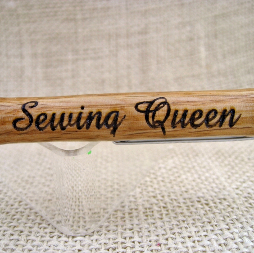

You're welcome! Do show us what you do with the engraver. I've sold pen boxes with my engravings and now I'm having good luck selling Comfort pens (using PSI's pre-drilled Bamboo blanks) with engravings and a friction polish. Quick to make, and they are selling at $29.95.

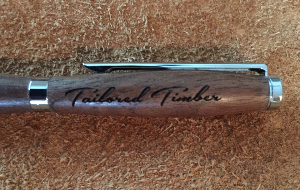

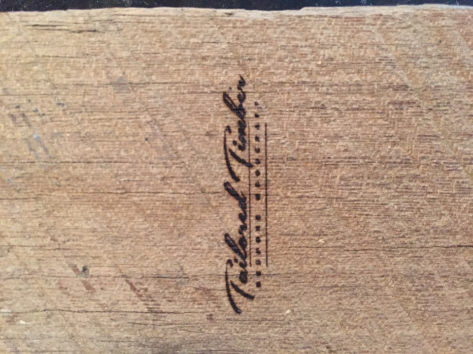

I finally got a chance to try my logo on a walnut slimline that was my first ever pen I made.
Question: has anyone tried applying CA over an engraving?
CA should work just fine over an engraving ... works great over decals too! :)
Very nice. On my engraved pens, I'm usually doing a Myland's friction polish finish. I put the sanding sealer on, smooth it with 0000 steel wool, then engrave it. Next, the friction polish goes on. Makes a nice finish, and quickly, to boot.
