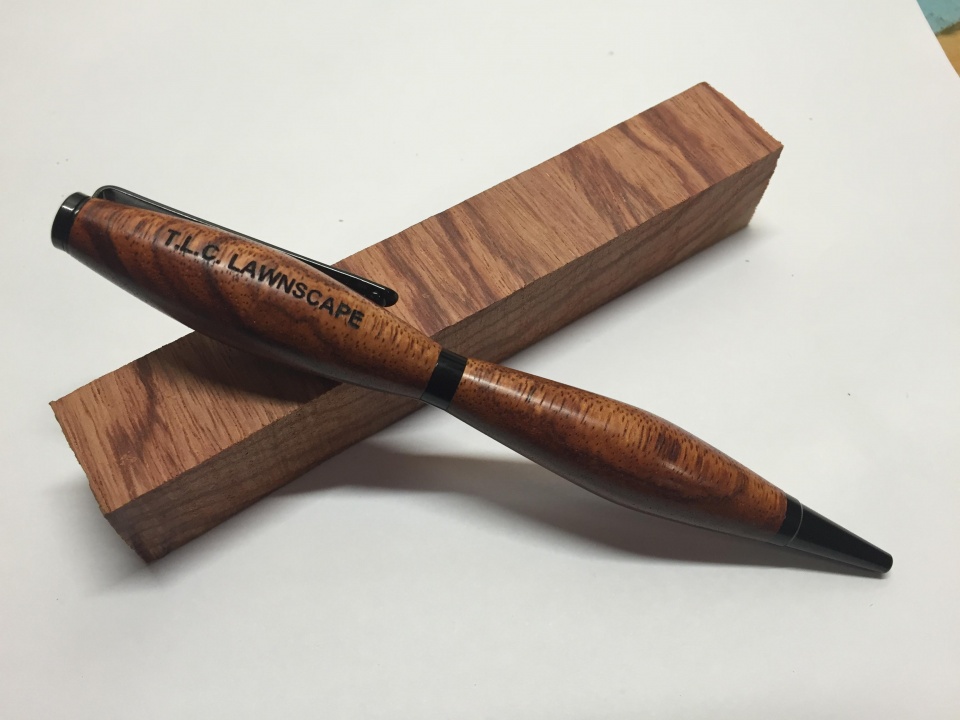

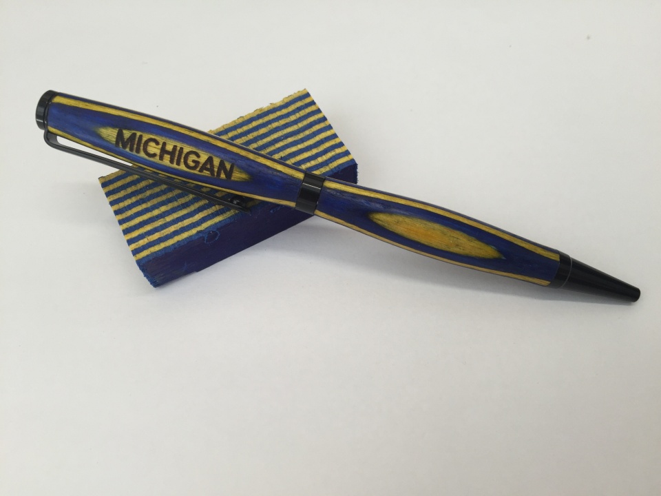

First attempt!!
Well after too many days of fighting with the computer I finally got some results!! Not 100% happy with the pen overall but it's more a result of the learning curve/issues I had with monkey wood than the engraving. I tnink the engraving came out better than expected!!
Thanks to Michael for starting this awesome thread and for the emailed software. Lifesaver!
Keith, the engraving looks great! I'm down in the shop turning some pens--just took time out to start the laser again--doing up some wooden 'fridge magnets for sale at upcoming shows.
I think the pens look nice. I'm not a fan of "Fatlines", but if that's what the customer wants, then so be it.

I'm typically not a fan of the overly fat ones though I like a little shape. The monkey wood one turned out too fat but after ruining 5 other pieces my goal was just to finish! Luckily I think I found the trick and can could've gotten it slimmer. But that's part of the learning process!
