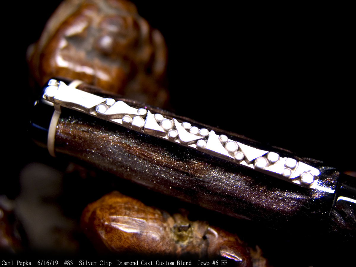

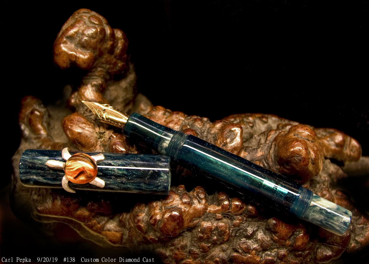

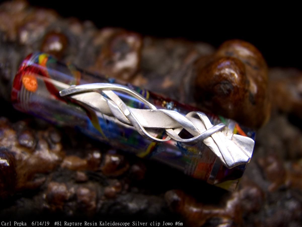

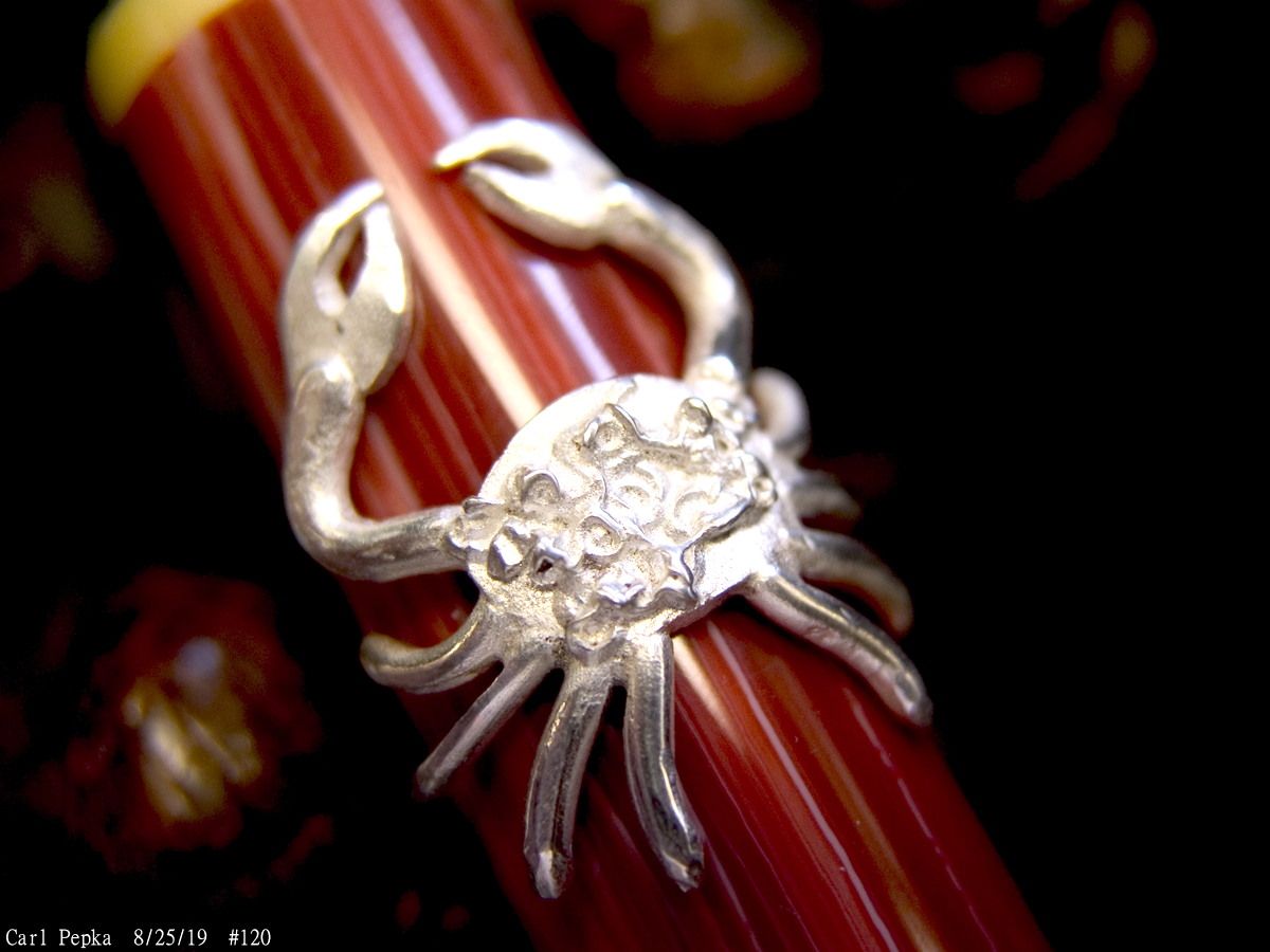

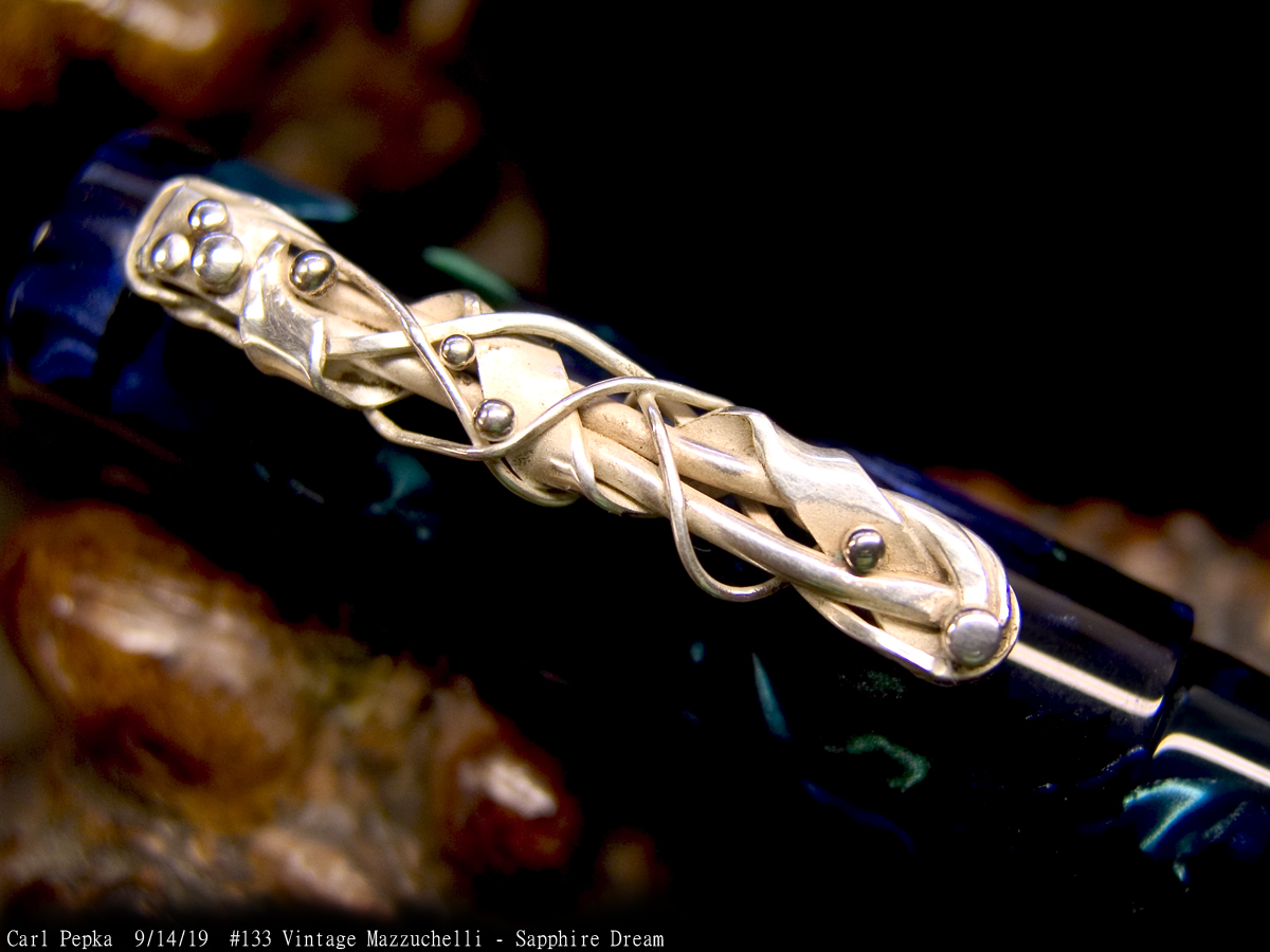

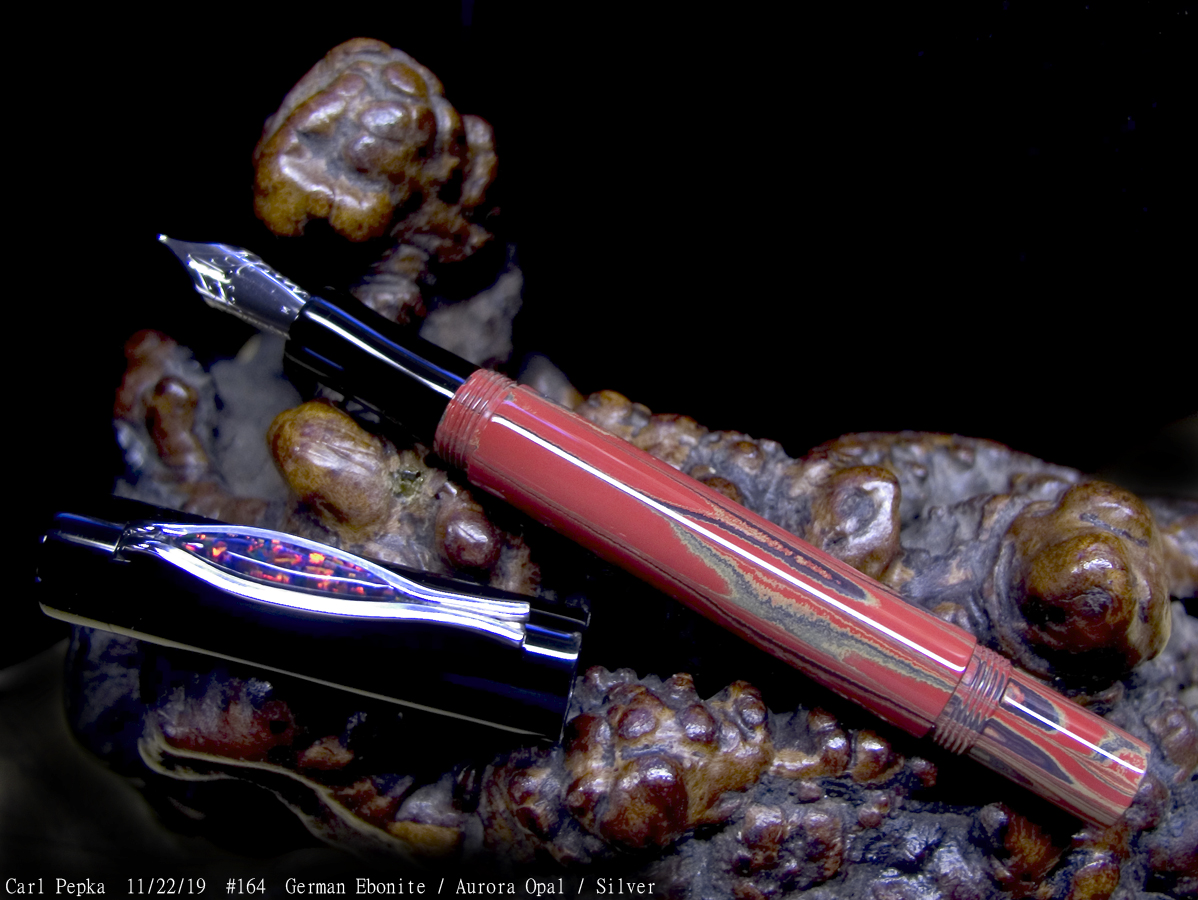

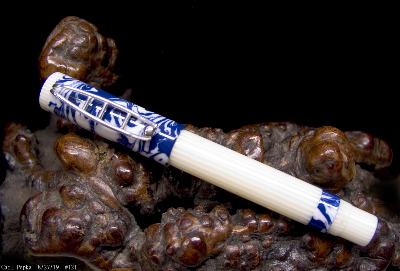

Had the same problem when I wanted to start making my own clips. Having a background (decades ago) in working with silver that was my choice, easy to work and solder and I could also set gems into it easily. I mentioned it in a FB group and was told about Argentium silver which you can harden in a regular oven which will give it spring and it wont bend. I'm still experimenting with diff gauges and how they effect function. The distance between the clip and the cap body also makes a difference on function in terms on how thick of a material a clip can go over. I make fountain pens only and most sales go to collectors who dont really use the clips in a pocket, they use sleeves and cases. Clips for them are more decorative than functional and many prefer a roll stop to a clip. If you decide to use silver feel free to ask me any questions and I'll help if I can. Some of my clips and stops that I cant imagine being made in any other metal than silver.

It is basically like sterling in most ways and is silver with a alloy other than copper. You heat and cool quickly to soften for working just like sterling, when your finished you put it in a kitchen oven at 500 degrees for a hour and a half then let it cool to room temp and it hardens then it wont bend easy and has spring to it. Lots of vids on youtube under "Argentium"
