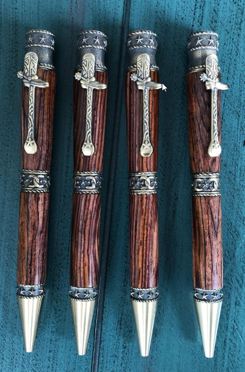

I actually bought Alan Lacer's skew dvd, but here is a free video. Watching his DVD, I sharpened my skew and turned these without sandpaper.
But I did watch the video 5 times.
I use the CBN setup from woodturners wonders.
