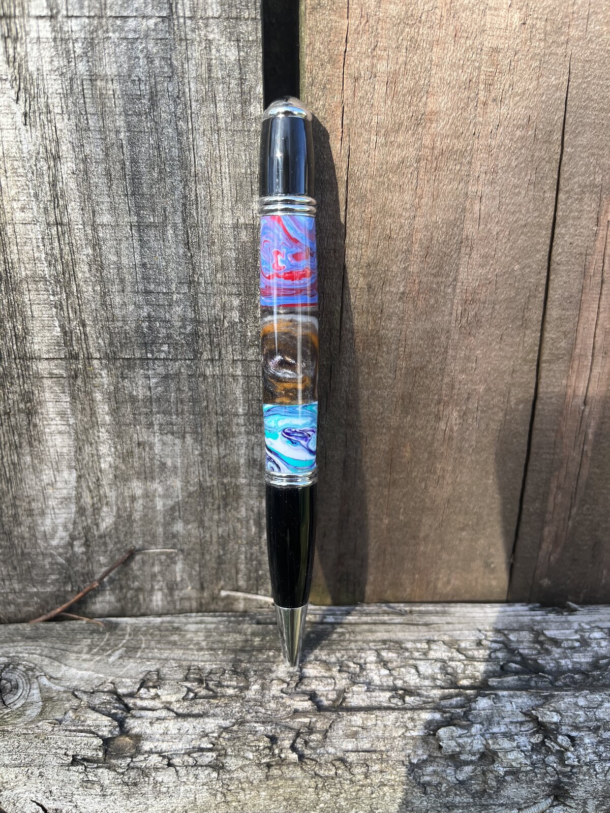

I've incorporated a few acrylic or other resin cutoffs as segments in wood segmented blanks. Sometimes, a little bit of resin can be just the ticket to making something interesting and unique, and a level up from just a simple solid or single-style blank.

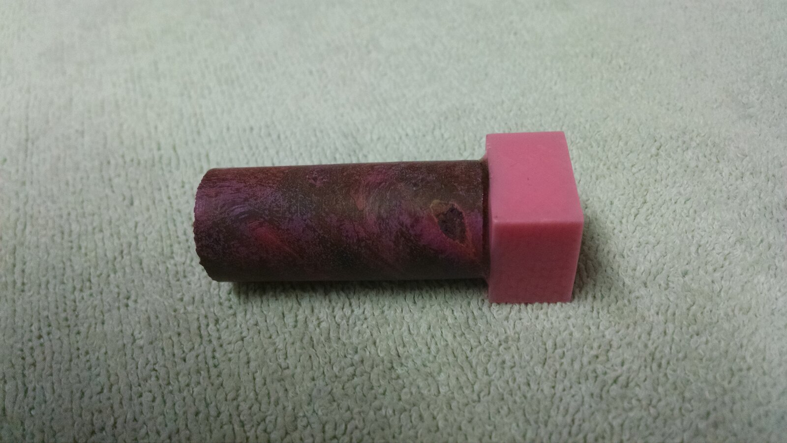

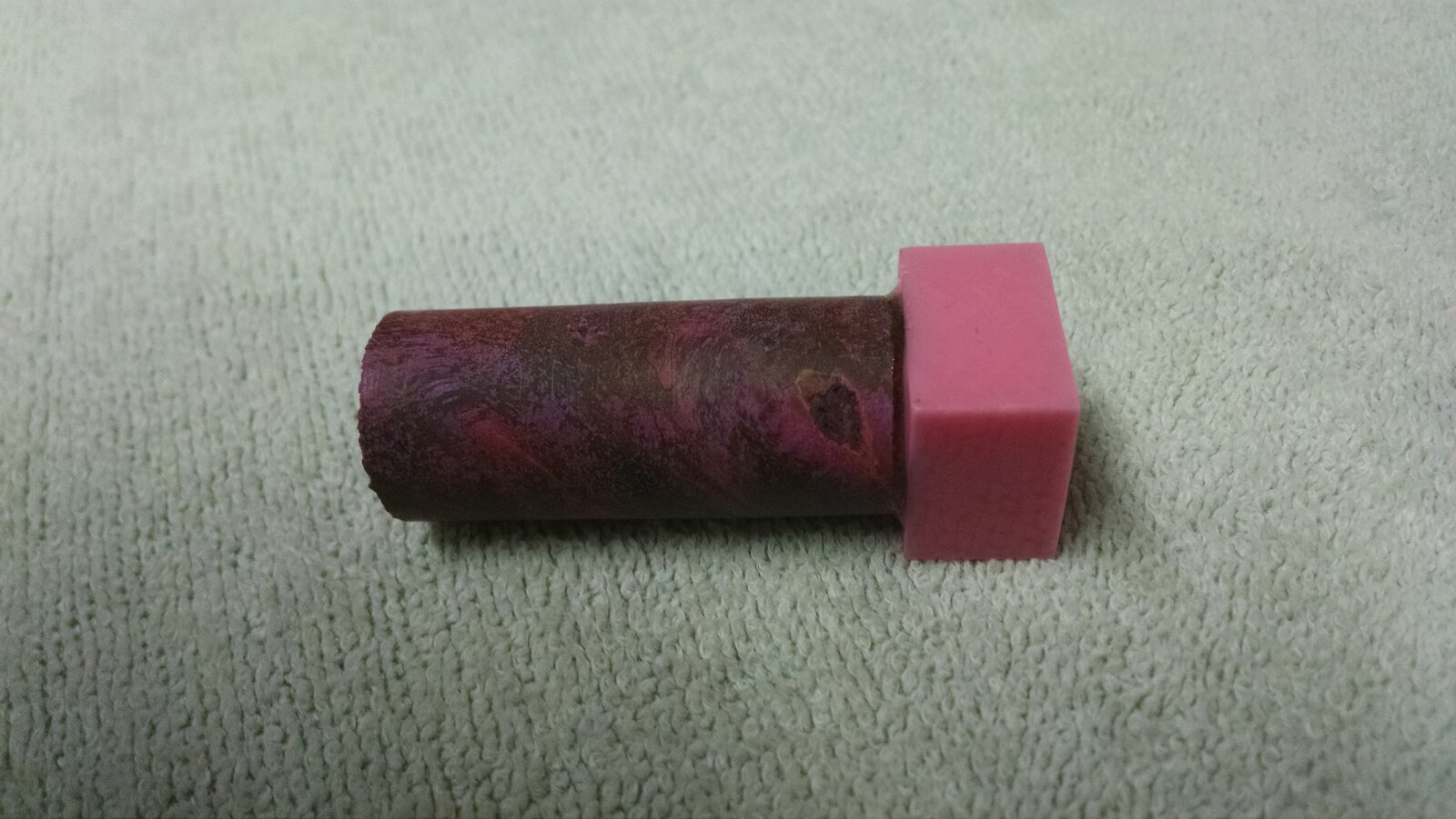

I remembered a blank that I turned for the soft grip Slimline. I had a piece of solid pink and glued it to the blank. Don't have a photo of the finished pen.

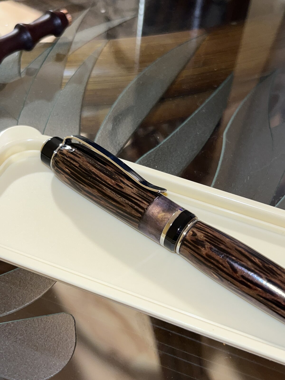

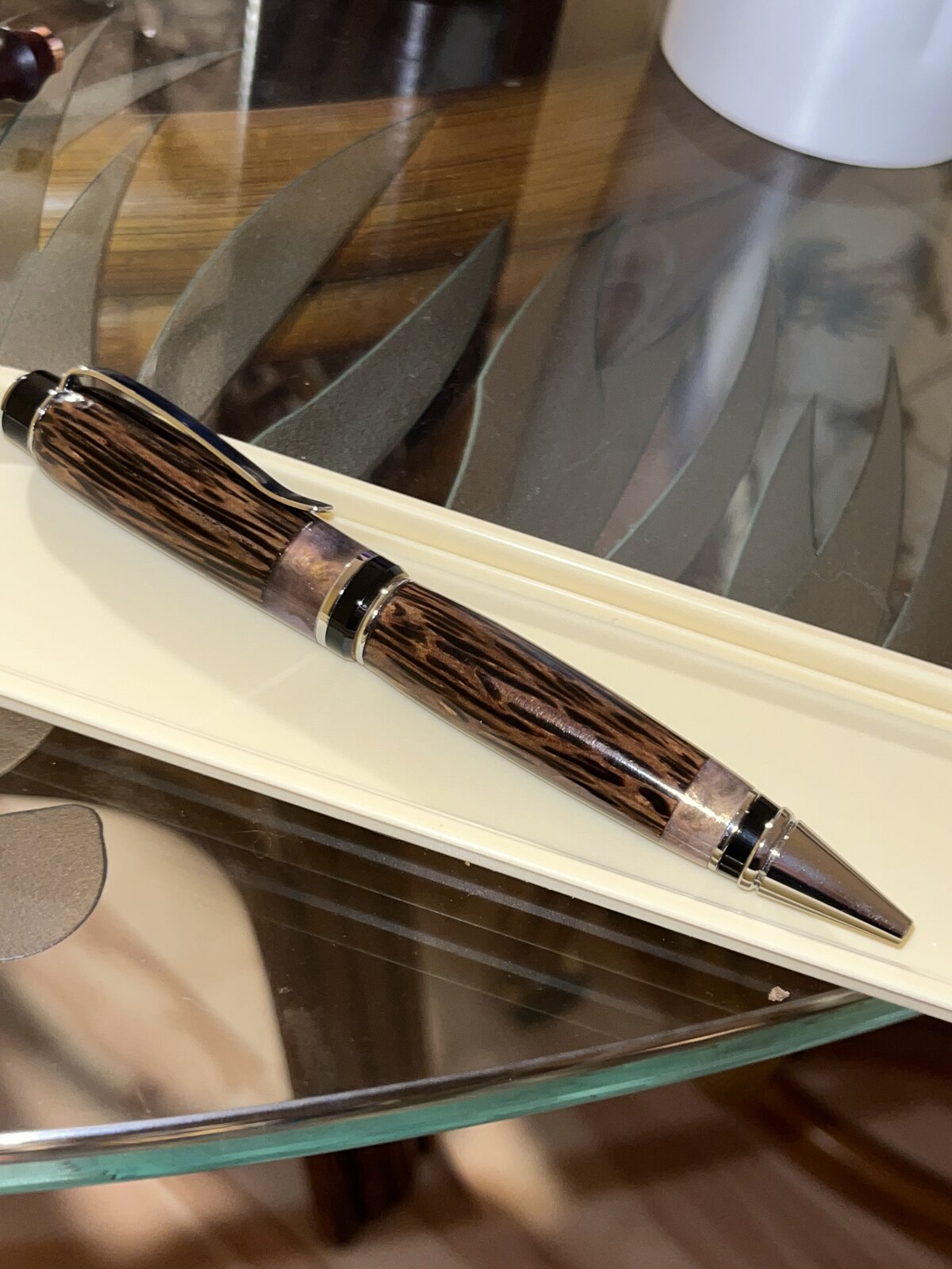

Occasionally I'll mix mediums like those, but most often if I'm mixing mediums, I've had a chip out on the end and I want to save the blank, so I'll use my parting tool to square off the blank remaining on the brass tube and drill a small piece of complementary scrap for the contrasting collar. Saved a few blanks that way.

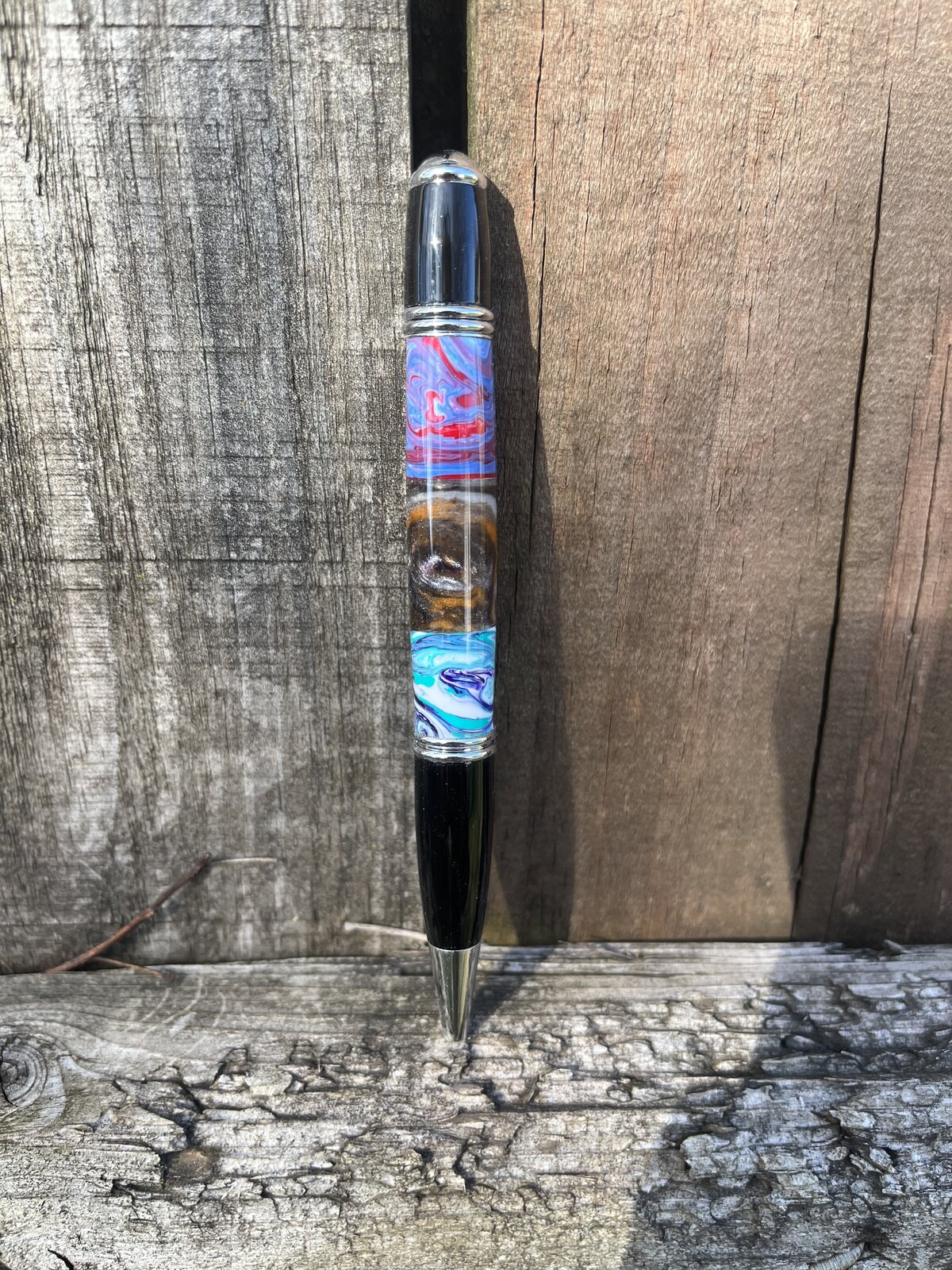

I do that all the time. Someone here called them "chaos" pens. It's as good a name as any and they're kinda like a box of Forest Gump chocolate. You never really know what your gonna git!

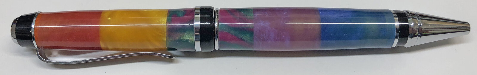

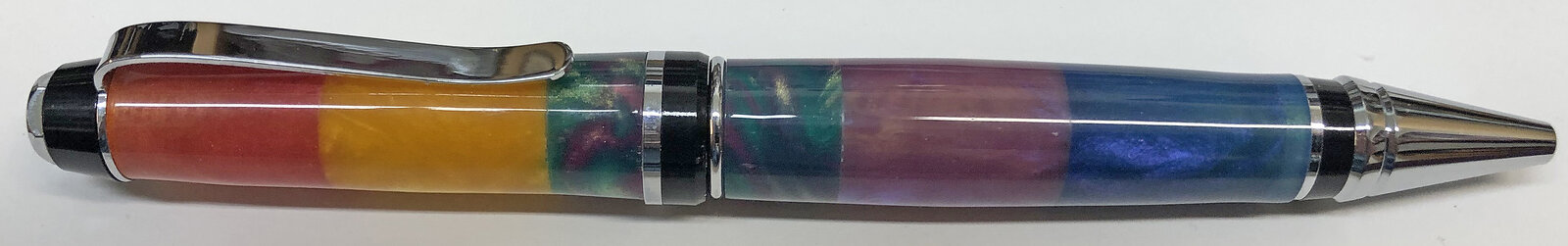

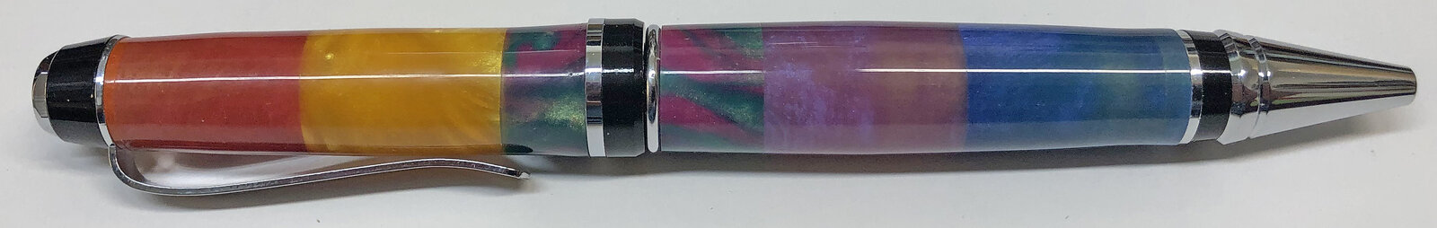

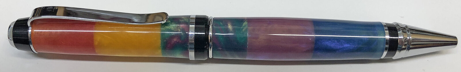

For whatever reason, I've been saving off cuts from alumilite blanks. Decided to simply stack a few of them to make a new blank. I cut blanks on the bandsaw without a jig, so my joints didn't line up perfectly. I could feel a small ridge at the joints so I finished with CA to even out the surface.

It shows what can be done with scraps that are tossed in a box, just begging to be used in a blank. The pens shown here are the result. To all, thanks for sharing.
