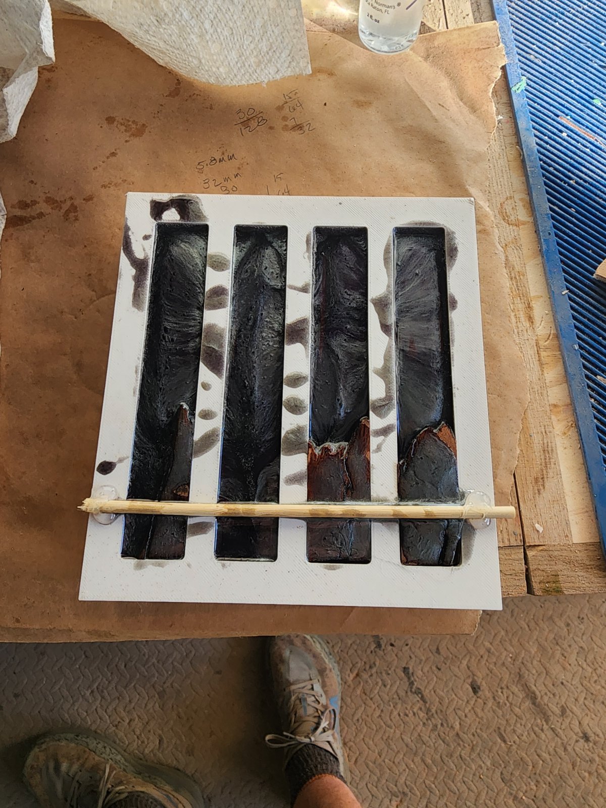

Had a friend print a 4 wide mold. Tried it with epoxy resin and now i can't get the blanks out. Tried drilling hole in the bottom for compressed air. I did apply mold release. And suggestions on how to demold would be appreciated. Thanks.

Unfortunately 3D printed molds are not easy to demold, especially with epoxy because resin gets between the print layers (those little ridges you can feel) and it holds on. You can try putting it in the freezer to see if it releases but most likely you'll have to cut your blanks out and ruin the mold. Printed molds aren't meant to be used like hdpe or silicone molds. They are either one time use molds or you have to take other steps to prepare it for use. When I print 3D molds for resin I leave the bottom off and line the inside of the mold with clear packing tape. Then I hot glue it to a flat piece of wood or plastic also covers with tape. This makes it easier to demold, and resin will pull away from the tape easier to reuse the mold (after it cools off). If you try to demold it while it's still warm, the printed walls will deform.

I have used a torch to soften then the print so I can remove hidden magnets on failed experiments. A few seconds of the torch and the mold will soften, of course this is destructive to the mold.

Ugh. Should have done more homework forst. Thank you. Does Alumilite resin fare better than epoxy?

I use alumilite urethane in 3d molds often but if I want to demold them instead of turning them off, I coat the inside with clear tape. A heavier tape around 3 mil works best.

I tried using my 3D printer for molds and it was an epic fail - the layering of 3D printing is not smooth and it basically becomes little teeth stacked on top of each other holding whatever is cast into the mold. Using epoxy just makes it even worse at it tends to stick to everything even silicone molds. At this point I only consider a 3D mold as being single use, and turn them away in process. Not what I hoped when I invested in a good 3D printer, but it does come in handy for a lot of other stuff.

In my experience if you want to 3D print any type of reusable mold, definitely go with TPU. Shore hardness of 95A is stiff enough to hold it's shape while still being pliable to bend enough to get the casting out. Plus it stands up to the heat really well. I have a couple single blank molds that I printed in 2022 and they are still holding up great. Just hit it with mold release before casting and it's good to go!

I think you should use Polypropylene (PP). With some care it is magical material. Almost nothing sticks to it, see the failures on the web to glue anything to it. No superglue or epoxy holds. I tested that myself. Now for some practical points:
PP sticks to nothing but itself. You can buy pp-sheets to print on but a good solution is packing tape. I have a creality K1 and use the backside of a buildplate to cover with packing tape. Then, it warps. Warps! Let it cool slowly. And for your use I would suggest to print a couple of layers as bottomcover, wider than the blanks (like a sheet of paper) and print on that the walls for the blanks (like open coffins). If it warps then screw that bottom sheet to a piece of wood, maybe with a little frame or something. Glue doesn't work, remember? :))
When the blanks are hardened out, unscrew and take the blanks out. PP is bendable so it should be relative easy. And your mold should be reusable.
