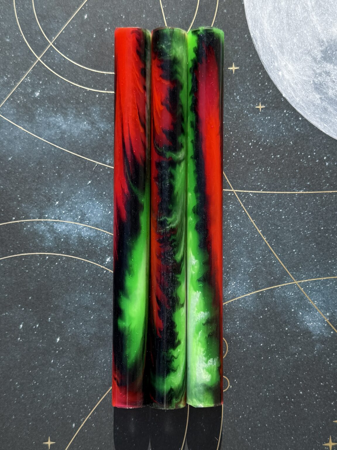

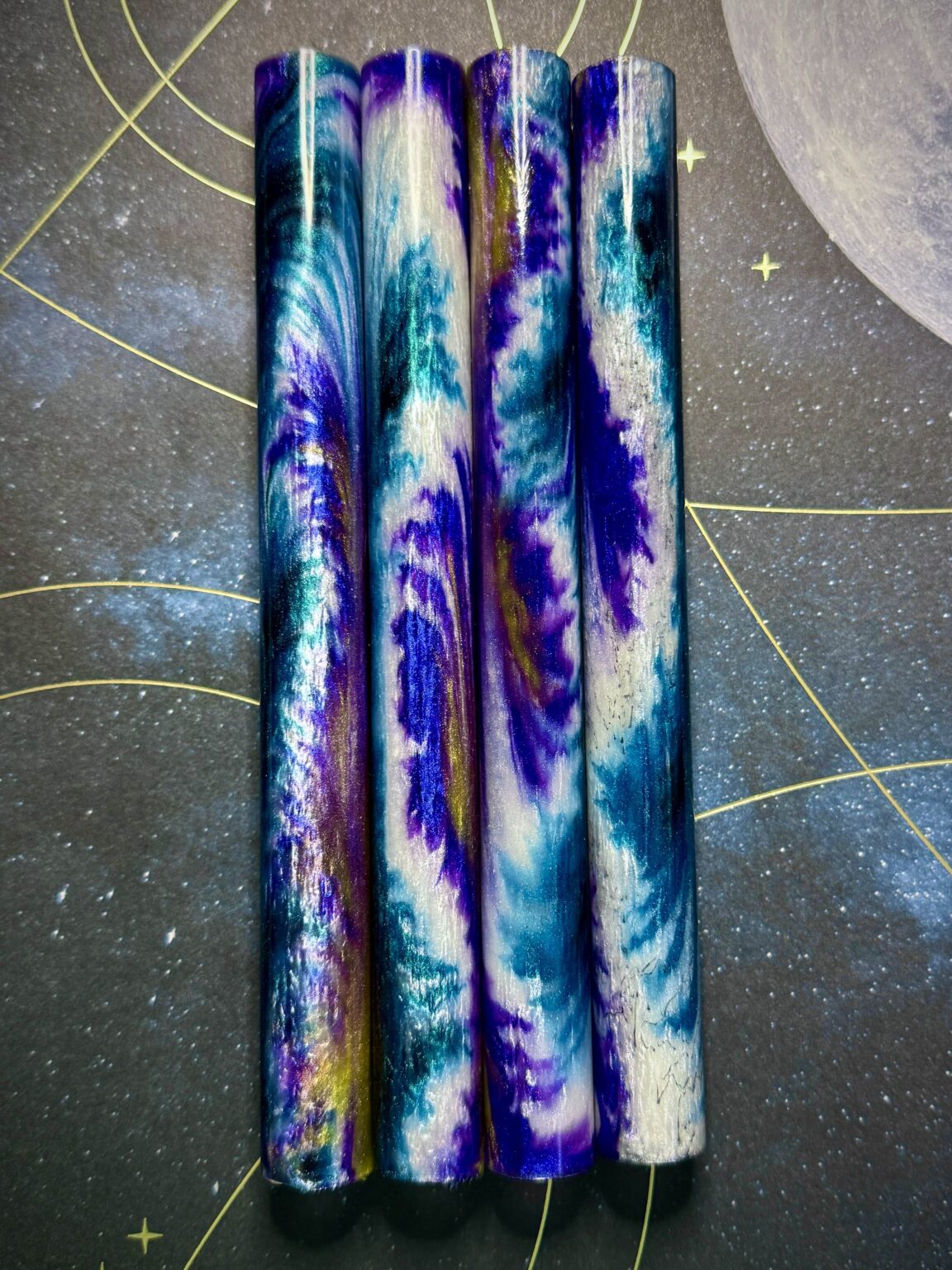

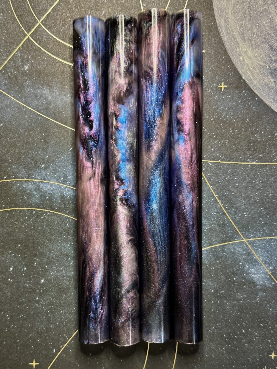

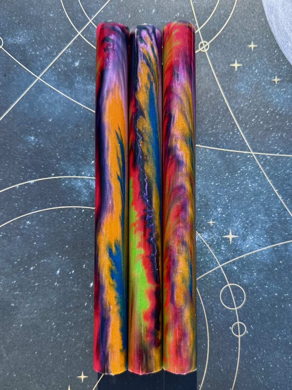

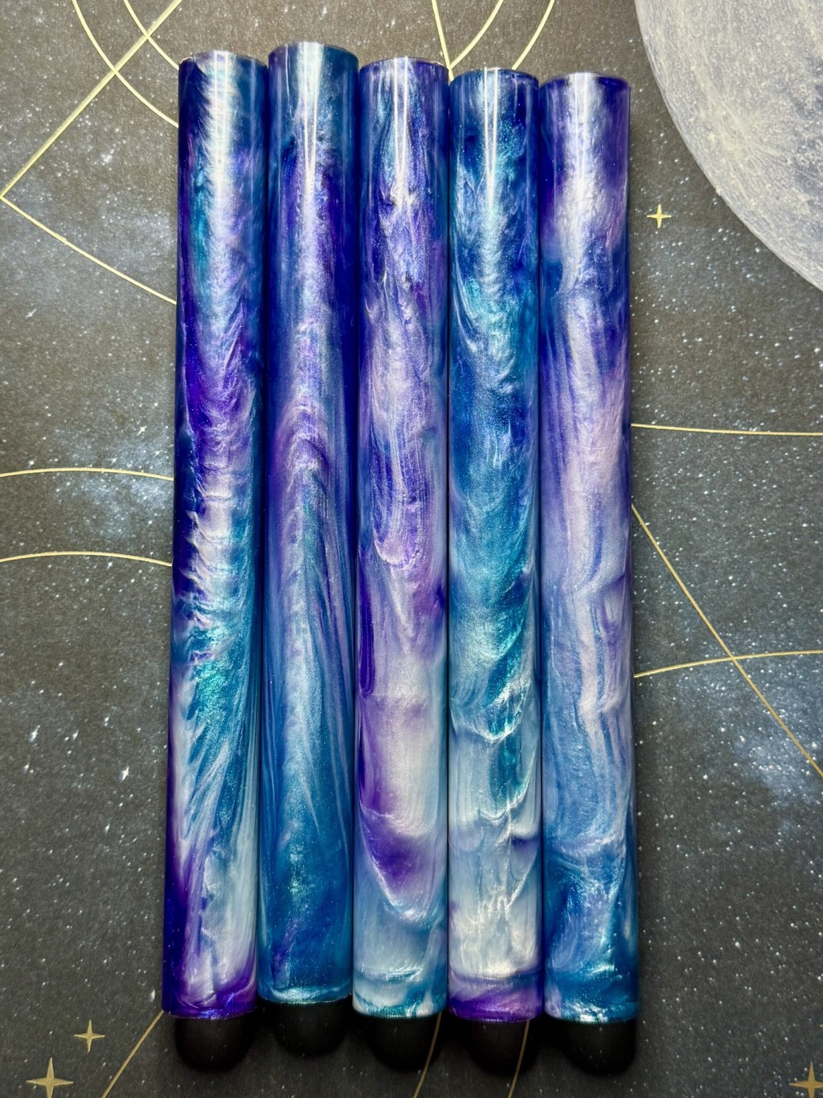

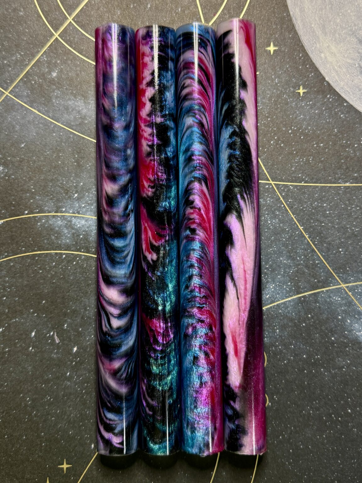

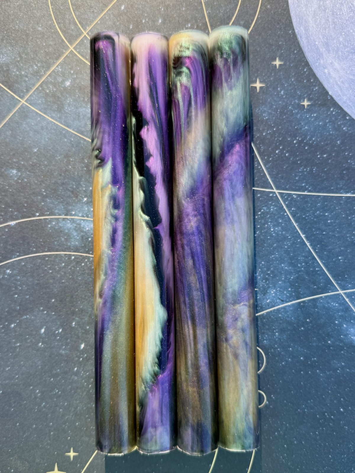

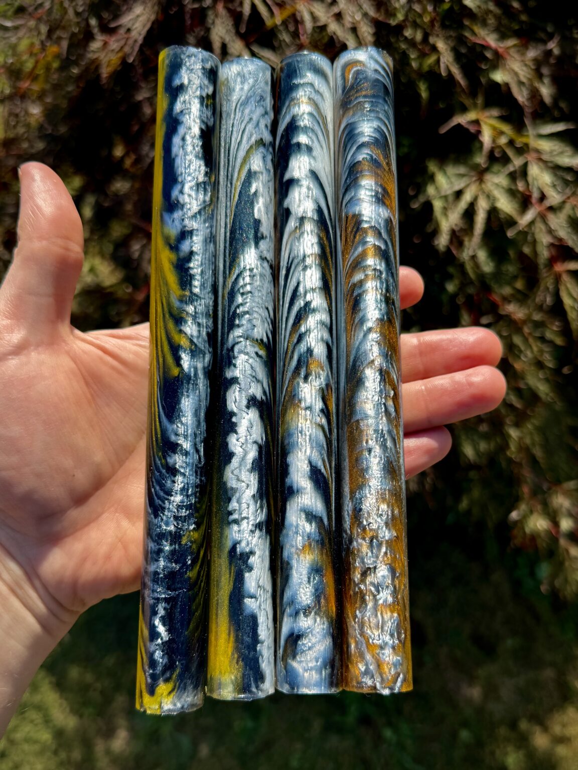

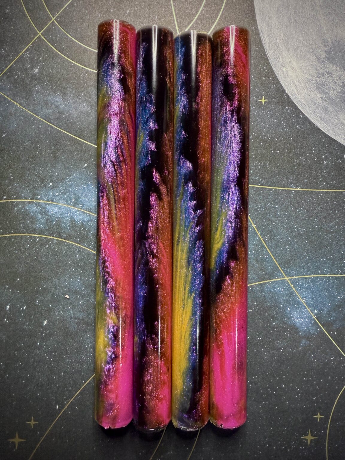

Here are some of my favorite pours so far! Critiques welcome!
The color patterns you're getting our amazing. Care to share your technique?
Thank you! It's not so much a singular technique but I will share a bit about my process.
- Research. Before I started pouring I watched a ton of videos on resin casting, read every forum post I could find, blog post, comments on videos etc.
- Cast a lot of resin. In my first month I poured about 5 gallons worth of resin, with lots of experimenting any many fail forwards.
- I wanted to come up with my own style, so while I tried methods that people shared in videos, I also tried a bunch of random, and sometimes crazy/dumb ideas. Most of these ended up with mud or weird results. Almost every pour I learned at least one thing that I could apply to the process of discovery or certain patterns. In other words, I would have an idea to achieve A, and the would get B result, but then I knew how to get result B if it was good, or how to avoid if bad.
- I also had a some general guidance and Q & A support from some other makers I am friends with. They didn't tell me their exact process either, but did answer my many many questions and provided guidance for initial setup, tool selections, and so on. I never asked any of them exactly how they made their blank patterns, and we all have different styles.
- Have fun! I think craftsmanship is an art to be sure, and I came into pen making and casting through calligraphy. I genuinely enjoy making things and experimenting with color and design, and tend to get obsessive about it. For weeks I was casting 4-5 sets of blanks per day, taking notes and having a blast the whole time. There were definitely some frustrating moments, but each one was a lesson. :)
They looks great. Are you using PVC pipe as a mould? Are you curing in a pressure or vacuum chamber? What kind of resin are you using?
Thank you! I have both PVC and silicone molds. This is alumilite urethane resin. I am curing with a California Air Tools pressure pot. If I am successful at selling these then I definitely plan to add more pots. Most of my patterns are done in small batches of 3-5 blanks or I won't be able to get them in the pot in time.
