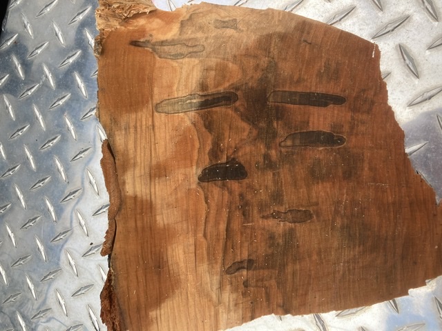

Guy I work with called and said hey, the city cut this tree down... I saw something worth saving. Another co-worker wanted some so dropped two pieces off for him. We shall see.

I started reducing the height of an ash stump that's been aging for about 3 years now and found some interesting chunks that might have interesting results. Not sure if I should just leave them outside to dry more or some other treatment. I know if I bring them right inside they will dry too fast and crack.
That's the white looking stuff you see on the pieces. I am sealing the cut ends to slow drying and minimize cracking. I have used Elmers Rot Restorer (which looks like white glue to me), old bottles of Titebond that are getting thick or crusty, latex paint (though I can't see the grain after painting). For most species of works. Some may still crack or pop anyway but I feel it is less than otherwise.
