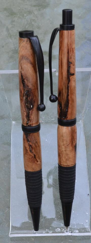

The wood (and the knot) look very similar to Cherry that I received from my father who happened to live in Fort Wayne (North East Indiana).
I love knots in pens, I think they give soo much character.
