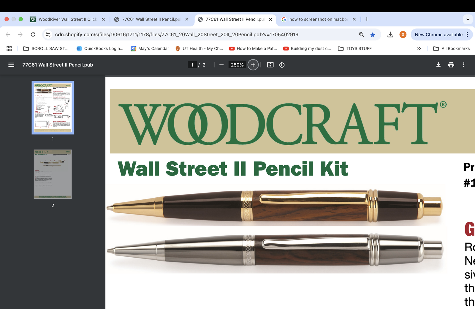

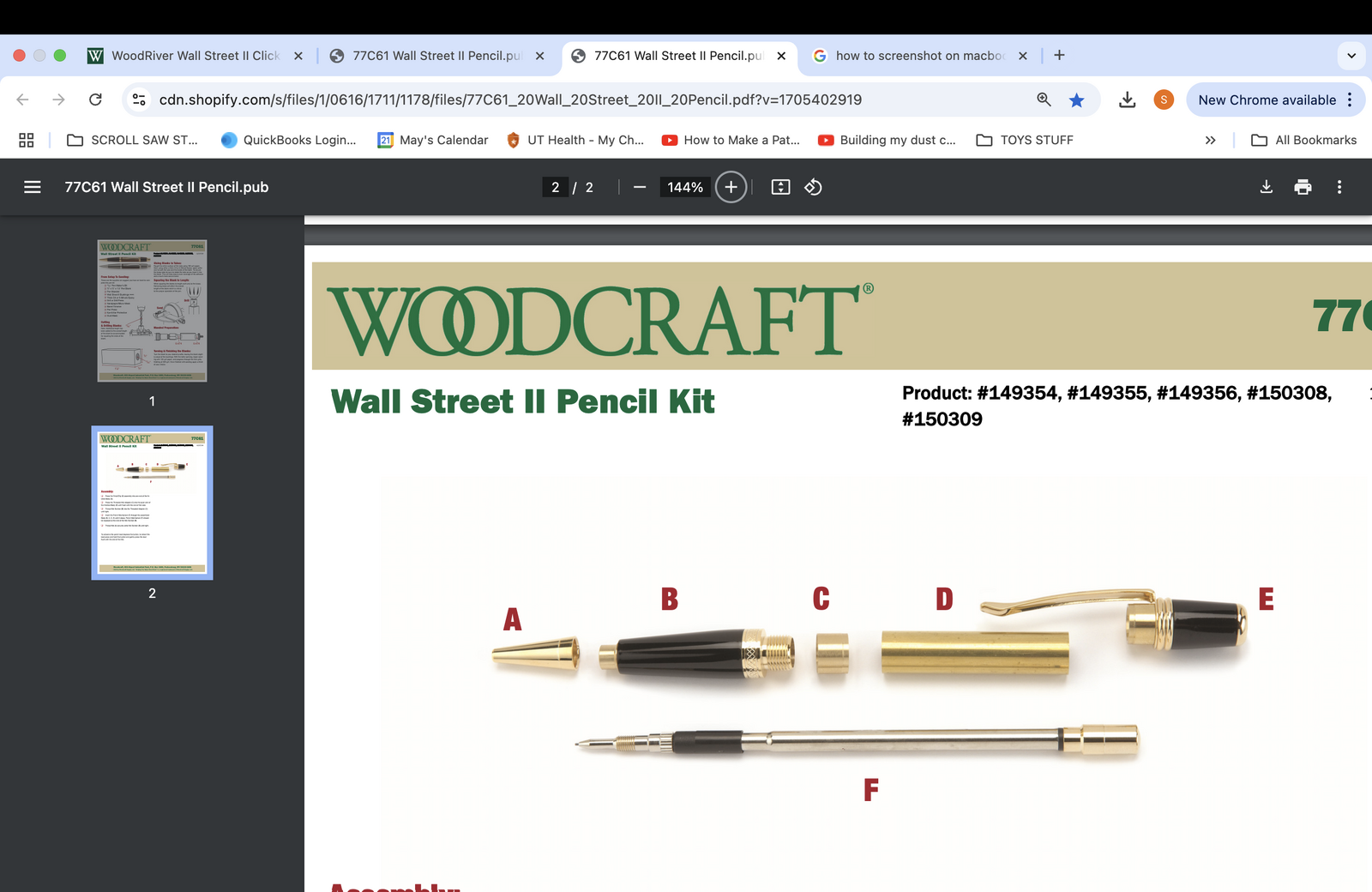

I have more questions about kits, bushings, tubes and refills. I have several old pen/pencil kits and most of them have missing parts. I hope you can help. Please look at the attached pictures. At this time I have a couple of the kits in the pictures and am looking for:
Rockler's version of Bushing #146597 & the pencil mechanism.

Sammy; There are **MANY** versions and variants of the Sierra pen and pencil kits. Some are interchangeable and some are not. The Woodcraft "Wall St II" is a standard Sierra kit.
Measure the tube diameter and length and search for a match on the Tubes n' Bushings app if all the measurements are very close to what you measure. It is likely that the parts are interchangeable. This is NOT guaranteed, but likely true.
Look at the instructions for your kits. Archive.org has the "Wayback machine" (anyone get the reference??) is an internet archive that can retrieve web pages that have been deleted or no longer available. You can point at a particular website / date and see the files there. Also if this helps you, be sure to send a few dollars their way.
