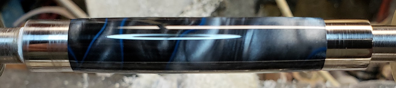

I'm having an issue!!! I took some blanks and wanted to see how different they each looked, having a painted tube in different colors. I painted one half in white and one half in black. I painted both the tubes and the hole drilled through the blank, as I was told the glue will show if you only paint the tubes. Why do the ones I painted white look like this?
Should I somehow sand the drilled hole? If so, how?
I've tried also putting Thin CA in the drilled hole prior to painting to try and fill those small scratches left behind.
Please tell me what I'm missing and doing wrong. 🙏

David welcome to the site. First can I ask why you are choosing those clear type blanks? Especially if you are just painting with white. Anyway those blanks will show every scratch and defect such as paint scapings when sliding tubes in. If you want to continue to use them then you will need to perfect your polishing skills because you will need to polish the inside of those type blanks. First you will need to sand the scratches you get when drilling and then progressively raise the grit level as you go. You may have to take it up to the 1200 grit to get a smooth finish. Then you need to use a spray paint because any brushing will leave shadow lines and or ridges. Forget the painting of the tubes. That will do nothing more if you can get a good finish on the inside of the blank. I suggest not using CA to glue tubes in and switch to a epoxy and tint the epoxy if you like. You need to let the paint dry and cure before gluing. You do not tell us all your steps such as glue used, paint being used, or if you sanded the blank smooth before painting. To me there are far tooo many other blanks that can do the same look that are more opaque. Those blanks make nice kitless pens. Good luck. I am sure other will chime in with more suggestions.
One other thing for sanding, just wrap sandpaper around a dowel that closely fits the size of the hole drilled.

To join the thread; From the "pattern" (bumpy) it looks like the glue, or paint, or material reacted with each other. A drilled tube should not have that pattern. I use a standard rattle can to spray the inside of the tube and thick CA glue. I get even coverage of the CA. Since I note the drill size on the instruction sheet I keep for each pen style, don't have any problem with paint scraping off the inside.

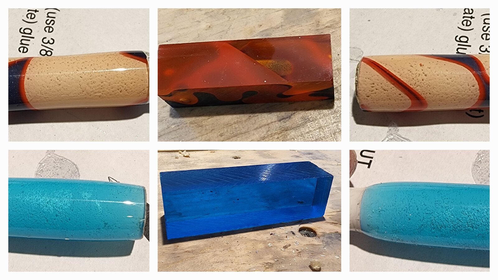

They paint glass so yes it will stick. Now of course you can get into specific paints made for glass which maybe of help but you can experiment with simple acrylics. Testors enamels and acrylics work well. Your other questions is like asking how long does paint dry. :) Sand till you see the old scratch marks removed from previous grits and work your way up. It is a small blank and wrapping paper around a dowel takes little time. Hook to a drill motor and goes faster. Whatever you do, do not leave any polish on blank or paint will not stick and just react with it and cause crazing. Remember this when working with blanks and painting tubes and inside blanks. The adhesion is only as good as the adhesive. Now when you paint the blank only you have 2 glue parts. One, the paint to the blank, and 2 the tube to the paint. If you paint the blank and the tube, now you have 3 points of adhesion you have to be concerned about and why I never paint both tube and blank and always just paint blank. You have adhesion of paint to blank, adhesion of paint to tube, and also now painted tube to painted blank. Plus the adhesive needs to be compatible to all.
Getting the inside of the blank is crucial before you sand the outside or you can drive yourself crazy trying to get scratch marks out and not knowing weather inside or outside. Again I would not use those type blanks for what you are doing. There are many examples here of people using those type blanks for kitless pens because they use no tubes. They then actually go through a polish regime to even clean them up more. When those blanks are turned down to the thin diameters we use they are like being clear anyway. very little tint is left. They do have translucent blanks that are abit heavier in color but the same effect you are after can be achieved. Good luck.

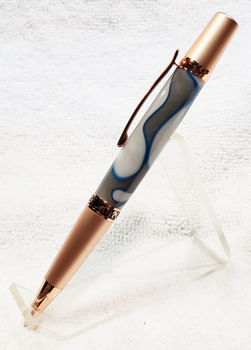

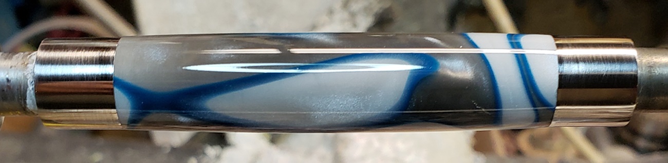

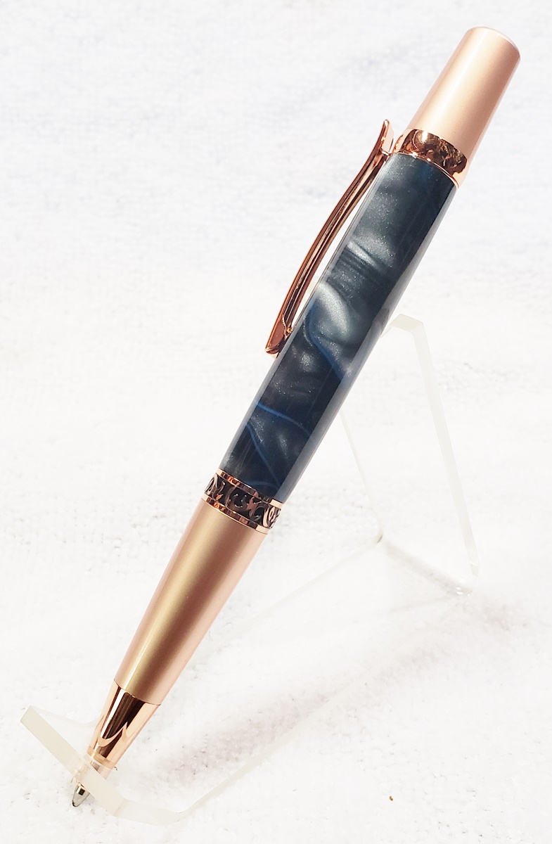

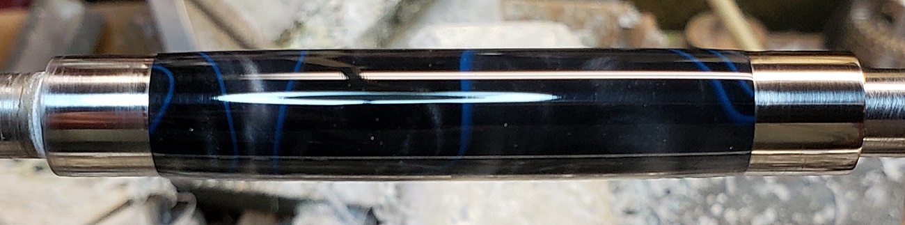

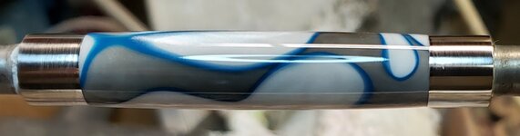

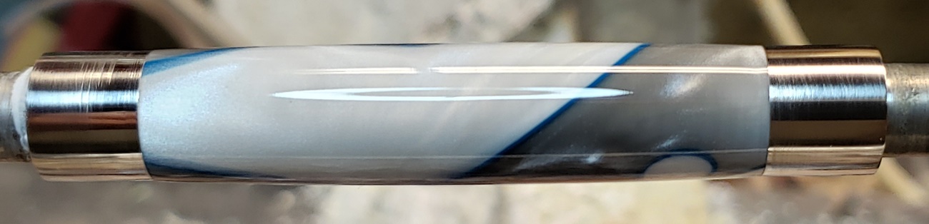

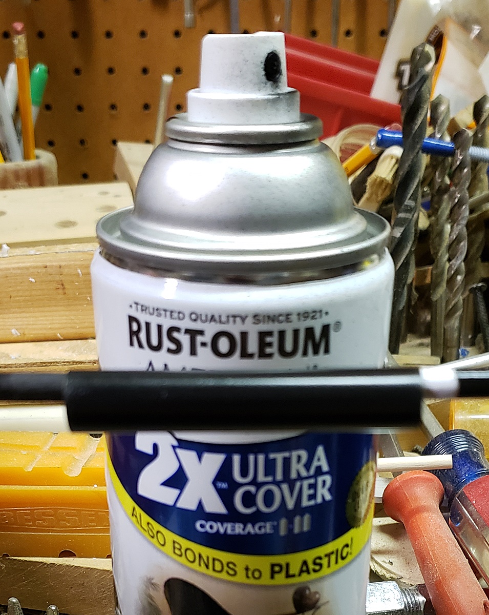

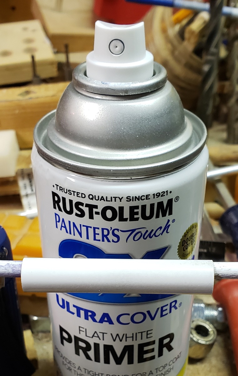

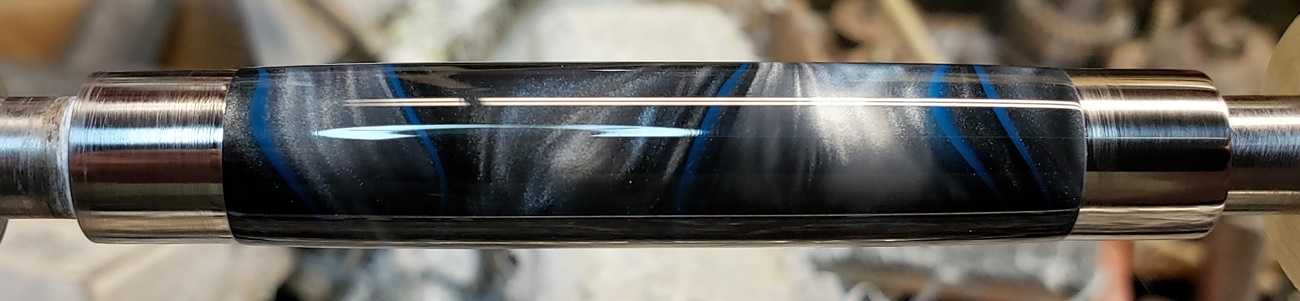

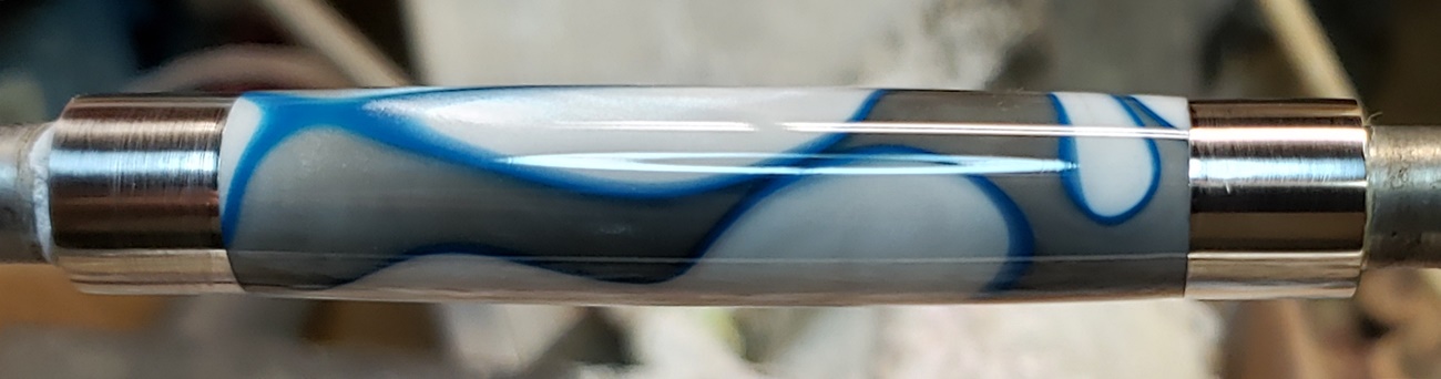

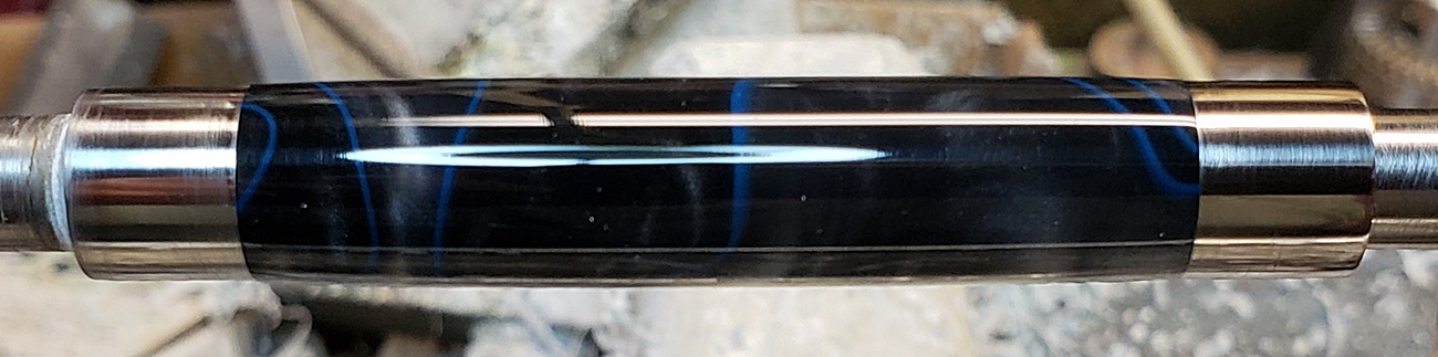

I haven't had good luck with very translucent blanks, so I refuse to turn them. I don't mind semi-translucent, though, and you can dramatically change the look by painting different colors. This is an experiment I did a while back. Two halves of the same blank. I painted one black and the other white. They don't even look like the same blank. I painted the holes and the tubes, and colored the epoxy.
