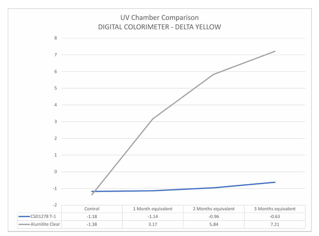

  • MUCH Better UV Resistance than leading brand Urethane resin
  • Better color separation (You can pour at 85F and still get excellent separation)
Your castings will stay clear or retain their original color longer, without having to pay a premium for the better performance.
