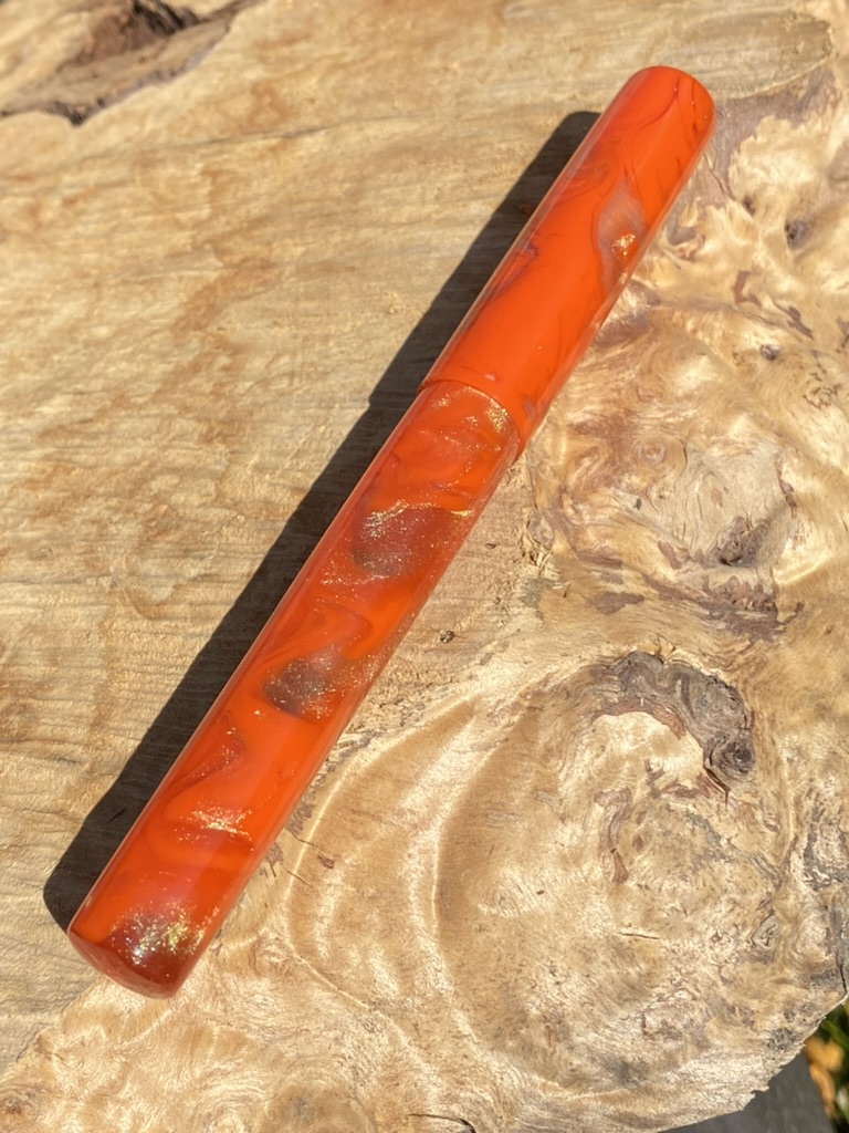

Hello Everyone,
I am relatively new to the IAP community and began posting/interacting only recently.
I started turning kit pens in November 2021 and began my journey with kitless in September (2023).
This is my first kitless pen and it was completed in October.
As I begin to share my work and ask for feedback, I thought that I would start at the beginning, so here we go...
  • Alumilite blank from JakobJanssenStudios (Etsy)
  • 143mm total length
  • 133mm uncapped
  • 15.5mm cap, 14.4mm barrel
  • Jowo #6 nib
Comments and feedback are welcome.

You my friend, are well on your way. Super job, very cool blank.

You did a great job, well executed, now it's just repeating the process.
You really did a superb first pen!
You only used one blank, which is much better than I've done yet. I've got an increasing pile of mistakes and start-overs from over cutting the tenon, length too short, poor threading , etc.
I'd encourage you to add more figure to your section on the next one if you want to. There's actually more meat on the bone than appears if you want to remove some of it to make the pen more comfortable to write with you can.
Great job!

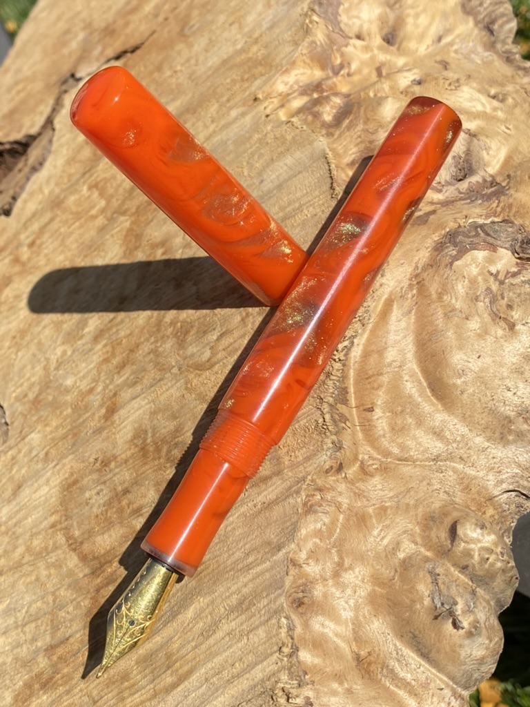

I have completed a few more which I will post in the coming days or weeks and I have put a bit more shape on the section. #2 didn't go quite as smoothly when the part I saved for the section failed. There were some small bubbles in the casting where I was threading the tenon and it cracked badly, so I ended up making one out of black ebonite. I'll share that one soon.

That's a great looking pen, especially for a first one. I do have a question though: Is that a triple start or single start? I'm probably wrong, but it looks like triple start. Is there a reason you chose one over the other? I know there have been lots of discussion about the advantages/disadvantages of both.
Thanks Lew!
You are correct, it is an M13x.8 triple start. I chose it because it reduces the number of turns to cap and uncap the pen. This pen is still 3 turns to cap/uncap, but that is maker error, I made the tenon too long. I either needed a shorter tenon, or needed to drill some of the threads out of the cap.
