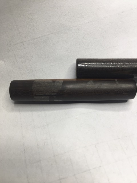

modelcarsmag
Jul 31, 2018
1
Hawaii
This thread (I know it's old, sorry) came up on a Google search. Is this the fogging problem you guys are talking about? It just started happening to me. I did switch to the BLO way of doing the CA, and that is probably the problem. Ironwood Blank.
Thoughts?
jttheclockman
Feb 22, 2005
19,148
NJ, USA.
Thoughts?
Welcome to the site. I did not go back through this thread and can not answer your original question. But from your photo it looks like you do not have enough CA on that blank at all. That wood you are using is an oily wood to begin with and I never liked using an oil such as blo with a wood that is already oily and trying to finish with a top coat of any kind. Too many bad things happen. I wipe the blank down with acetone and when that drys I apply 3 coats of thin CA to seal the wood. Then apply 4 to 5 coats of med CA and polish from there. I won't go into methods of applying, CA used and all that because everyone does things differently. But to the root of your problem, I would avoid the blo.
