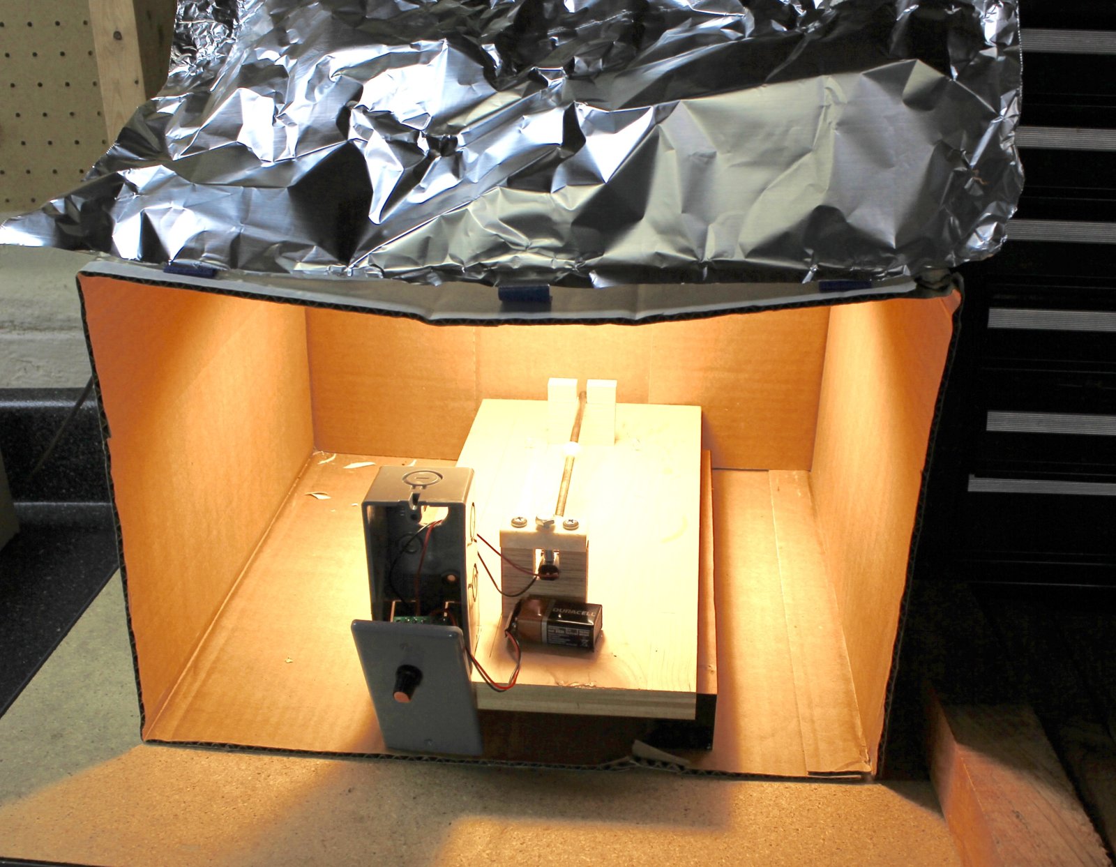

I will freely admit to previously having issues with CA finishes. That is my weakest element in penturning. I have been very happy with GluBoost. I typically do 3+3 coats, then wait overnight to do the final micromesh series and McGuires Plastic Polish. Some woods I prefer a more "wood" feel, so just use 1-2 coats less; others I want a solid finish so use 1-2 coats more. The accelerator is needed. And IMO waiting overnight the finish is more cured and harder and takes a better shine.

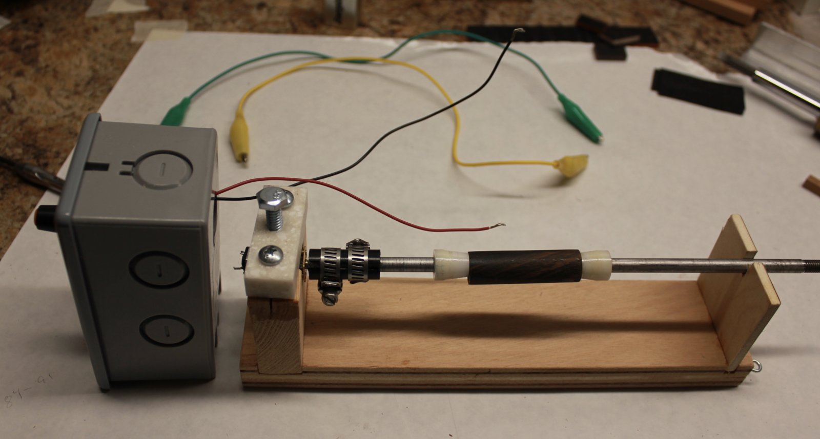

This is my simple light box and the slow speed spinner. Bruce Robbins shared with me the construction of the spinner (cost less than $10.00; vs the one PSI sells for much more).
