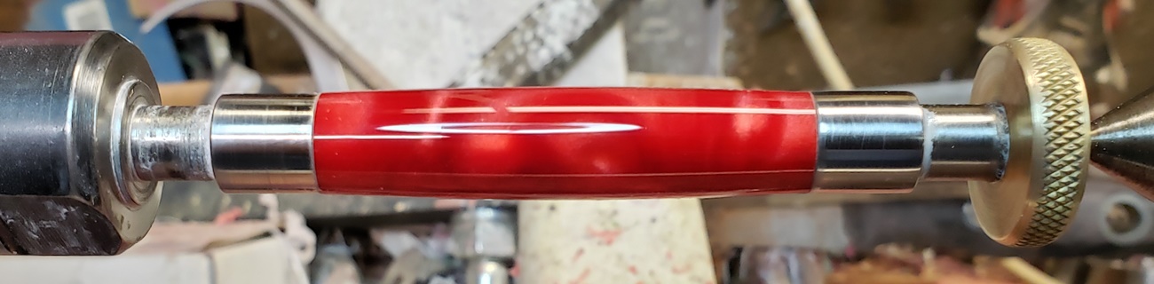

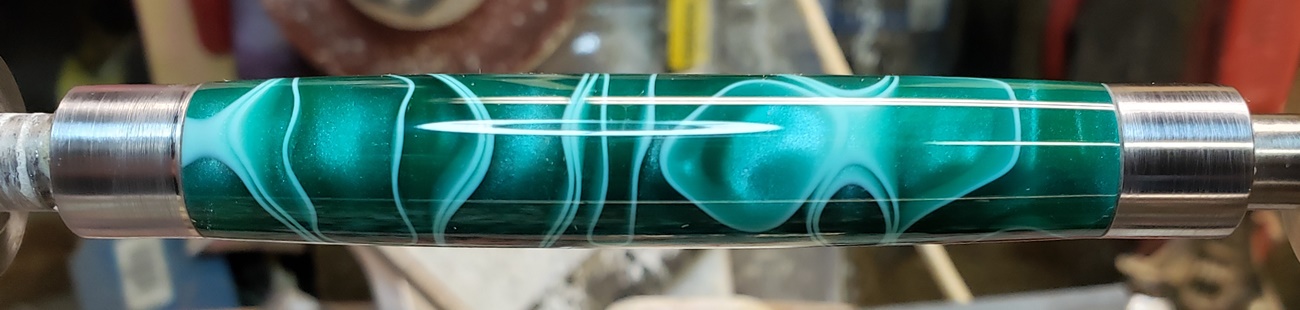

I used to use Novus, but found Meguiar's PlastX gives me the same results in one step.
