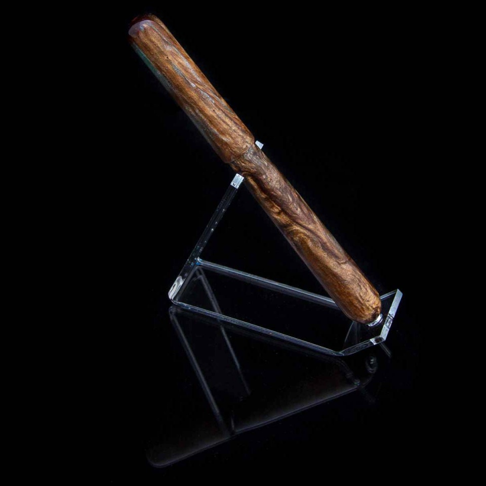

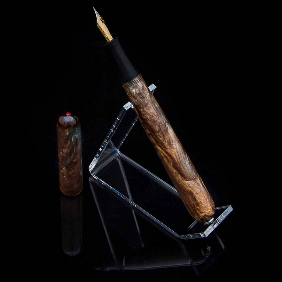

Well, it's my first if I don't count a few aborts trying to figure out the process.. :smile:
Body is a alumilite water clear with Mica powder swirled in and cast in a PVC tube. Section is Delrin. I filled the divots from turning between centers on each end with red epoxy. Nib is a #5 Jowo from Meisternib. Finish was just running through micromesh pads, then Novus #2 and #1. I don't carry in a shirt pocket, so left out the clip.
It's been my daily carry for a couple of weeks now, and I really like it.
