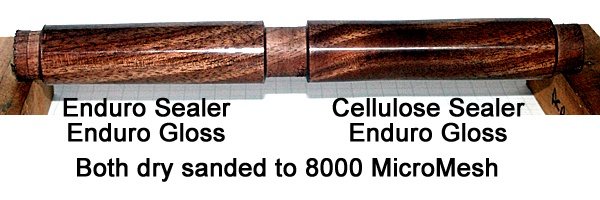

Ok, went out and finish sanded my Enduro test this morning...
I want the thank ObiWan Wayne for his insite on this finish and his time on the phone answering my dumb questions..;)
I turned a piece of fairly plain walnut that I had and sanded it to 1200 grit. I did not fill the pores or use BLO as I usually would with walnut. I wanted to see what the finish would do as is.. I usually do not like most walnut for pens as I find it plain looking... I use a lot of it for scroll saw work, however.
After sanding and removing the sanding dust with some DNA, I put 3 thick coats of Enduro Sealer on one side and the same amount of Cellulose Sanding sealer on the other... I let them dry overnight and dry sanded to 8000 MicroMesh (Wayne suggests 12000, but I could not find my 12000 piece [:p]). I then applied the same amount of Enduro Gloss Poly to both sides and let dry overnight and sanded as I did the sealers. The pic below shows the results.. The side with the Enduro sealer has a brighter and clearer finish than the side with the Cellulose sealer, but I would not throw out either finish.. If anything the side with the cellulose might be just a tad bit less glossy, and that could probably be fixed if I had sanded to 12000 MM.
All in all, I would say that the side with all Enduro has a magnifying effect that the other does not... I think I might attribute this to the fact that cellulose sealer is not as clear as the enduro.
I did a fingernail dent test on both sides and could dent the finish, with some effort... but then again any poly or lacquer finish needs to cure. I would not wait to assemble this if it were a pen blank.. but I would wait a couple of more days before adding it to stock or selling it.
This is a finish that is definately going to be added to my arsenal.

Tom, great comparison and thanks for posting the results. I have received my order of Enduro and am working to try it out. I hope my results are the same (if not better[:p]).

[:D] Thanks Tom!!! That is a good report!
I ordered the 'introductory' kit last Friday, I think I made the right move.
How did you apply the gloss coat? Spinning? Brush? Spray?
When you sanded to 8000, anything else? TSW? REN?
Thanks!

It was applied with a Viva paper towel with the lathe at the slowest speed. On the test, nothing was put on as an overcoat, but I would probably do a coat of Ren wax as a protectant from fingerprints... if you do decide to use TSW make sure you wait an additional day or two to let the poly cure more.. TSW has some poly in it and may soften into the Enduro. Or at least that is what ObiWayne said.. [:p]

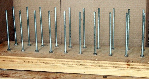

I use a rack (see pic) for my blanks when I do a production run... I will be using the same rack for my Enduro finish... that way I don't need to tie up mandrels and bushings while the finish is curing.

I'm a cheapskate. I made my racks with wooden dowels. For Enduro drying, I have one rack for sanding sealer and one for the poly since I tend to forget which pen has what one it! [:I]

GEEZ Guys, how cheap can you be... I think I have about $3.00 invested in that rack... all in the hardware... the wood was shop scrap....

How cheap? Wood that was given to me for a base, less than a dollar for the dowell, and I drove the pieces of dowell into the holes I drilled to save that expensive glue! [:D]
