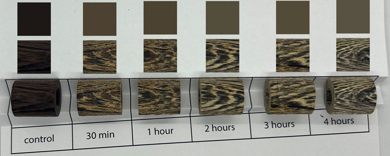

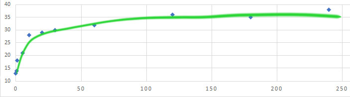

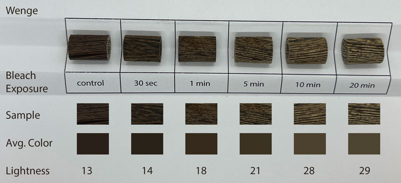

I placed wenge in bleach for different amounts of time to see how quickly it would lighten.
My results indicate I can get away with as little as 10 minutes for pretty good results.
Avg Color obtained using "Photoshop->Blur->Average" filter. Lightness determined using CIELab color space.
x-axis indicated minutes exposure. Results flattened out quickly; especially beyond 2 hours.

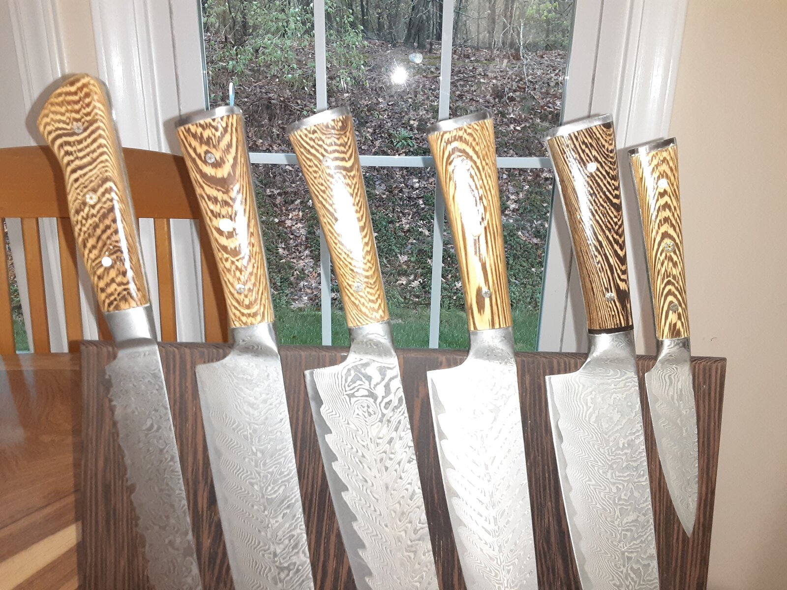

I sort of accidentally ran into the one -vs- two applications. I made one knife handle, with one bleaching, second from right. Then I made a set, and the bleaching came out blotchy, so I did a second application. Both were whatever the bleach recommended (10 minutes?). I found the double bleaching to be significantly lighter. The knives are held to the stand magnetically, and the stand is wenge with one or two coats of oil. The handles finished with General Finishes waterbased poly.
