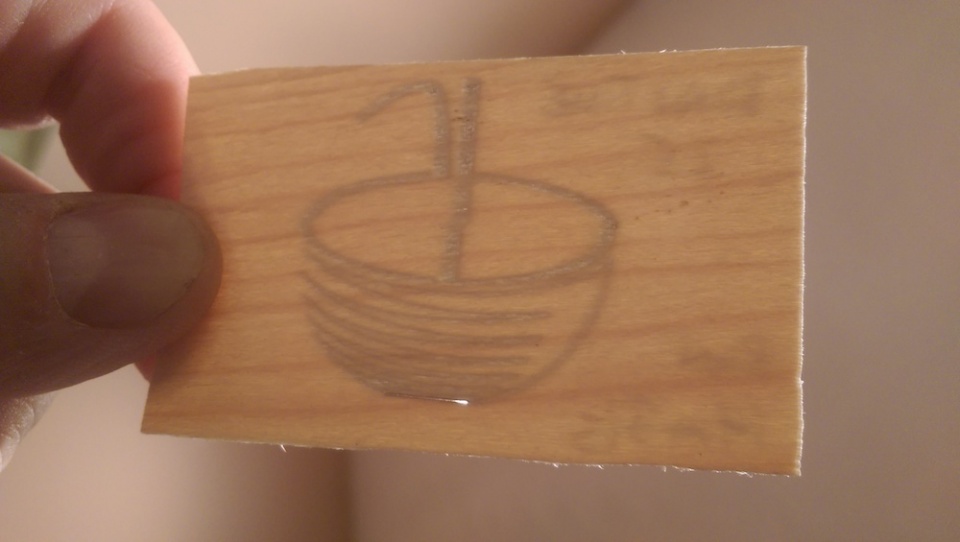

Do you think it would cut veneer?
I'm sure that it will.
Attached photo shows it burned through this maple veneer in a couple of places -- with the burn time set to 25. (This is the back side of the veneer.)

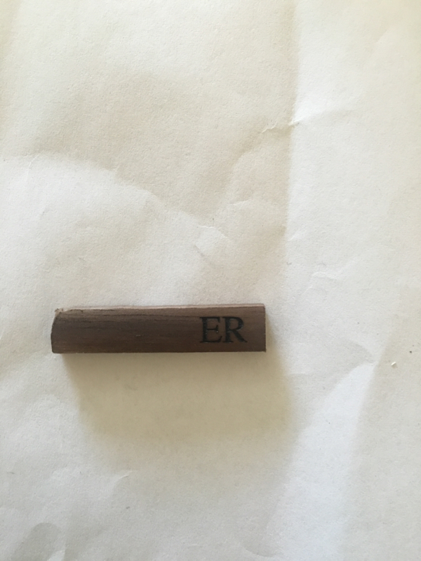

Just did a burn on one of the red stained wooden pen boxes for my Niece's graduation. I'm sorry I didn't get a pic--finished it just as we were leaving for her party. I used Harlow Solid Italic in MS Paint at a size 48 font (three lines of text as large as I could make them). It really came out extremely nice. I did a test burn on the white outer cardboard sleeve to check focus as it's at about the same distance as the actual box. I used a burn time of 50 as I thought the red stain might affect it.

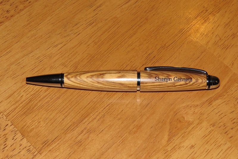

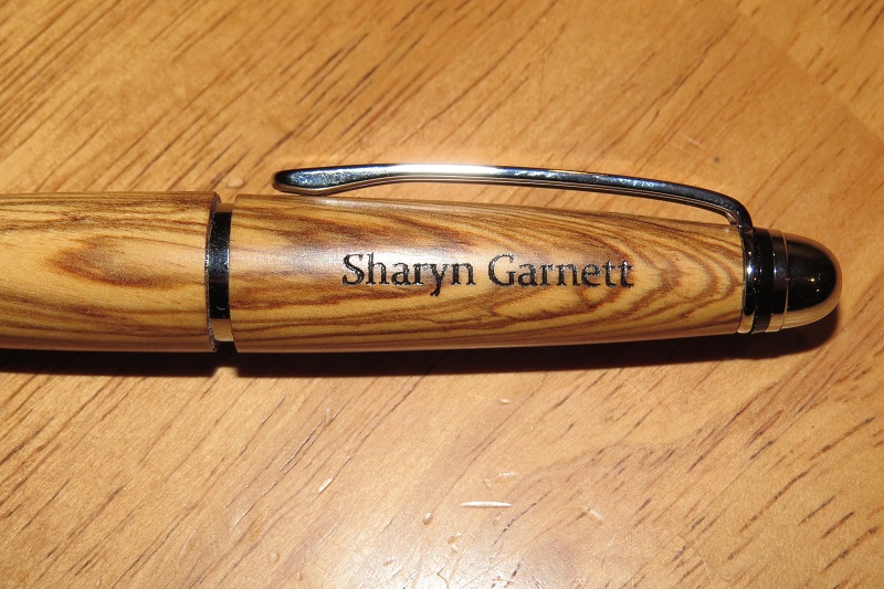

I've been playing with burn depth on the little NEJE, and since I don't fill my engravings on wood pens, I'm liking the burn setting of 75 to produce a nice depth on the engraving. This is recent Curvado in Olive that I made as a gift for a retiring coworker. Thanks for looking.
And thanks again to Michael (the OP) for bringing this little gem to my attention. :)

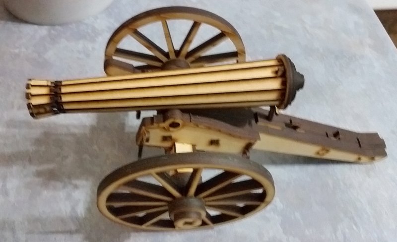

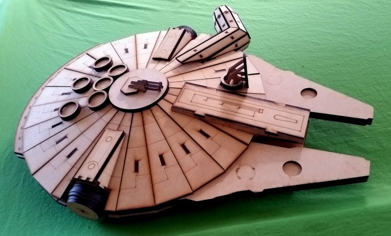

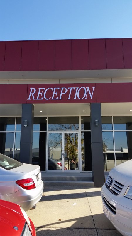

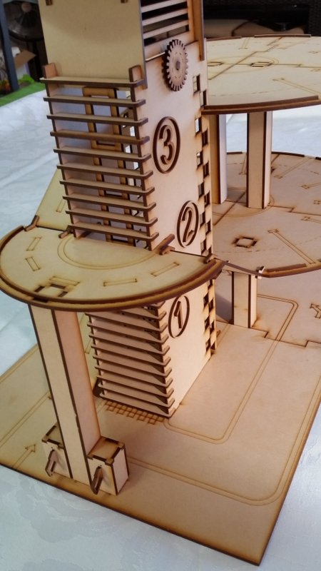

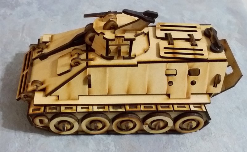

A mate of mine has a small unit he was using for his pens (excellent).
Giving up pens now bought a larger machine both direct from China his sales returns are four fold plus than from his pens. A few samples I got from him today.
Plus a couple of signs he cut from plastic.
Peter.

Nice crisp lettering. Looks like someone's got their machine settings dialed in. Is there much of an adjustment between softer and harder woods with these units?

Bill, you're welcome! BTW, what font did you use? That looks very nice.
Pretty much the only adjustment is the time setting. The higher up the you go, the longer the laser spends burning each pixel. If unsure, one can always do test burns on the square blank before turning (though you'll have to re-focus when it comes time to burn on the finished blank).
