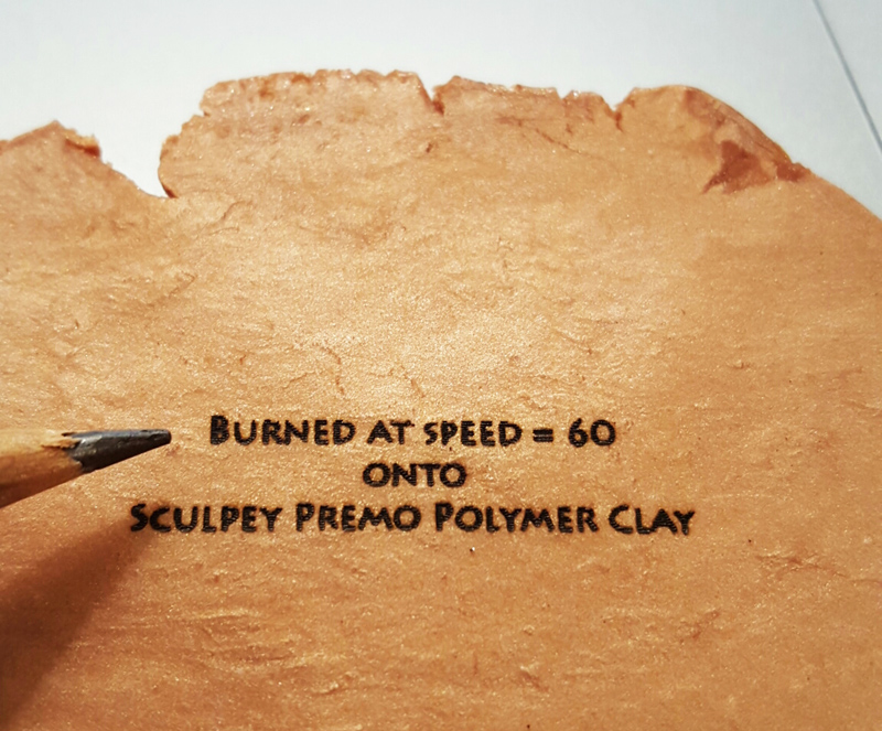

Clean Burn onto Polymer Clay
Nice clean burn onto (heat cured) copper metallic color Sculpey Premo polymer clay, rolled in a pasta roller to 3/64" thickness - opens up some nice possibilities.
I haven't tried uncured poly clay yet - but will (soon).
I burned this outside (noxious fumes):
attachment.php
- Bob
[size=+1]DO NOT LASER ENGRAVE POLYMER CLAY![/size]
Polymer clay is composed of polyvinyl chloride (PVC) which is one of the materials one should never laser engrave. It releases corrosive and potentially toxic gasses, including hydrogen chloride. They can etch your laser's lens, rust the metal parts, and burn your lungs.
Avoid PVC!
Sincerely,
Eric
I agree. Always look into the makeup of what you are applying the laser to. There are several big NO GO materials that release toxic gasses that can be lethal.
PVC or anything that contains chloride is a huge red flag.
Thanks, Eric and Carl - your thoughts are well taken and appreciated.
As noted, I burned it outside (and was not nearby).
I also cure my thin-rolled PVC in a toaster over (275 degrees, 7 min, depending on thickness) outside.
I certainly agree that closed space - and even well-ventilated spaces working with PVC and an array of other materials can be hazardous.
I'm grateful to hear that PVC-engraving can damage the engraver lens - did not know about that.
Best regards, and thanks again, Bob
