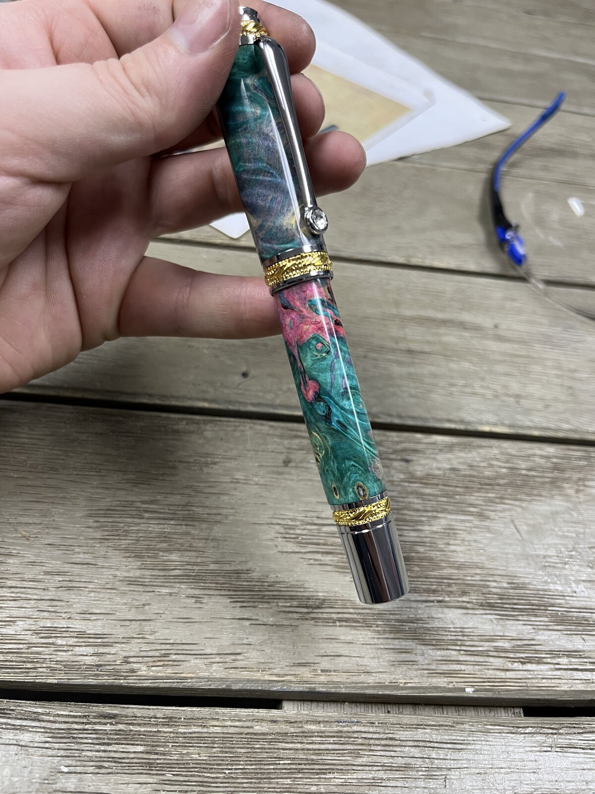

I use both kinds of Yorkshire grit in order on CA when I want a perfect, smooth finish. I used it on this majestic last week, and there isn't a scratch or scuff to be seen. Also blank from @Benpen
