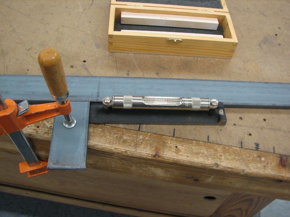

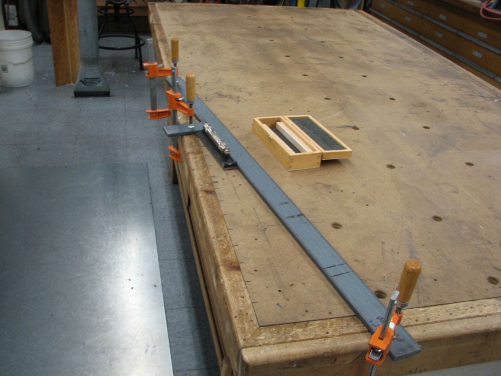

Here is my typical set-up for calibrating my level...
I find the level spot and block it off.

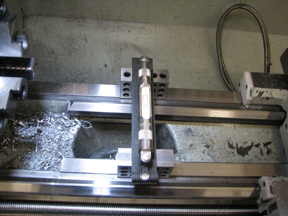

Here's how you measure for twist...
If you look real hard you can see the shim under the 1-2-3 block nearest you, I use it to get the bubble in between the lines so I have a reference point. I take note of where the bubble is and move the whole set-up to the other end. This is where you either adjust your leveling feet or use shims to raise one end.

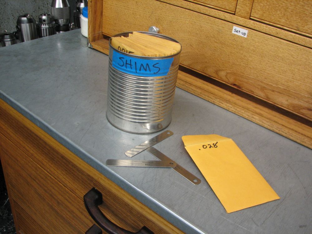

If I need shims to put under one end of the lathe I use regular shim stock and cut off a piece. For temporary shims like the one under the 1-2-3 block I use feeler gages, I bought several cheap sets on Ebay, disassembled them and sorted them into individual envelopes. HANDY!!
