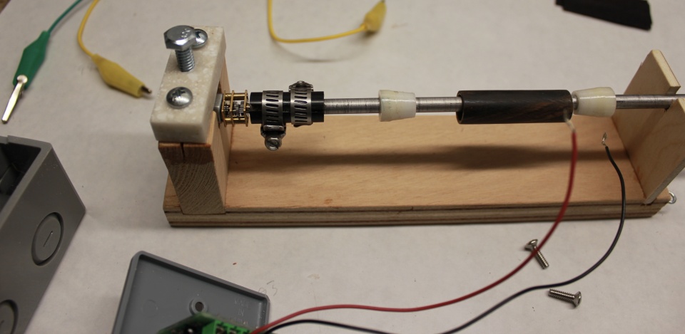

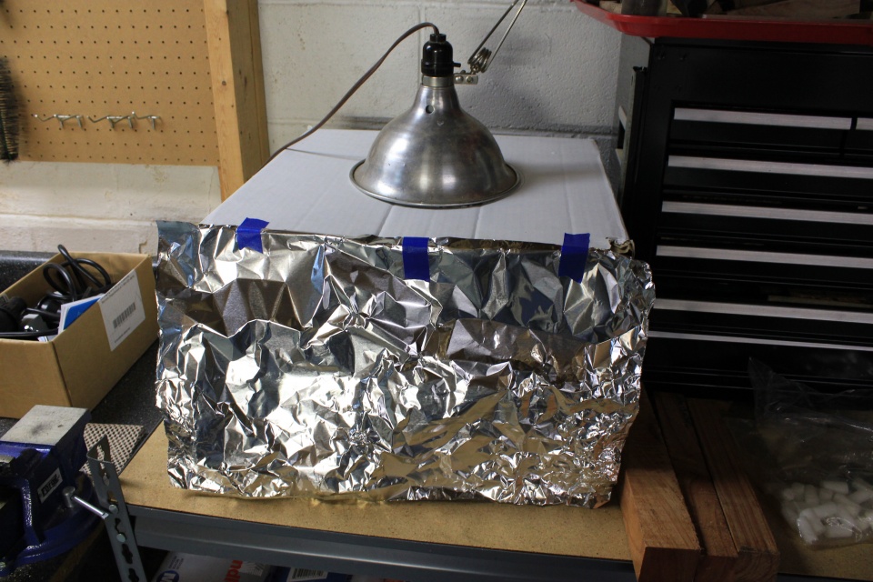

On the recommendation/supplies I received from Bruce Robbins, I have the past year used a slow speed drying system in a cardboard box under a heat lamp. This has speeded up the cure time so I can reapply closer to a 2 hr wait. Humidity will also be a factor. This is with WOP.
Parts off of ebay - about $10.00 total.

The photo Mark attached triggered a thought - - -
A WOP finish is generally built up using many thin coats. Another option is to use fewer coats, but where the individual coats are thicker. This approach is sometimes referred to as 'rotisserie' finishing. The basic procedure is to use a brush to apply a thick coat of full-strength polyurethane. The problem with applying a thick coat is the tendency for the finish to run. To counter that tendency, the piece must be rotated continuously, both while applying the finish, and for upwards of a hour after applying it. The vibration from continuously rotating the piece causes the finish to self-level, and after about an hour, it is pretty much set and you can stop the rotation. You do need to wait longer between applications - a thicker coat takes longer to cure. People who use this approach often wait as mush as 24 hours between coats, and to assure that the application is even, sand lightly between coats. But with this approach, you can build up a very thick coat of finish that will buff to a glass-like shine with about four applications.
Pepper mill turners often use rotisserie finishing, but there is no reason it couldn't be done with pens. Obviously, you need a means to rotate the pen for finishing - if your lathe can operate down in the 50-75 r/min range, you can just leave it on the lathe for finishing and that initial hour of curing. The downside is that this is an inefficient use of your lathe - having some kind of auxiliary rotating scheme frees up your lathe to turn the next pen while the last one is curing.

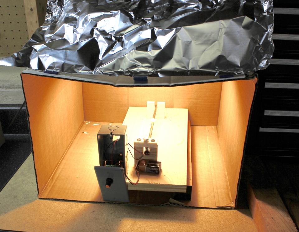

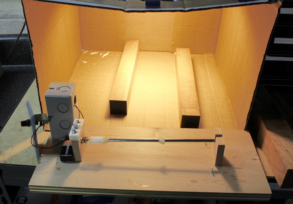

I do exactly as Louie mentioned; after 45-60 minutes I turn the "rotisserie" off and let it sit in the warm box (certainly not hot, but you can feel some warmth on the mandrel). The second coat is usually at 2 hrs - If I don't forget it :smile:.
