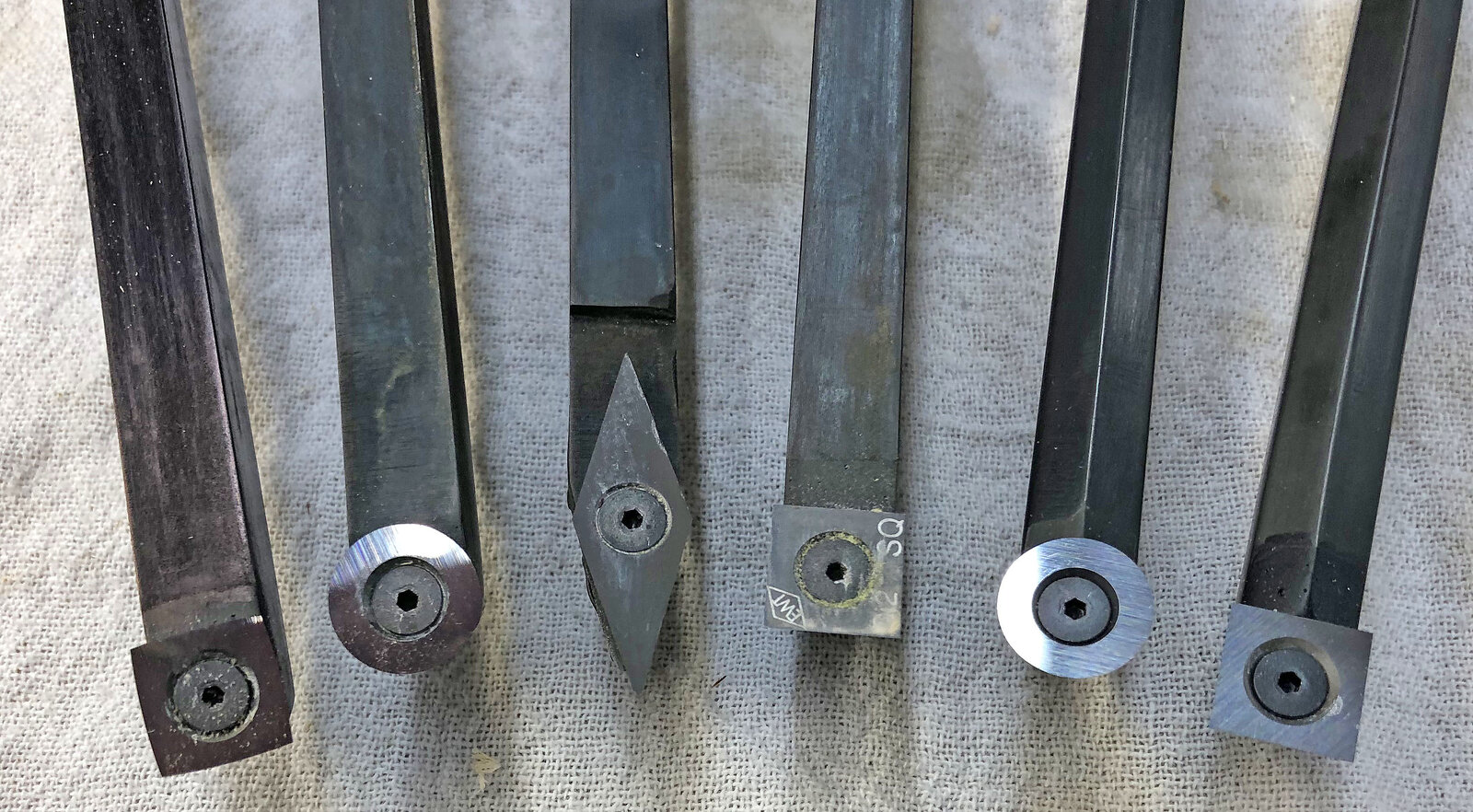

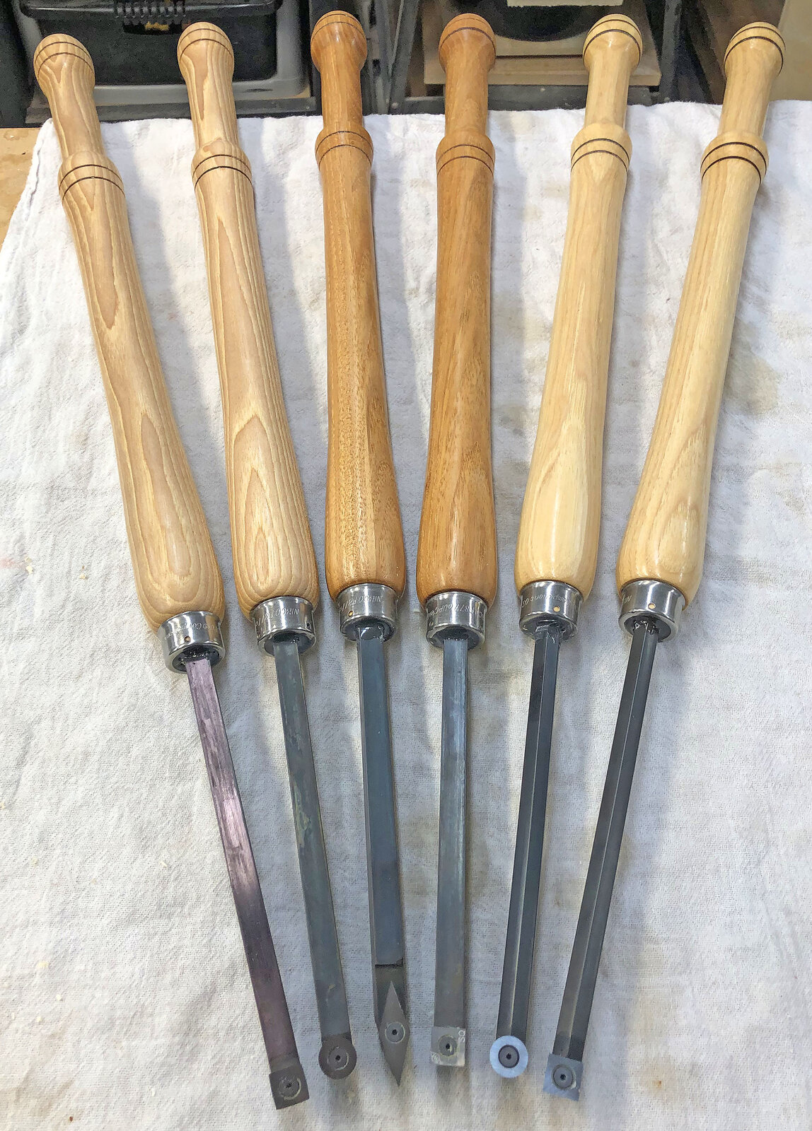

PS Here are a few pictures of my tools made with hickory handles and 3/8" square steel bars (except for two made from a 3/8" hex rods that present the cutters at an angle to the work - similar to how the Magical Skew designed by by T. Shadow & Company (Magicbob). They are the two tools on the right side in the following thumbnails).
The two tools on the left are the "negative rake" type tools.

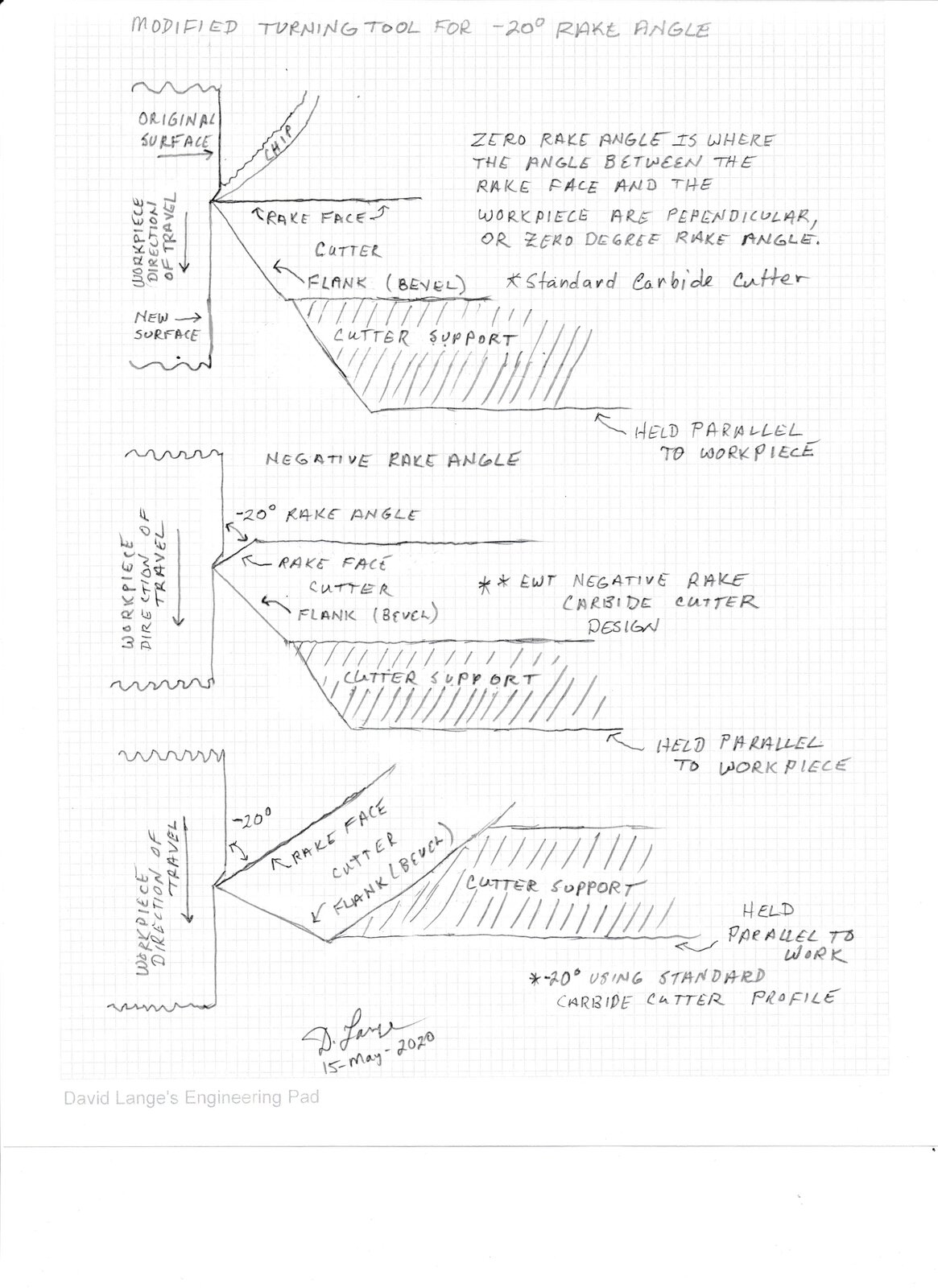

And here are the notes related to how I modified my tool design to use standard cutters that present with a negative rake angle.

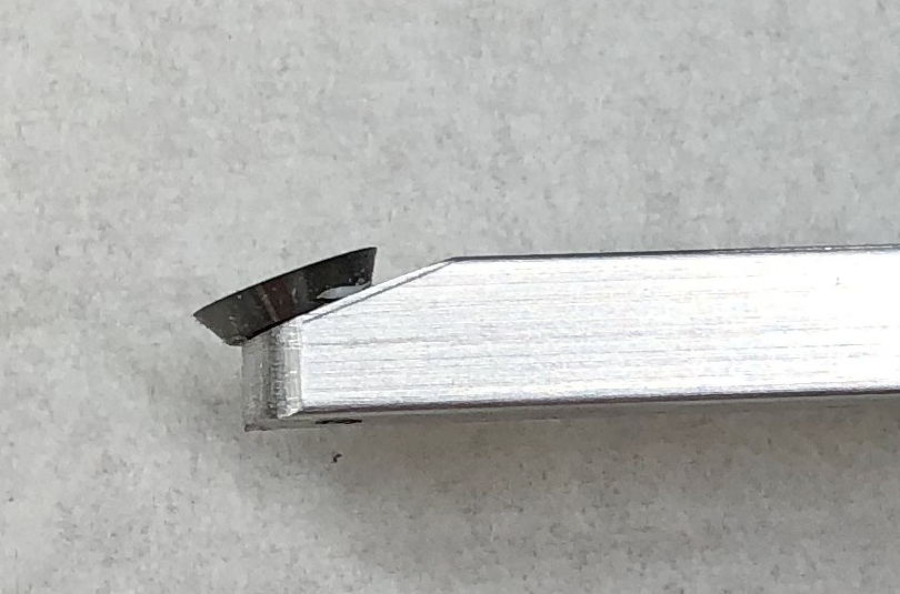

Gregory; I have made my own carbide tools using hex shafts. The hex shaft has limited use for spindles. I use them for bowls and larger work. AND to answer your next ?? Yes, those are golf club grips!
https://www.penturners.org/media/carbide-tipped-turning-tools.16987/

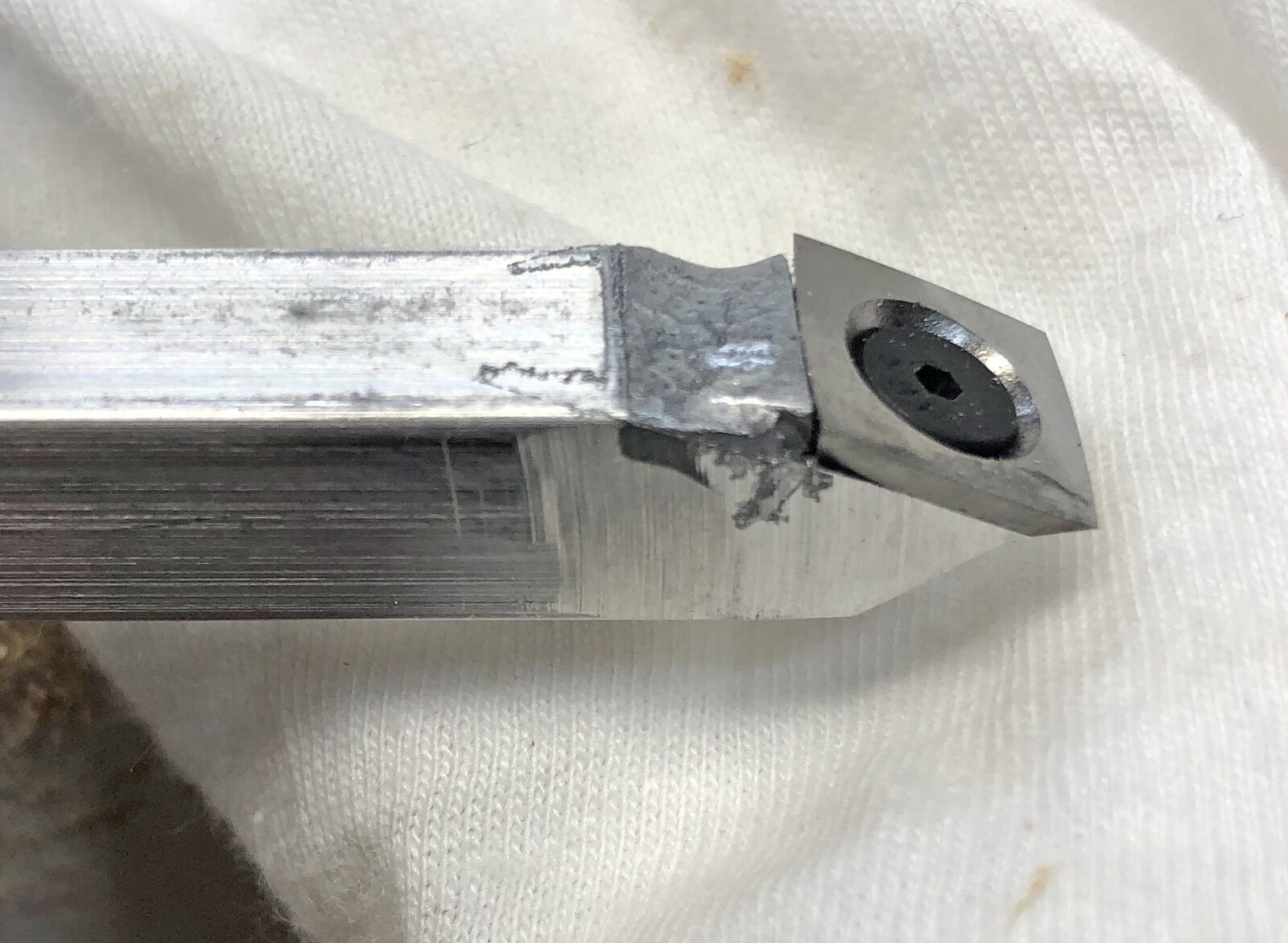

They are dirt cheap to make yourself. A length of square steel bar. Drill a hole, tap, file the tip. Turn a pretty wooden handle on your woodworking lathe and epoxy the steel bar into it. Screw on a cheap carbide insert. Bob's your uncle. $12 and an hour of fun in the workshop. Even less time per tool if you do 4 holders at a time.
When I see $100 bucks for a handled steel rod I admire the marketing dept's boldness. Make sure you get the 4-tools-for-$300 bargain;)
View attachment 378337 View attachment 378336
View attachment 378333 View attachment 378334
Why the "weld ?" behind the tip on the first photo?
Was it just to give positive tip location and repeatability of position?
Intriguing idea , not yet gone down the carbide rabbit hole ( apart from for deep hollowing that is )
You are spot on - what you are seeing is a blob of JB Weld epoxy that I put on it to help keep the carbide from rotating when I tighten down the screw. If I was a better machinist I would have made some kind of profile in the tool shaft itself, but for my purposes, the JB weld works OK and it was simple enough to apply. The weld became less pronounced after I applied gun bluing to the shafts.
Dave
