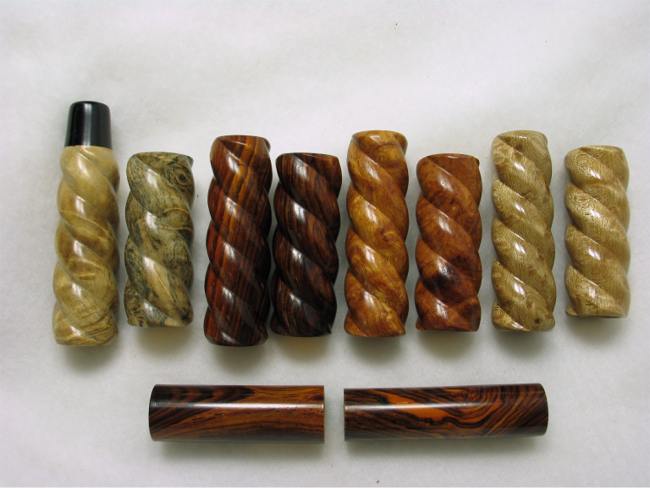

Sam, here is a sample of Waterlox, These have three coats, then buffed.
Stabalized buckeye burl, no finish, just sand & buff, Cocobollo & amboyna have the Waterlox, birdseye maple lacquer,cocobollo on bottom CA.
<br />
If you want a softer finish, don't buff. still has a nice shine without the high gloss & plastic feel & look.
