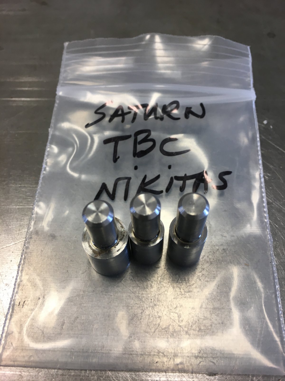

Two words - Brian Nikitas. He can make your turning wishes into reality. Yes it costs money to get great repeatable results, but you will almost never turn with a mandrel again. I only use a mandrel to apply CA finish.

Each set of his bushings runs about $18 and is well worth that cost. My bushings that fit on a mandrel are very lonely and will stay that way.

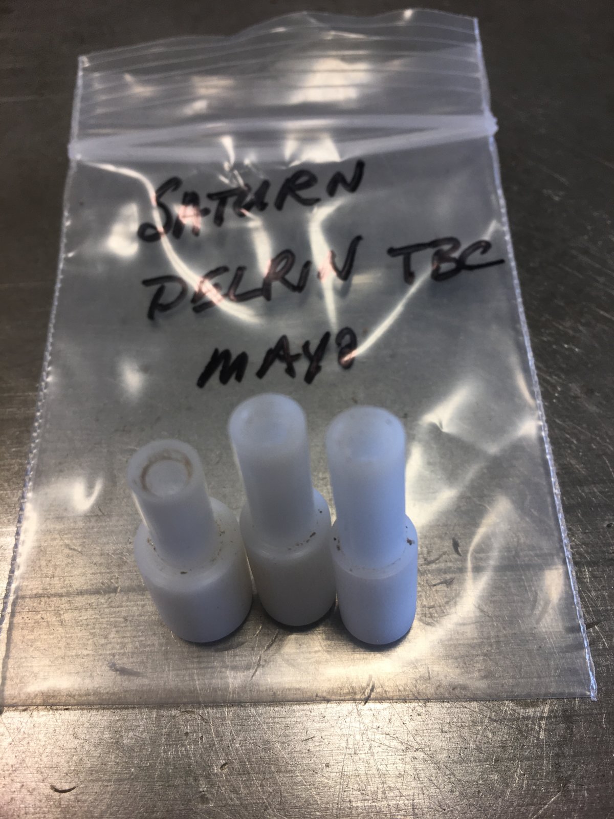

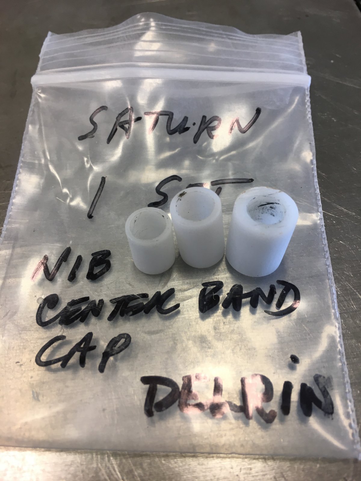

My appreciation of TBC bushings has led me to turn my own Delrin TBC bushings for each pen style I make. I use them for sanding just after turning to size. My metal bushings thus stay the correct size longer and I avoid metal particles embedded in wood. I have also made bushings similar to factory "mandrel style" bushings with holes from Delrin which are used during buffing. Metal bushings ruin buffing wheels while Delrin keeps them clean.

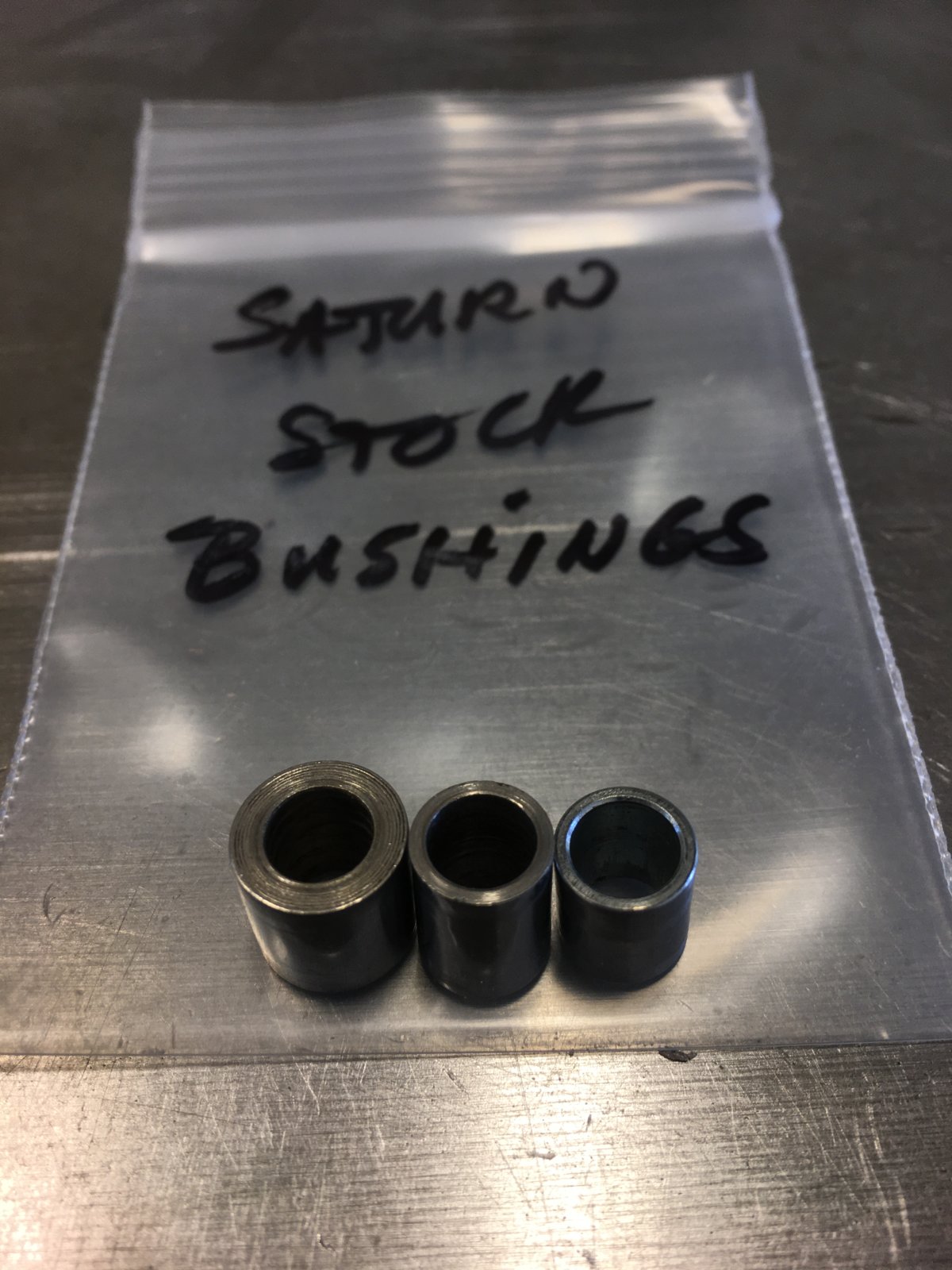

Here are the bushing types I use.
First I use Nikitas TBC bushings. Then sand with TBC delrin bushings I made. Lastly after CA is applied and sanded I use delrin regular bushings I turned on a stick to buff the pen bodies. I included a photo of stock "mandrel style" bushings too.

Mark, those are nice bushings and a good idea. A bit more than the general bushing but should last a long time. Thanks for sharing.
