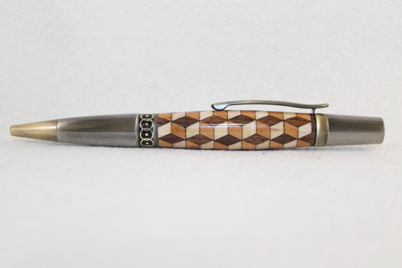

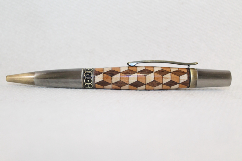

Tumbling block pattern on a Gunpolish & Antique Brass Elegant Monarch. The woods used were walnut, maple and cherry. The blank is comprised of 98 individual segments that were cut with a laser utilizing a custom built rotary device.

98 segments, and the curved shoulder (bushing ID to OD) is what... maybe .75mm (math was not my subject)... yea, pretty fragile! CA is your friend.
Well done. I want to be a fly in your shop.
Beautiful!
Does the design goes around the pen, or is one point of view different from another?
The segments are cut from round hollow wooden tubes using a laser and a very accurate rotary device that I built specifically for pen work. I lay out all my patterns for a seamless wraparound. This blank was a little tedious assembling because none of the segments interlock. Hope this helps answer your question.
