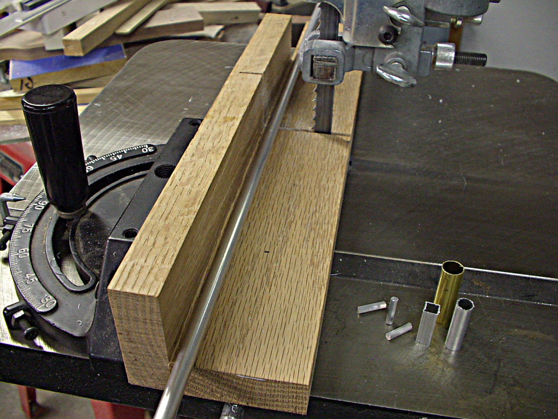

I use this… but I think PSI sells a one similar with a better base for cutting.

I use the same one John uses. I would suggest the one with the better base. It has a stop so you can cut several without measuring each one and they're all exactly the same.

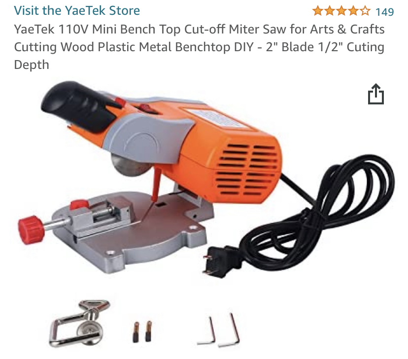

I have often thought about buying one of the little electric cut-off saws though. I know Harbor Freight sells one for about $40, but it is likely very basic. I think the one from PSI is similar, but they mount it to a base with a T-Track type of fence. It's about double the cost though.

Bandsaw, cut them a little long and then use Rick Harrels squaring jig to get to perfect length. I've also used plumbing pipe cutter with the proper size punch inserted into the tube. Usually have to lightly team the cut end after.
Bandsaw with metal blade when I need to cut. But every kit sells extra tubes it is just a waste to buy bulk when you can buy exact lengths. No guess work.

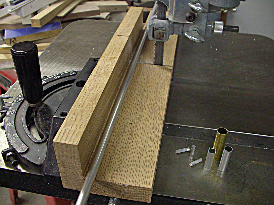

I have one of these, too. Different brand, but it gets the job done nicely! I found a jig for these that can replace the built in clamp, that is designed to properly support long tubes during cutting. Forgot where I found it, so I haven't bought it yet, but it looked like a superb addon. If I ever find it again, I'll link it.
I just picked up a metal cutting bandsaw blade, with 10/14 tpi (I guess it has alternating ranges of teeth of different size/tpi), that I'm itching to give a try. I may have to create a little jig like in John's post above here and try that. I have tried using my normal wood cutting blade in the past, but its just 4 tpi, and it seems to bite and claw at the metal. Maybe I'm just too much of a bandsaw noob to handle it, but it worried me too much and I went back to the little metal cutting saw.
I use both a mini tubing cutter and the harbor freight mini saw. Neither is perfect, in both cases it is necessary to deburr the cut ends with a deburring tool.
