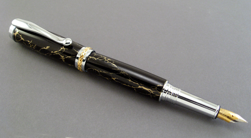

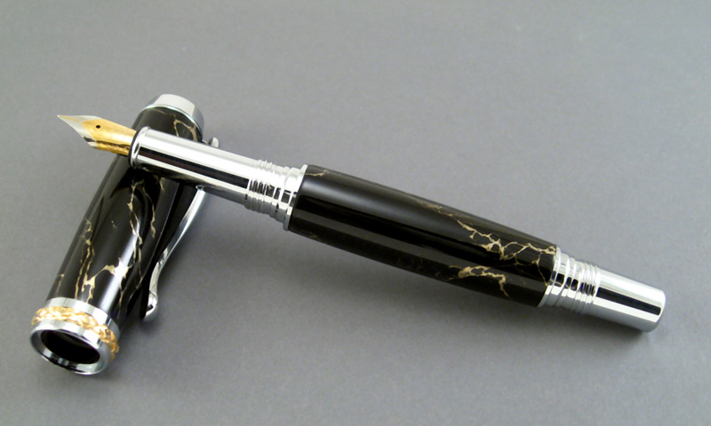

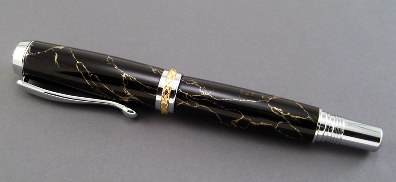

This was my first tru-stone attempt, a Black with Gold Matrix on a Triton fountain pen. Had a little trouble getting it to "shine" using my regular methods. Thanks to Andy (PenMan1) for some helpful advice, here is what I ended up with ...
Comments welcome!

Lenny,
I'd certainly be happy with that shine!!!
You want to be able to tell it's stone, not Polyresin!!
Great looking pen

I think you should just throw it away, say in the mail to me. WOW! It sure knocked my eyes out! A really beautiful combination. Great pen.

Wow, that looks fantastic Lenny. I'm really glad you posted this as it is a very classy look and shows off both the blank and the Triton just beautifully. Your fit looks top-notch in the photos as well.
Nice Job!

Great description. I turned a piece of blue lapis tru-stone and it wasn't near the mess black matrix turned out to be.
Lenny, great work. You produced a great looking finish on that tru-stone, which I found to be more difficult than it would seem.
