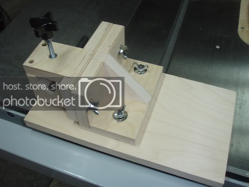

I wanted to make a blank squaring jig to use on my 12" disc sander but was not happy with any of the existing jigs out there. The main reasons included:
-only one size of rod holding the blank
-not adjustable for square, necessitating a high degree of accuracy in manufacture
With those problems in mind I set out to design a jig that would hold the transfer rods we all use to knock apart pens in such a way that they could be easily swapped out so that the blank is always on the best size of rod without needing to use any sleeves. I always wanted a way to be able to adjust the jig to square with the disc so that it is always accurate. I also wanted it to be easy to use.
This is what I came with. I first built a prototype a couple years ago out of MDF. When that worked exactly as I had planned I rebuilt it out of 3/4 Baltic Birch plywood and took pictures of the process. That was longer ago than I am going to admit, but cut me some slack, I am in medical school.
So without further ado, I give you the best blank squaring jig ever. At least in my not so humble opinion.

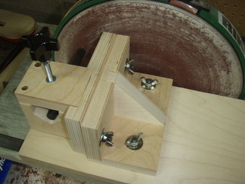

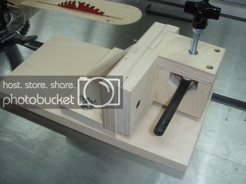

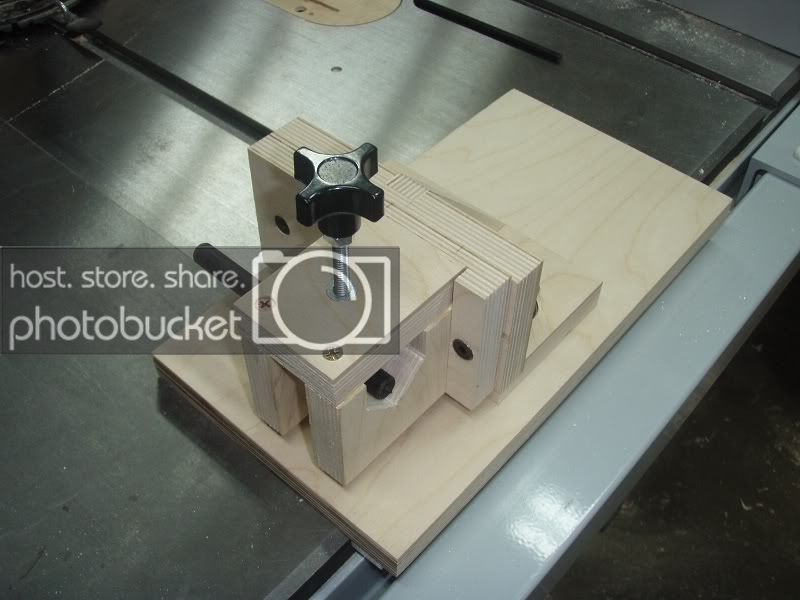

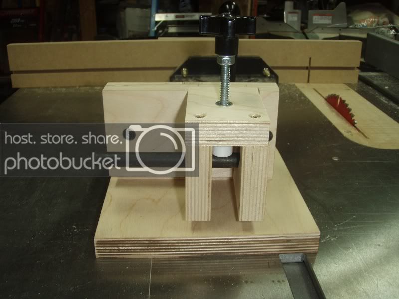

The transfer punch is held securely by the captured bolt and punches a swapped out easily by simply loosening the bolt. No adjustment is necessary for different size punches.
The punch carriage adjusts easily side to side and up and down. One of the two bolts securing the carriage in each direction is slightly enlarged. Simply place a small square between the punch and the disc, loosen the appropriate nut, adjust as necessary and tighten the nut. It holds very securely.
To use the jig just slide the whole jig to the left, it's mounted to a miter bar. Once the punch is clear of the disc, place a blank on the disc and slide the jig back to the right. Then push the blank into the disc. Because the blank is held securely on the proper size of punch it takes almost no effort and can easily be done from the end of the blank away from the disc without worrying about slipping off and sticking your fingers into the sander. Multiple blanks can be sanded quickly and safely without needing to stop the sander.
Super simple, super fast and super accurate.
I am working on making a tutorial that will hopefully go in the library with a materials list, directions and a complete plan.

Time to build it depends on your woodworking skills and tools available. I used a table saw to cut the pieces to size and to make the dados/rabbet, a drill press for the holes, and chisel to clean out a rabbet between two parallel dados. If you have all those tools its pretty quick. If you don't have those its going to take a little longer, but can still be done as long as you have a way to make the dados such as by using a router.
Just realized that your time question is probably referring to when will I get the tutorial done. Probably not until sometime next week. I posted this up now you so guys had one more thing to drool over :biggrin:

Looks like a nice jig. One question...it seems like you could eliminate one of the two vertical pieces of wood held together by the wingnuts and just hard mount the assembly as one piece. Why does it need to come apart at the center unless you plan to mount different jigs to the other part.
One vertical piece, the one held to the horizontal piece by the angled support block, only moves in the horizontal plane pivoting on the wingnuts holding it to the base. The second vertical piece, pivots in only the vertical plane on the bolts holding it to the first vertical piece. Combined the punch moves in both planes. Having the horizontal and vertical plane adjustments independent makes it really easy to adjust to square.

Ah that makes sense...I didn't think about having to adjust it vertically.

I sent this message as a PM to the originator of this post but since it may be of general interest, I will post the question here.
I am looking for a large disc sander (10-12") I saw the Rikon machine you show in your photo in Amazon.com for a very reasonable price, but it has received really poor reviews. How has this machine worked for you?
