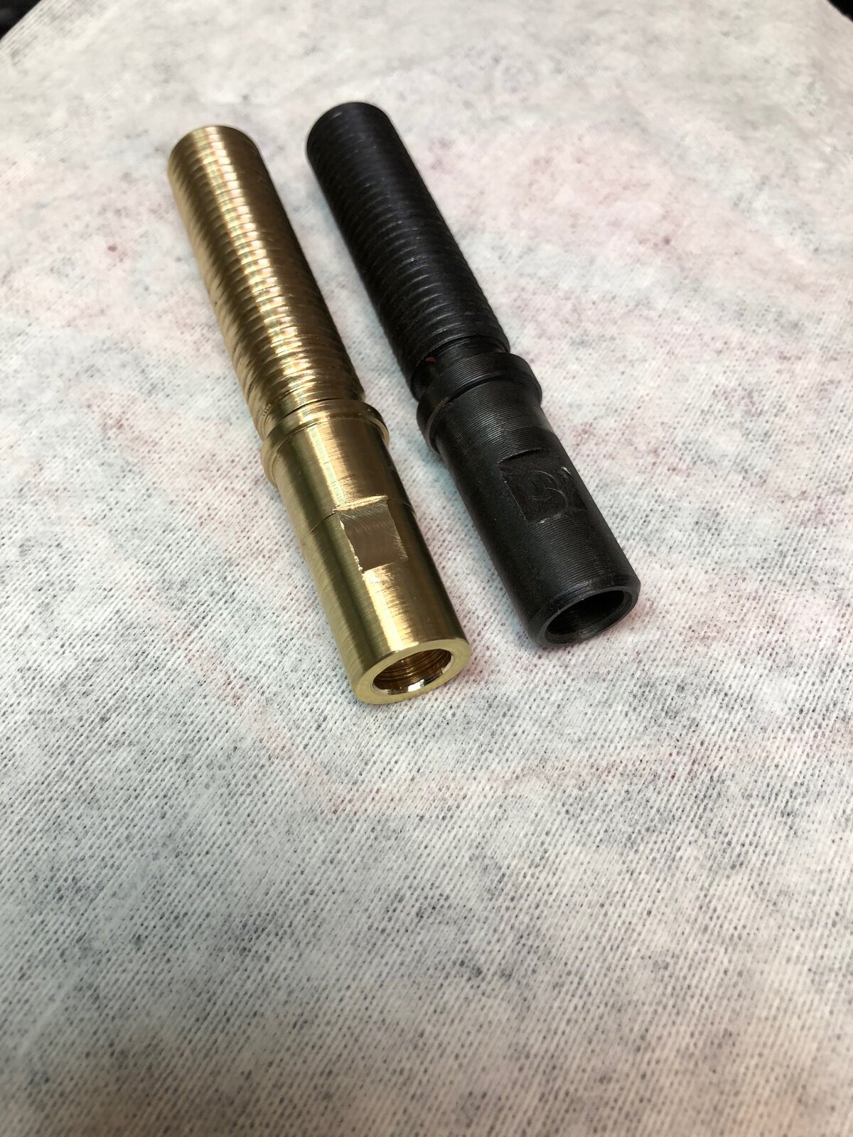

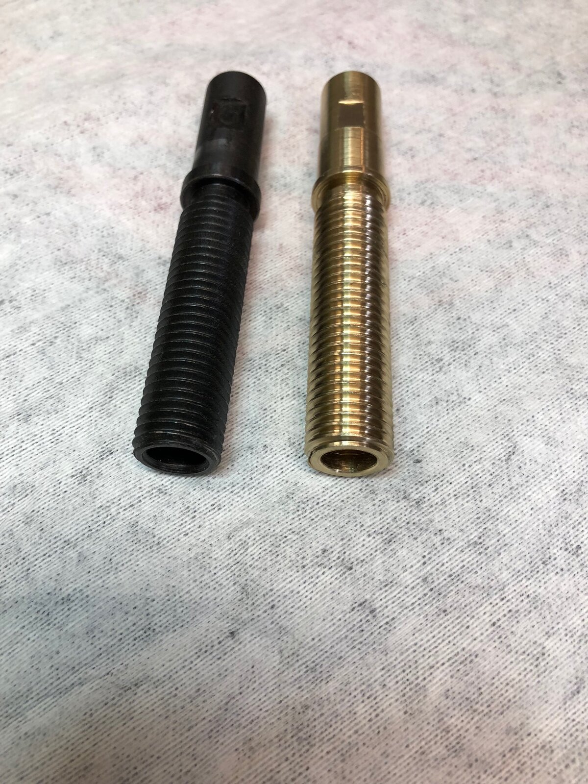

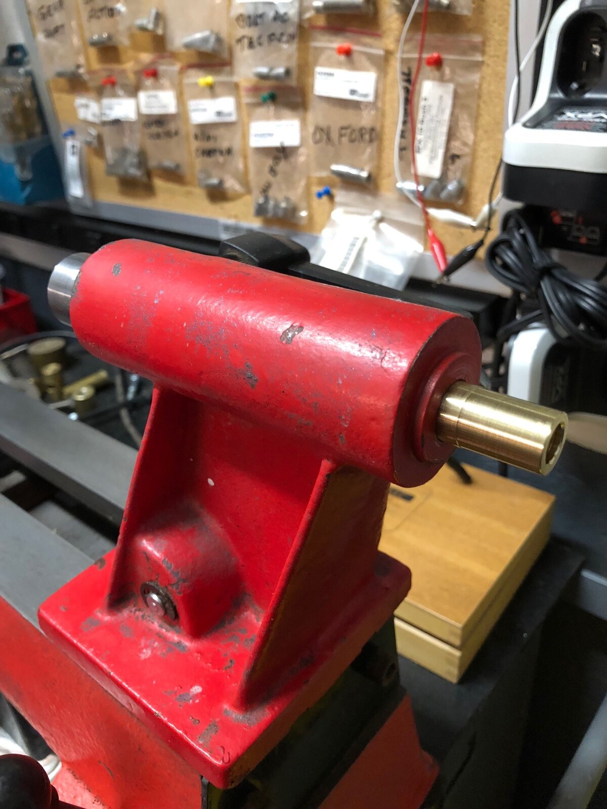

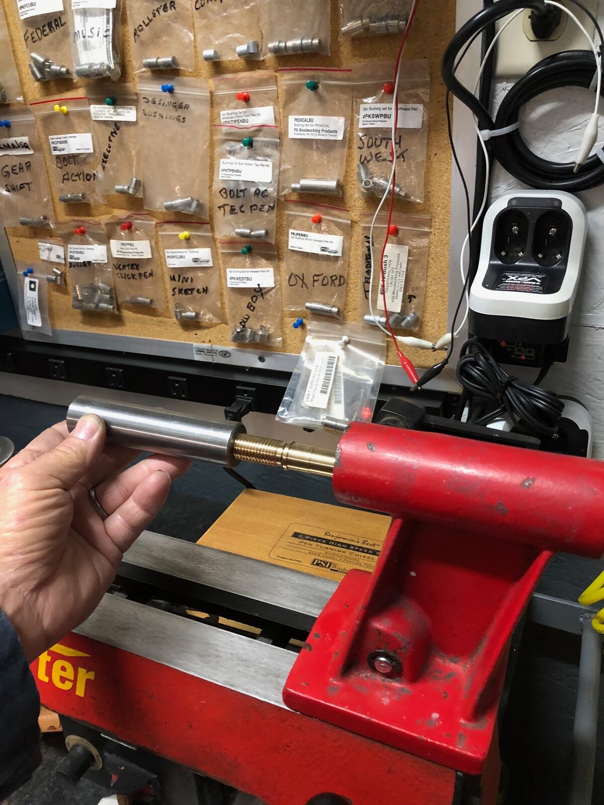

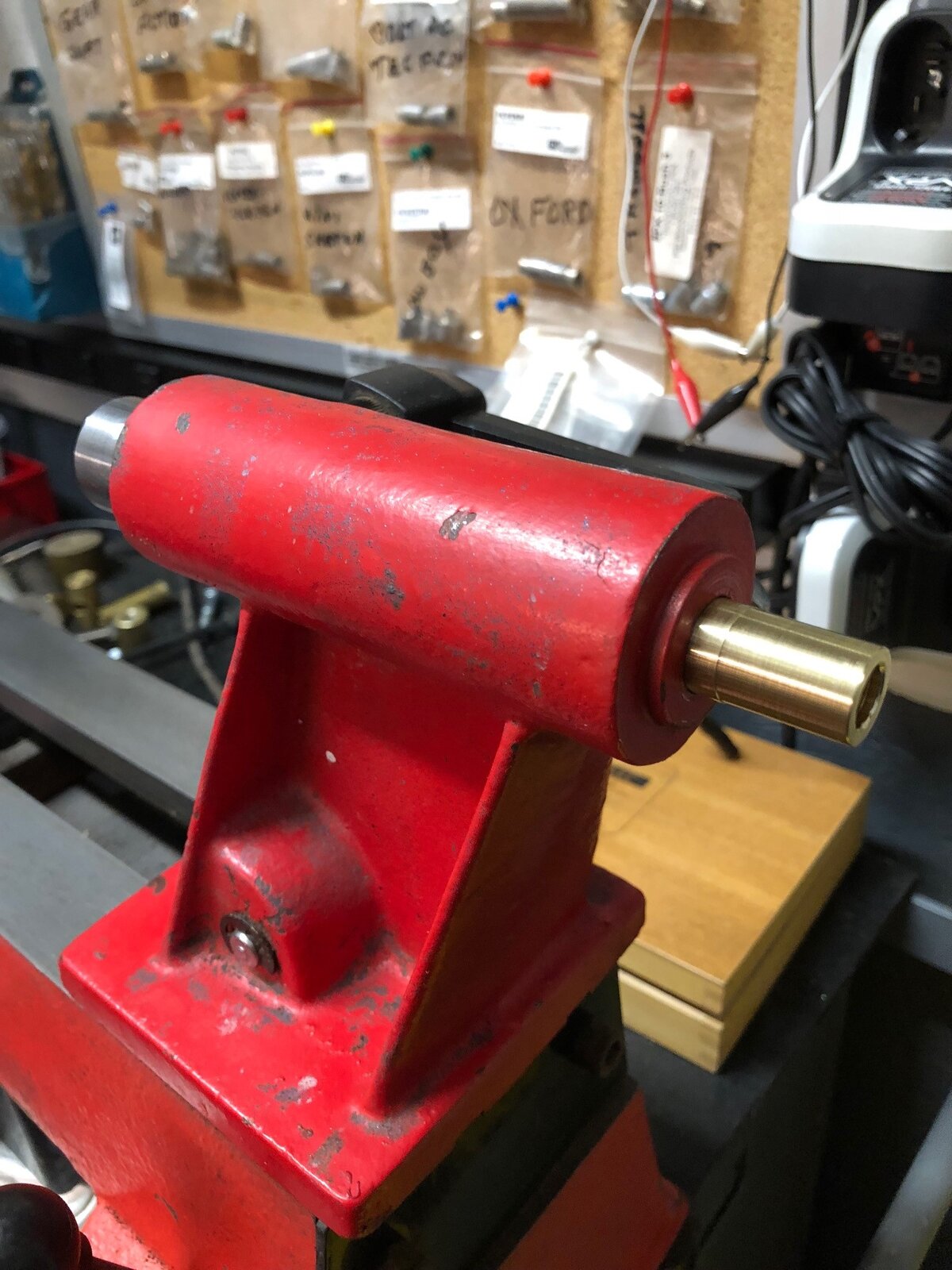

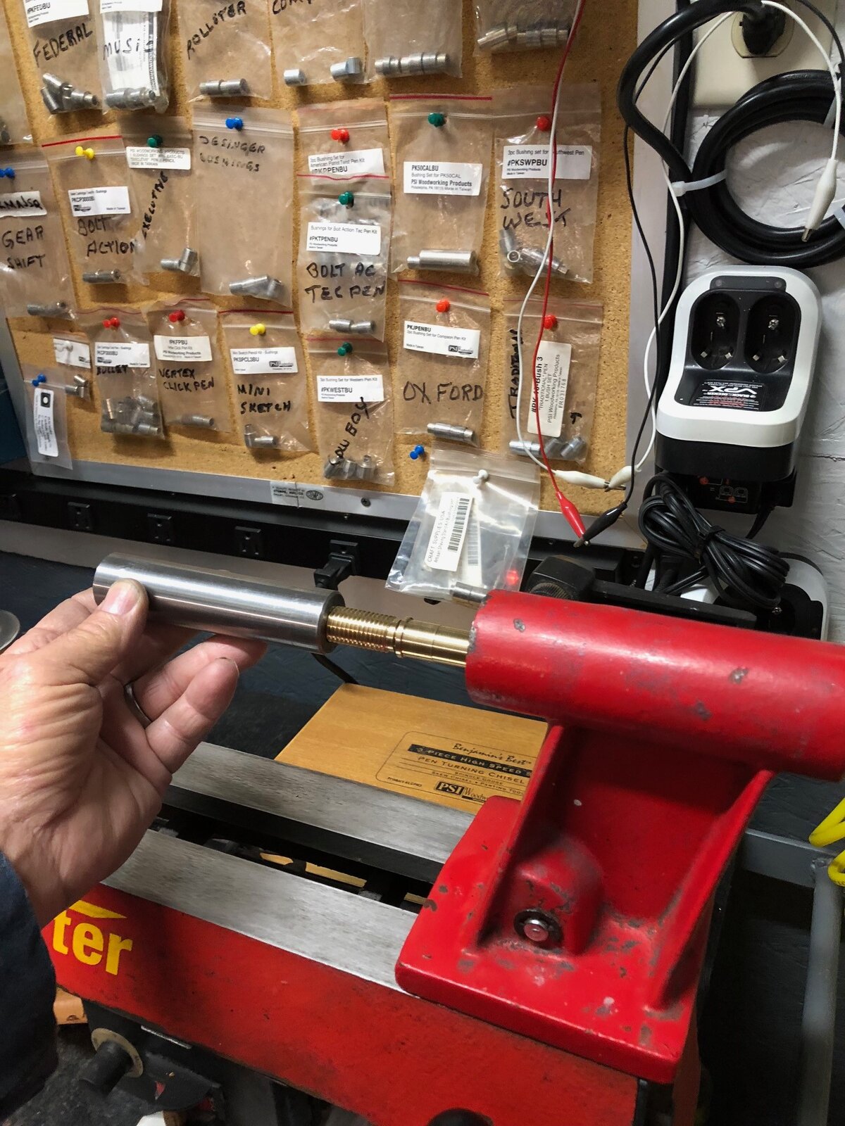

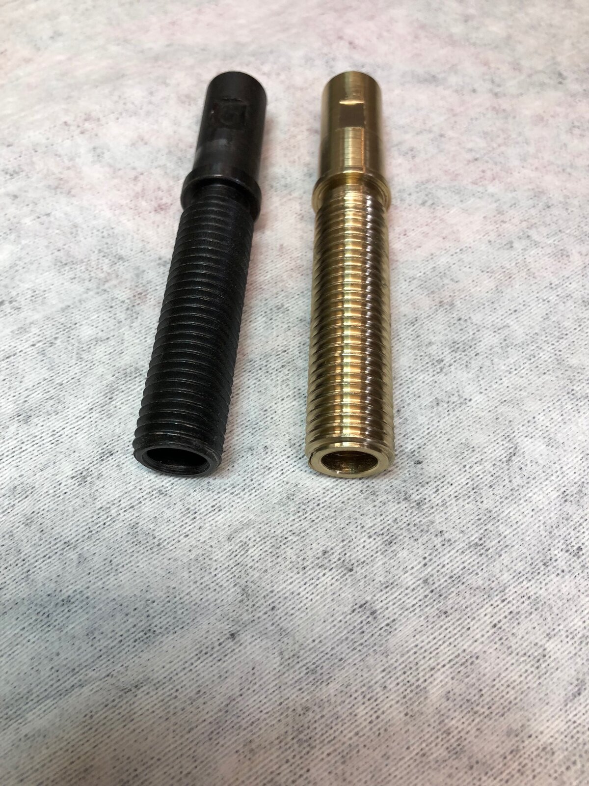

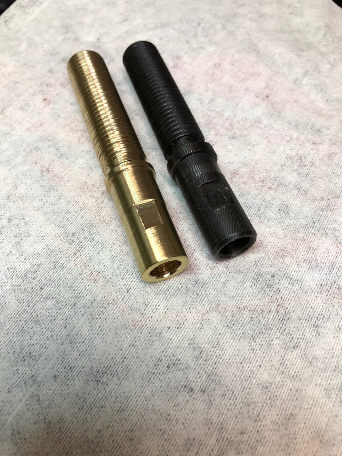

Mine did that what I found was just enough wear in the tail stock quill for it to **** to one side and cause the problem, so I machined on metal lathe and that took care of that problem, I made it from some brass scrap that I had on hand.
