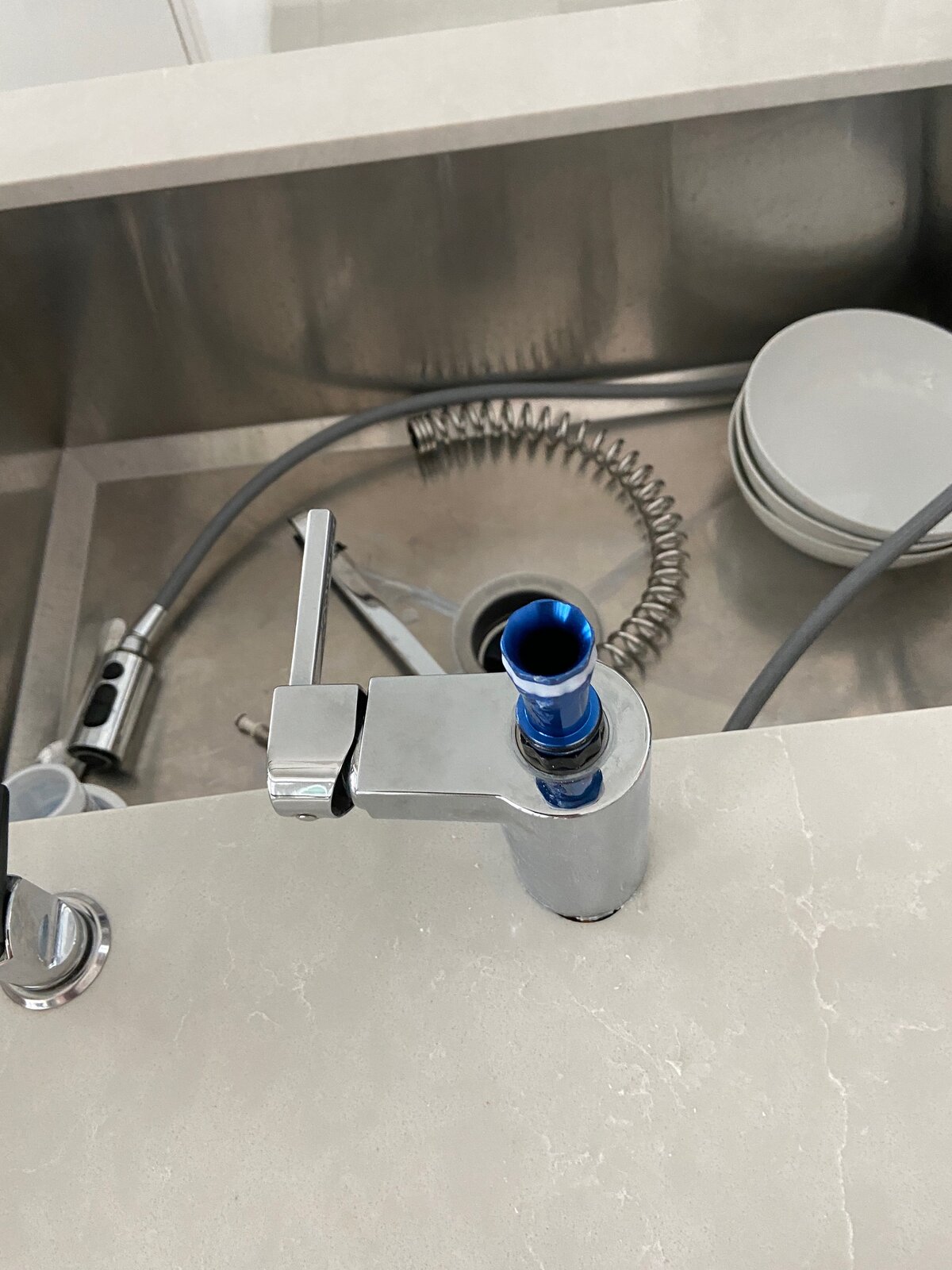

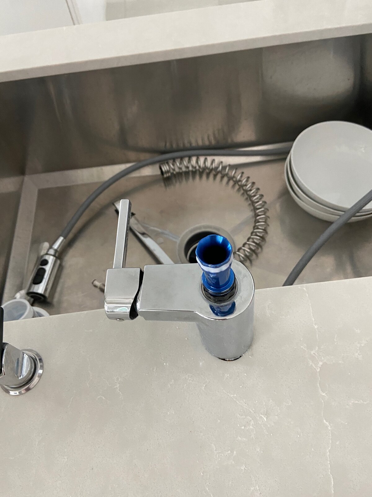

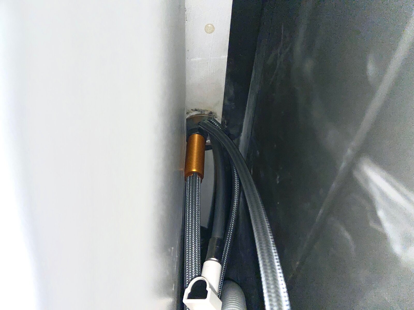

New house. Hacker builder. Faucet needs silicon at base and the basin nut has to be tightened. I can not see it. Cannot get a basin wrench up there. It is tight. I'm trying to access from the rear. I'm so lowly making my way through. Taking out the sink is a major project. Will use a master plumber if I can find one but I'm up for suggestions.

Frank, I'm not a plumber and I didn't stay at Holiday Inn last night but I do work part time in a small hardware store and I've never seen a basin sink with 4 hoses in 1 hole. From the picture I don't see any way you could get a wrench around the nut to tighten it without removing the sink and turning it over. The basin should not be hard to remove but after seeing the picture, who knows.

Is that a Delta "ToucH2O" faucet?
Like Monty, 4 hoses into a faucet seemed odd but I happened across our ToucH2O manual and there are 4 lines plus a sensor wire.

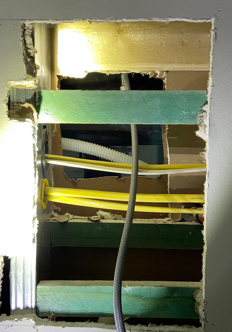

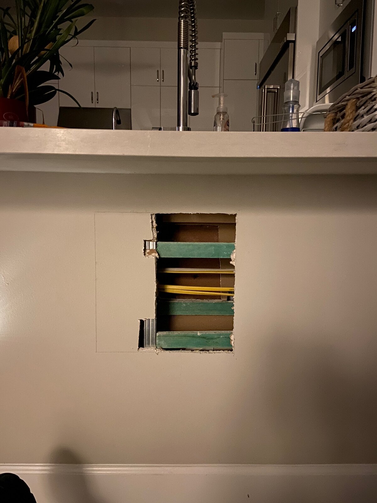

Thanks. The only hope is coming through the back of the cabinet. The dry wall has be cut out. I have one more panel to cut and it's live or die.

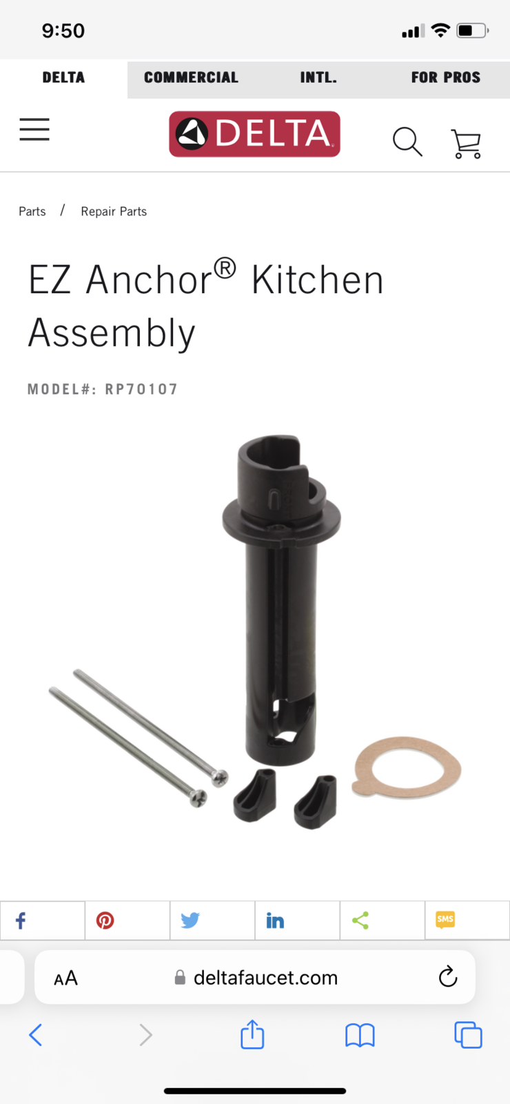

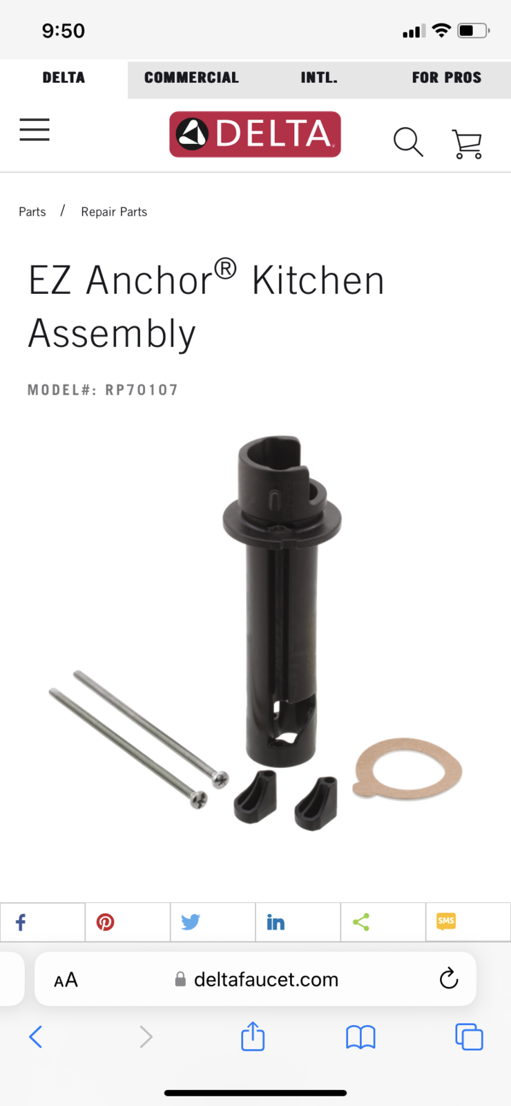

Will do that tomorrow. Anyway this is interesting. Top faucet mounting adapter. I'd get a compatible Delta faucet. I feel I can get the old one out with some thought & language.

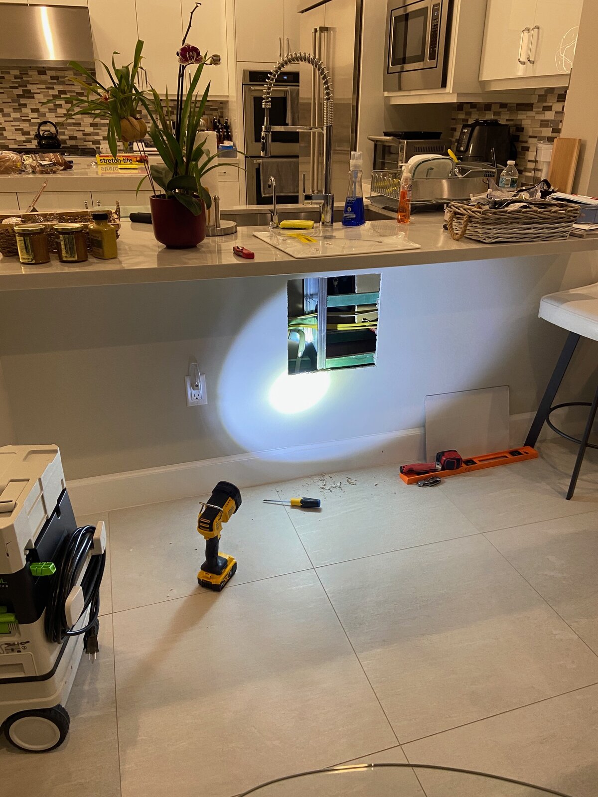

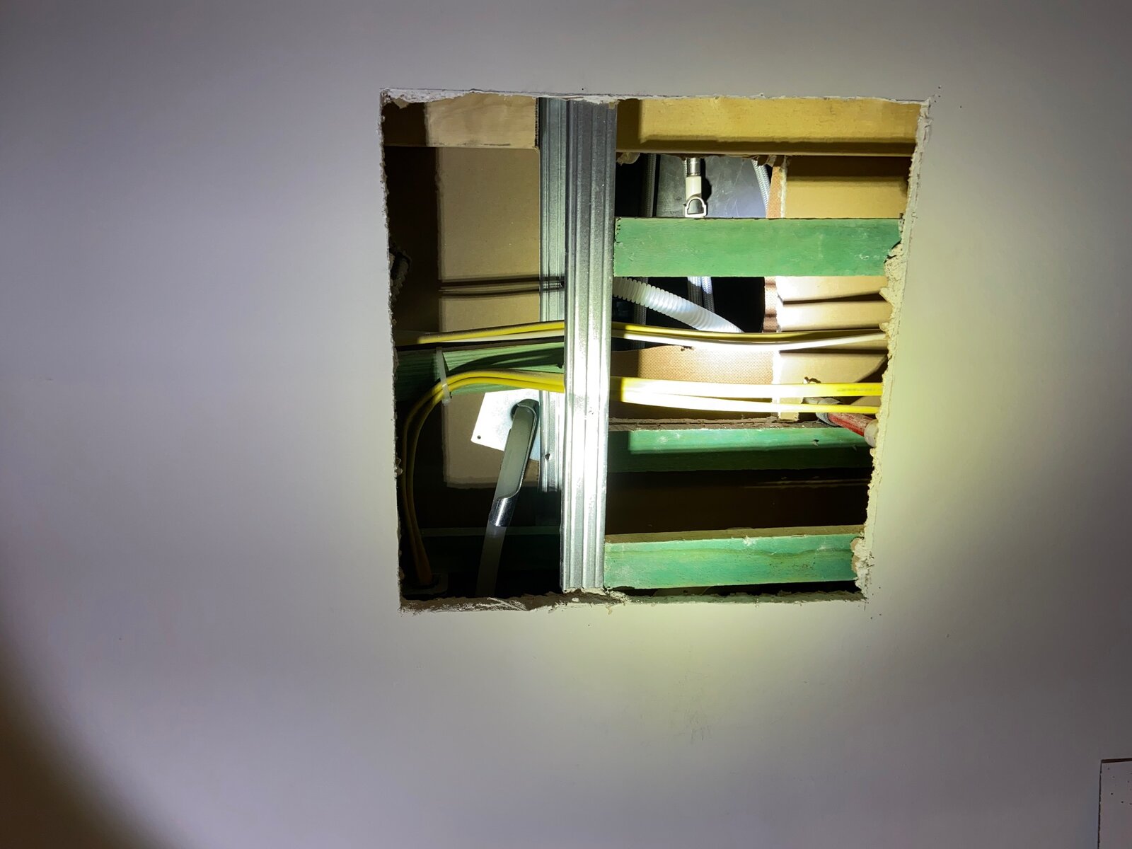

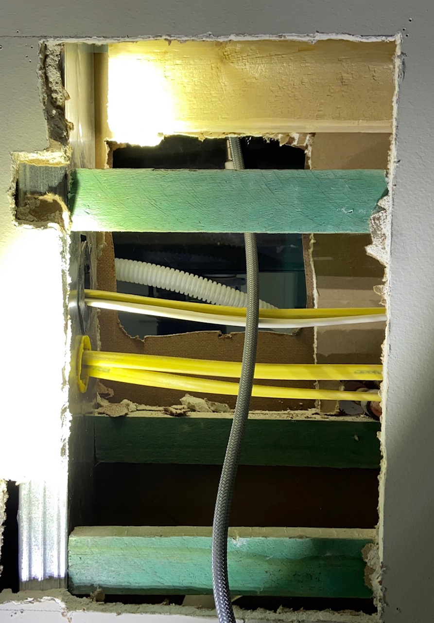

This looks like the point of access for now. I'll go further until I can complete or hit a brick wall. The Masonite panel behind the green studs gets cut with a Dremel and thin cutting burr.

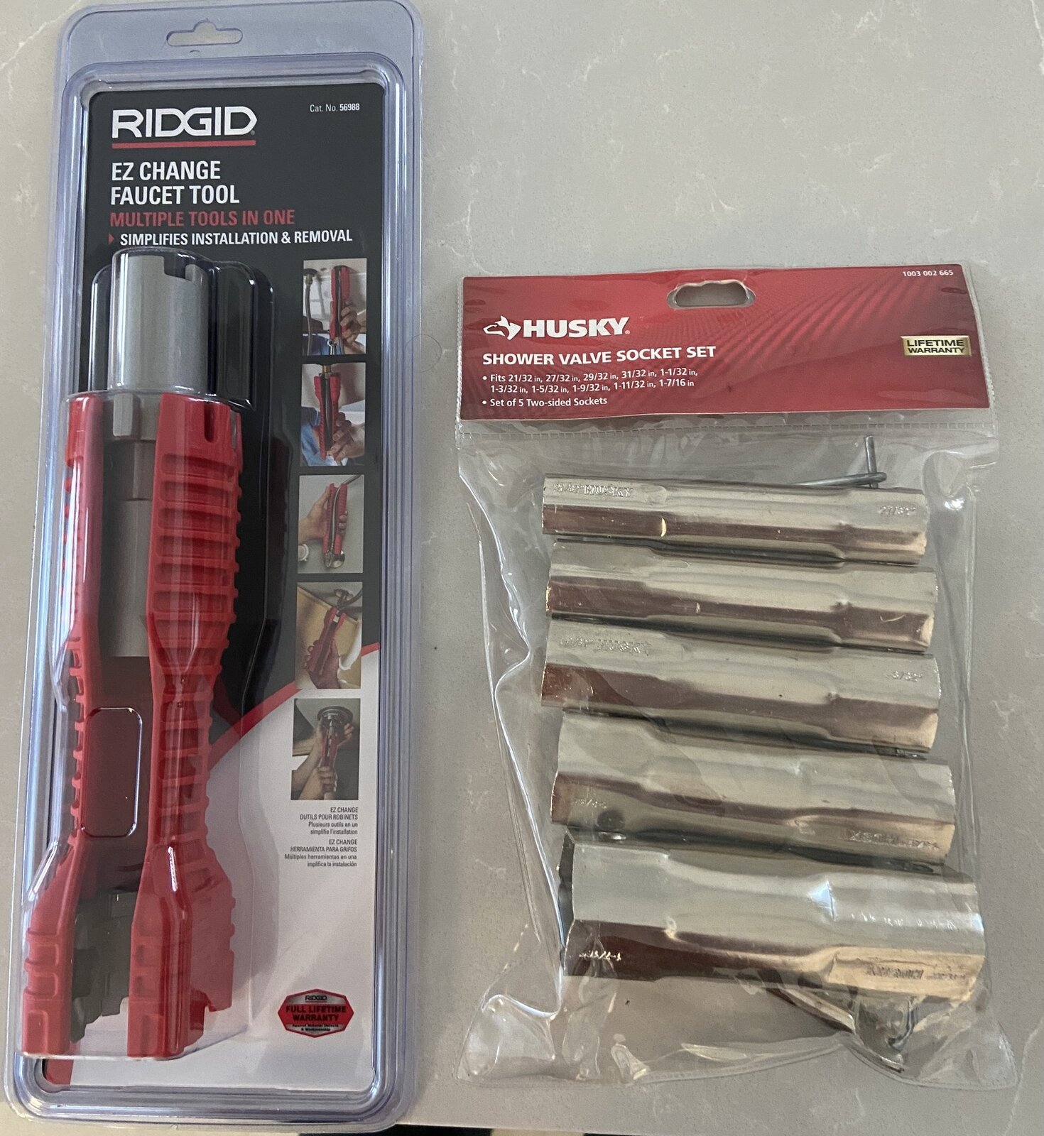

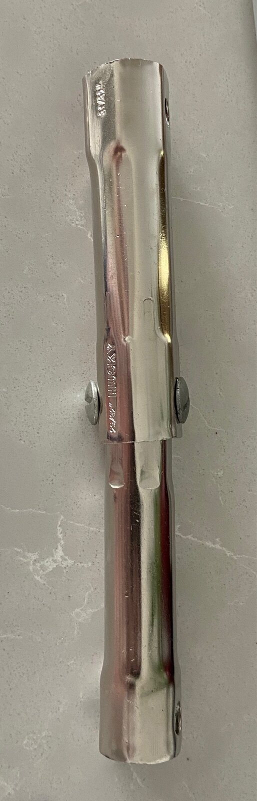

I just ordered Husky Shower Sockets… the have potential. Thanks for everyone's replies. I'm getting there. I'd give everyone a pen as a thank you but you have your own
Might work out. The Husky's might fill the bill

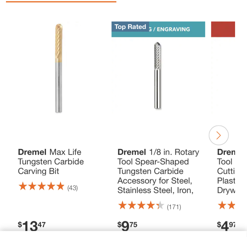

I need high quality burrs to cut through a Masonite panel. Junk I can find anywhere. I want good cutters. Where and what to buy. Thanks.
What type tool are you using to do this cutting.
Sorry forgot to mention.... I think I can only get in using a Dremel with the burr protruding about 1/4". Will need something like one these burrs... some cut great...some clog up

Hi
How about a woodcutting Rotozip bit? It has a 1/8" shank so it will fit a rotary tool.
From the Rotozip site:
SC4 Sabrecut Bit 4-Pc
Model # SC4
Cuts through all wood, fiberglass, OSB, laminates, plastic and vinyl/aluminum siding.
Mike (Penultimate) is right on with the Rotozip. They have saved me a lot of work in the past. I don't use mine very often, but when there is a good fit for the job, it can really come to the rescue. - Dave

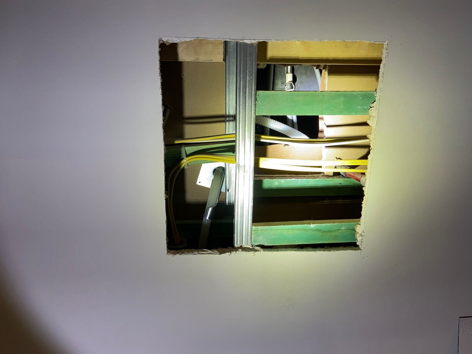

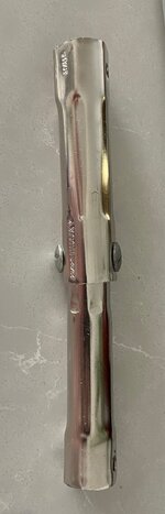

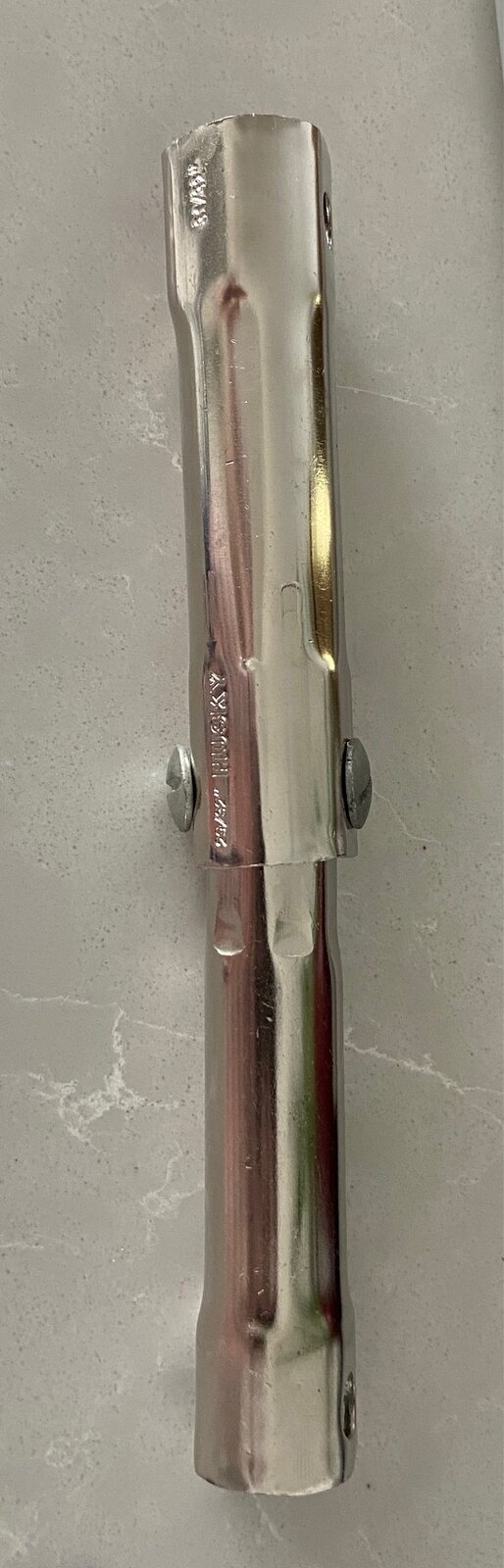

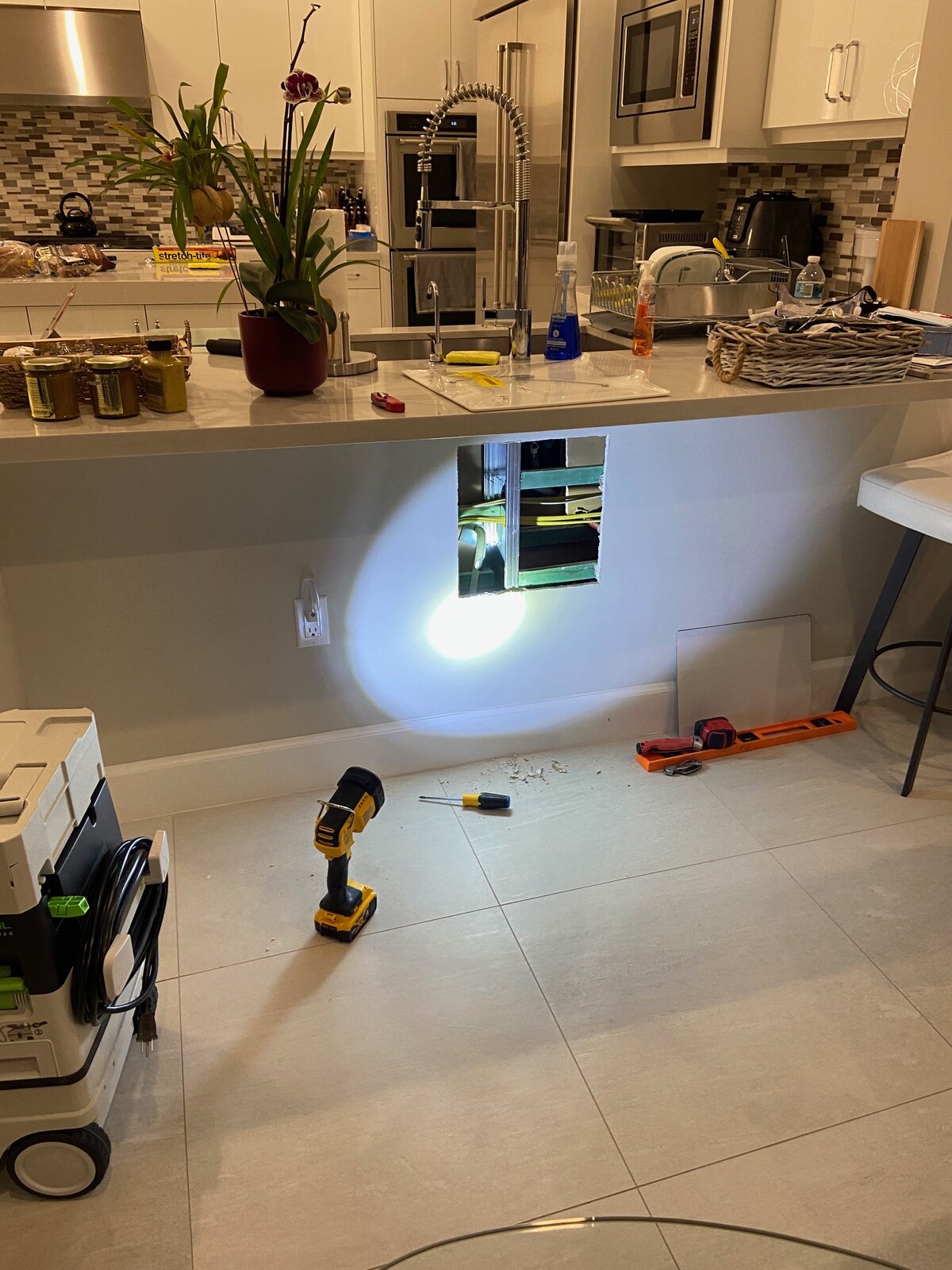

2 hours under sink today. Hated every minute of it. I'm 75 and too old for this. Too old meaning I don't need the agg. Did a lot of cutting from the rear but that helped. I stacked the set of sockets and that accommodated the length to access the basin nut. I managed to tighten the faucet. At this point I have good access and the right tool to remove for replacement or tighten again if needed. Thanks for all posts.
Faucet sockets. I stacked the 5 piece set. Interesting how 1 tool is key to any job.

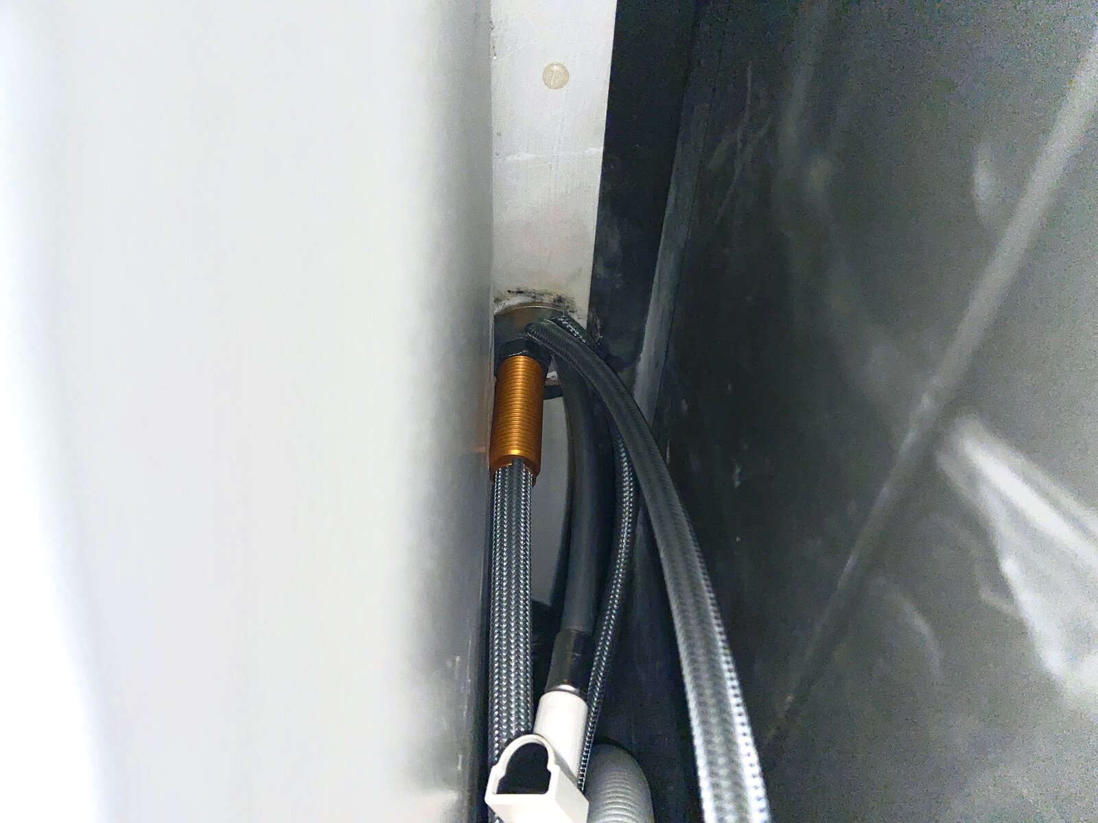

It is a 3 hose system. One line comes out and returns to the faucet through the threaded gold colored fitting.

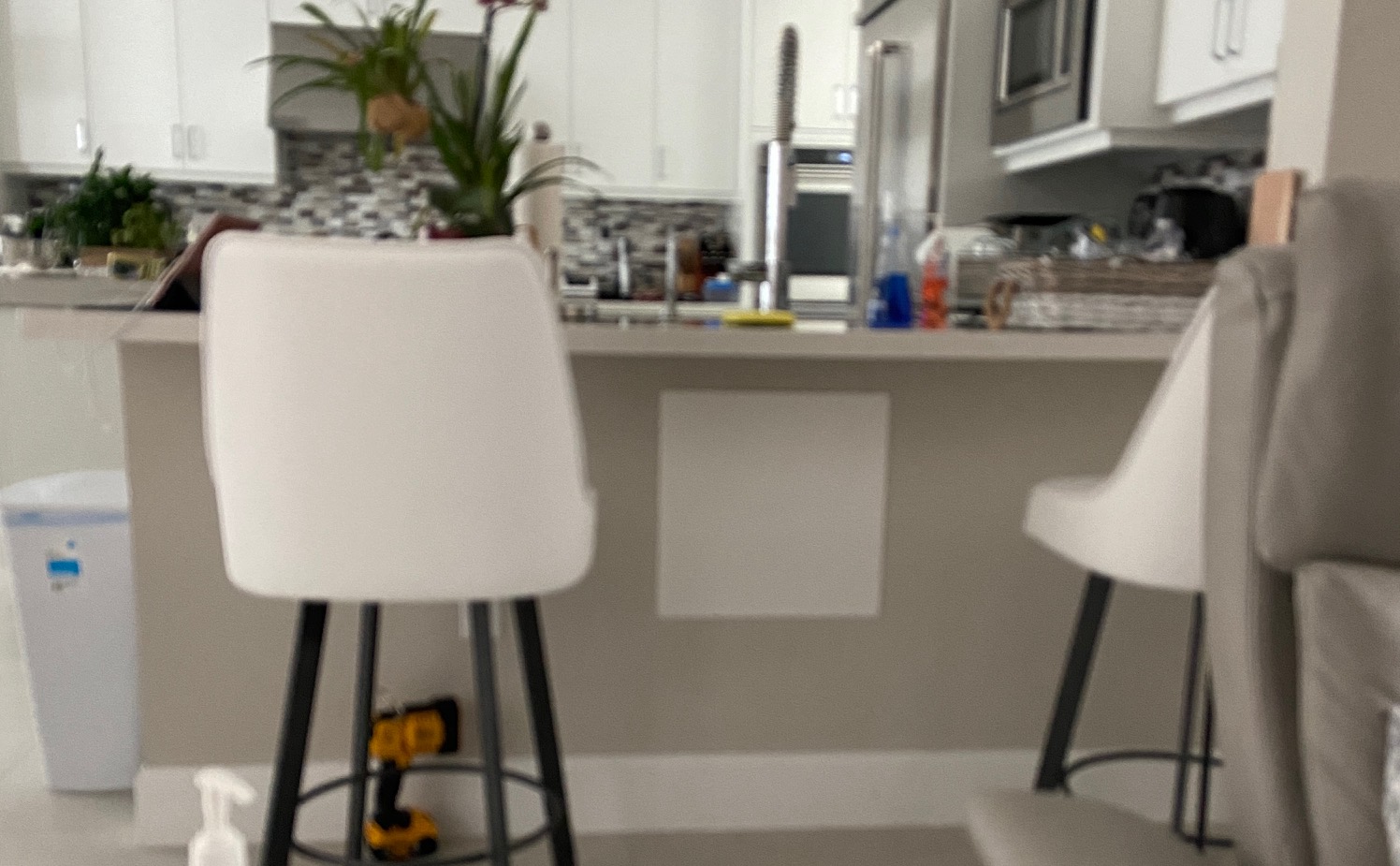

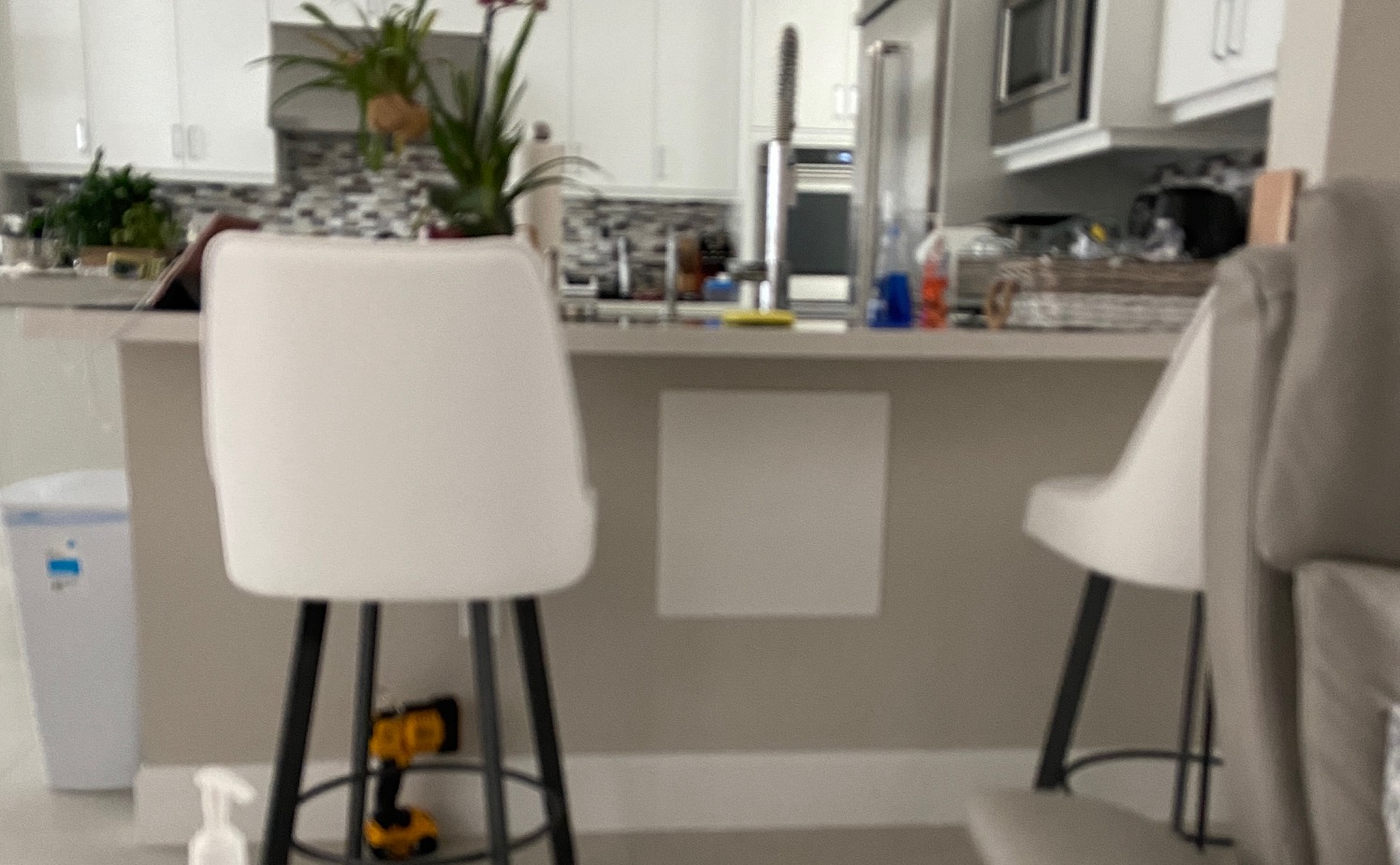

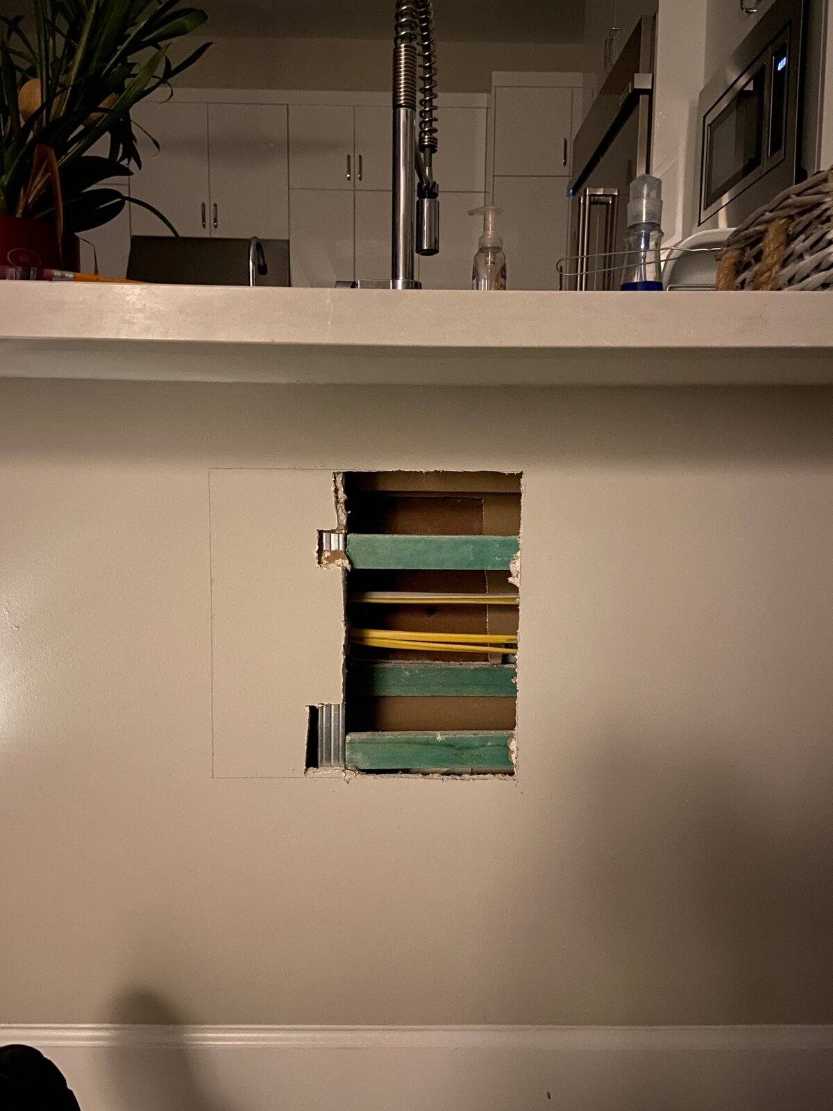

Fluid Master 14x14 panel. Will paint and that's it for now. I might leave it in case access is needed. Might drywall the hole. Not sure yet.

All that to tighten a nut. Glad it worked out. Probably plumber just did not want to do it. There is always a way. If it was installed it can come out. :)
