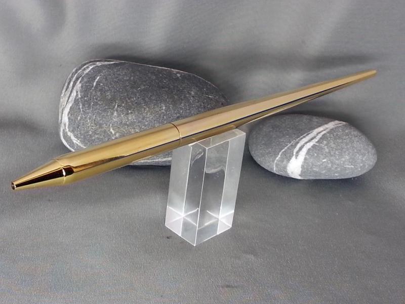

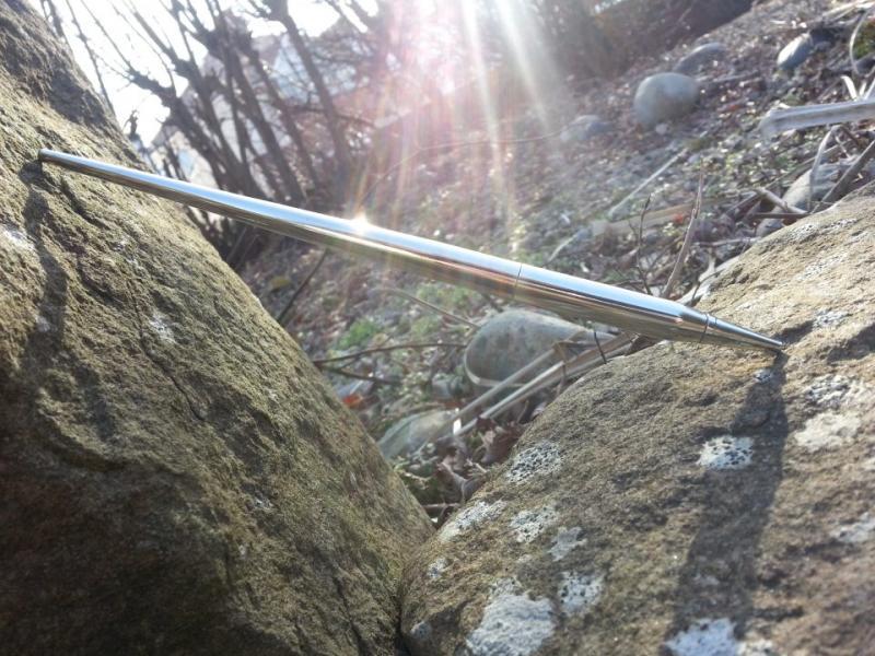

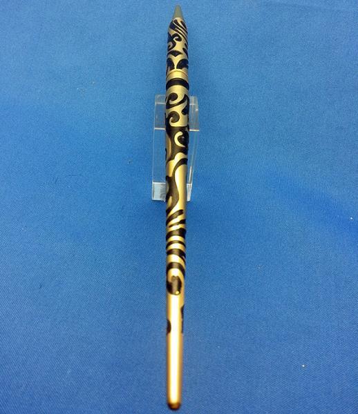

So, how do platers respond? Well, if I were to plate something in 0.4g/L the work is going to look pretty dull and poor to say the least because of how thin I would be doing the plating.. but what if I chrome plated it first and then gave it a thin coating of gold? The shine of the chrome will show through the thin layer of gold "appearing" to be really shiny gold. Take a look at the attached pens for comparison. both have been chrome plated (actually bright nickel - not chrome.. another industry lie... but could you tell the difference with an untrained eye?), and one has been brush plated with gold.. so a very thin coating, but the lustrous shine bursts through because of the chrome effect beneath. The third pen, which is etched has just been gold plated with no chrome underneath... see how dull it is?
Going on from there, different types of gold plating
FLASH PLATING - short process, generally 5 to 30 seconds and the deposit is around 0.05 to 0.1 μm
24ct
Gold 2g/L
18ct
Gold 1.6g/L
Nickel 0.15-1.5g/L
Hamilton
Gold 1.25g/L
Nickel 0.3g/L
Copper 1.5g/L
White
0.4 g/L
Nickel 1.1g/L
Rose
Gold 4.1 g/L
sodium hydroxide 15g/L
sodium carbonate 30g/L
As we can see, the gold content of Rose gold plating is alot higher than the others with 24ct coming in second.
These types of plating CANNOT be marketed as a gold electroplate as then it would require a thickness of at least 0.175μm.
If marketed as heavy gold, then 2.5μm
The trouble here, is because all of these values are so low compared to other metal plates, its very hard to maintain the balance of all of these metals in the gold bath. A slight drift in ph or electrolyte concentration of macrometals if you will, will give varied results including colour. not good if you;re looking for repeatability.
