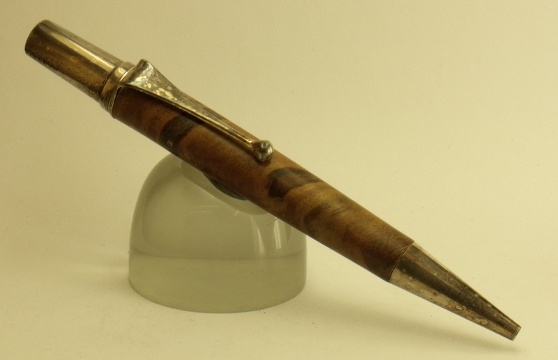

Here is a pic of a pen that was labelled as Sterling Silver. There is of course no such thing as Sterling Silver Plate....if it's plated then it ISN'T Sterling.

Thank you very much for the photo of the tarnished solid sterling silver pen that is one part of things. Now if we can locate one that is plated and get a photo of that.
I have applied the 'everything is hearsay unless you can show facts' to this thread to keep out the falsehoods, the myths and the like, then only thing left will be the truth. I prefer the facts listed so everyone can see them, i.e. the posting from berea and your photo.
I will also be subjecting one of the platted kits to artificial tarnishing in the weeks to come for this thread. Apart from that I will also be calling a shop that I work with who has a spark analyzer for cast iron. I think it will show gold and silver in the report and if it does then it might be able to get a reading from that.
That pen is plated. It was fraudulently sold by the vendor as Sterling.
If an item is sold or claimed as Sterling, then it MUST have a mark to prove it.
No mark.....not Sterling.
