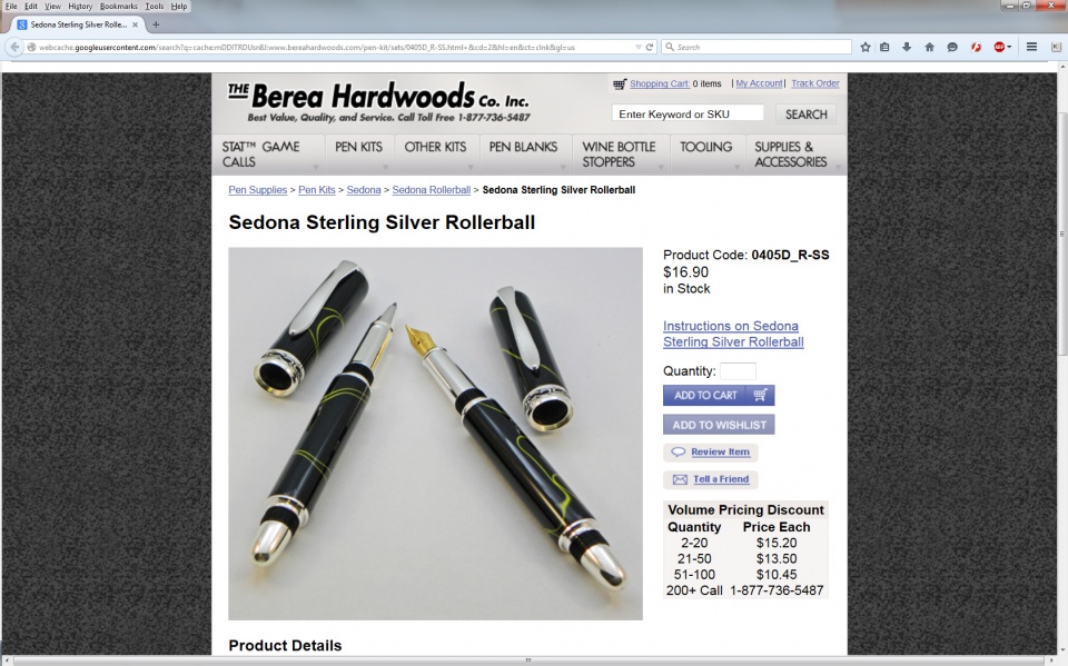

I would like to take this time and thank Bereahardwoods for doing the following, it shows good intentions and you have to have respect and admiration for this.
It would seem that the website has been scrubbed all references to the word 'sterling' .
Sedona Silver Rollerball Pen Kit Making Supplies Berea HardWoods
Here is the link.
Here is the cached copy to show the before/after changes.
attachment.php
I am not sure of what is going on behind the scenes but I do know they have been watching this thread. I am also not aware of any of the sub-vendors changing their lineup but I am assuming they will be following suit soon.
Berea is showing that the major Vendors do watch us and will do the right thing given the opportunity and I'll bet they'll ask their resellers to do the same.
