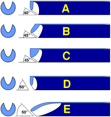

"swept back wings" "Irish grind" and "Ellsworth grind" are all basically the same thing.
Overall the biggest difference is the angle.

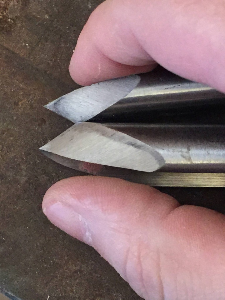

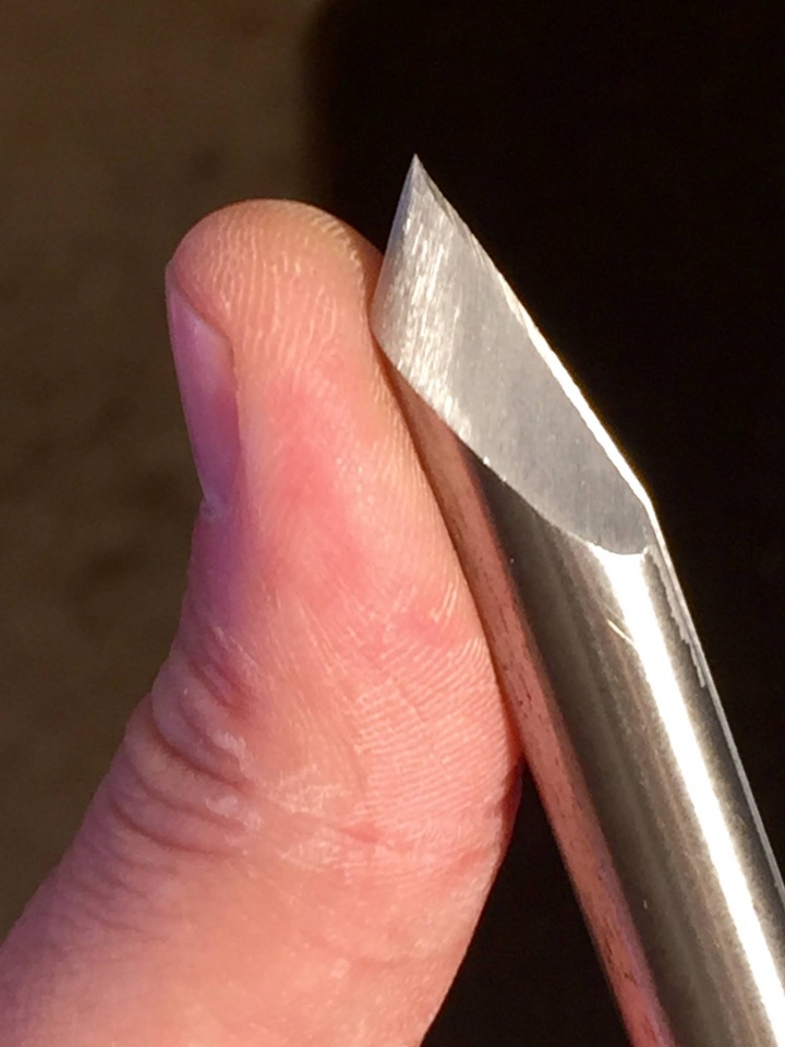

This is the ones I use.
attachment.php
I use this irish grind, it's 1/2" for more detailed delicate work, sharper angle and highly aggressive.
