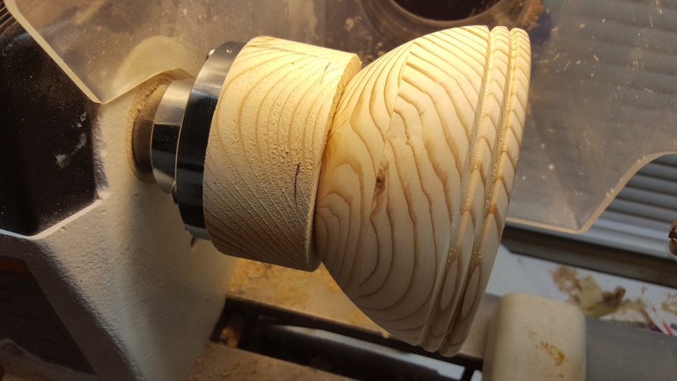

Here is the start of my first bowl. It's a practice bowl made from a glue up of 2" X 8" pine I cut down to 6" X 6". I never done a bowl before so I thought this would be a good place to start before I use a good blank. I used my Carbide cutter.

Thanks for all the comment's. Cody I watch the video and I may give it try at this point I'm not sure just how I'll finish it I hope the inside comes out nice to I'll have the chance to finish it.
Dan, Your bowl looks fine! I wouldn't call it a practice bowl.
Many folks don't consider pine to be a turning wood. Some of it has some great grain and coloring.
I have seen a charred bowl demo. One of them was charred on the outside with natural wood on the inside. One had a red dyed top rim. It really looked sharp!
The best part of a charred bowl is you don't need to sand that part!

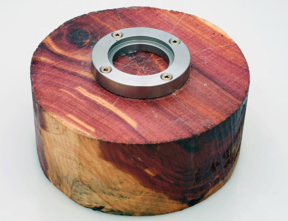

Is that tenon deep enough with defined enough sides to grip in the chuck? A lot of chucks need a slight dovetail tenon on the bottom of the bowl for a secure grip.

Of inThanks Bill, Charlie and Skie. Charlie I'm calling it a practice bowl because it's something new for me. I do like the grain on this bowl. I'll have to see if I can find the video you spoke of. Skie I don't have a chuck so I'm using a piece of wood with a mortise turned in to it and I CAed it on the the bowl bottom. I saw it done on YouTube. I'm hoping it doesn't fly off when I start turning. Below is a picture of the rig

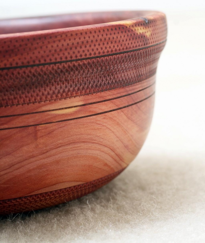

That's a clever idea. Do you just turn the piece of wood with the mortise away when you are finished then?
https://www.woodturnerscatalog.com/p/16/2134/KC-Wire-Burners-3-Pack?term=wire
You can use this product for the groove areas.

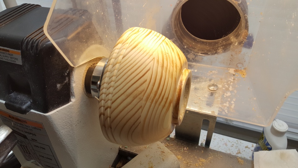

I have a question as I get set to turn the inside of the bowl. What would be a good caliper to use to keep the sides of the bowl uniform.
https://www.woodturnerscatalog.com/p/86/5107/Versa-Cal-Multi-Caliper?term=caliper
Get the large one, you will need it. It will reach to the bottom of the bowl while it's on a chuck or the cole jaws and show you exactly how thick it is, how much needs to be removed and allow you to never ever cut to much off.

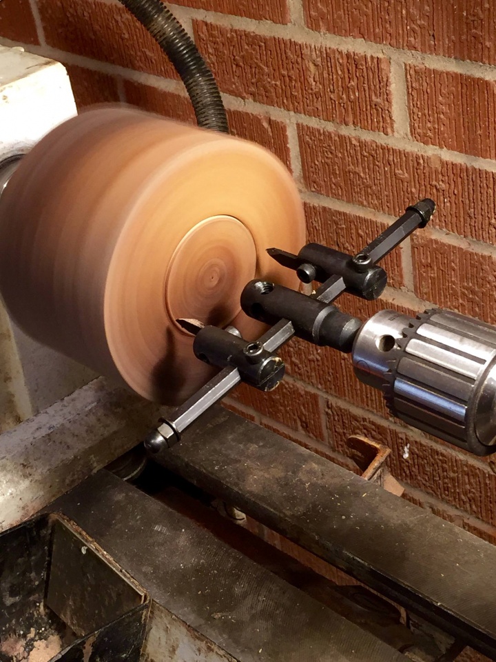

One other thing that I use for marking, it's a ME thing. Is a circle fly cutter set exactly to the size I need to max my 2" jaws on my nova chuck.
attachment.php
this tool is score (mark) ONLY and does not get used for any substantial cutting. It's easy to put it in the drill chuck on the tailstock and touch the blank and pull it out. Perfect and precise every time.

Hi Dan, good to see your bowl coming along! I really like how it's turning out, pun somewhat intended.
I have a pair of big red calipers I picked up from CSUSA a couple years ago. I remember they weren't terribly cheap, but they do allow me to get inside of some forms a little bit to check thickness. I used to measure things by feel. Not terribly scientific, but it works. Most pieces I've done this with have been kind of chunky.
Sound is also important. The pitch goes up as the bowl's walls get more thin. But watch out for chatter! I've turned some bowls that really howled, even when holding a bowl gouge one handed and using my other hand as a steady rest. Those bowls were being turned from very green wood and the surface was awful due to the chatter from the harmonic. This wasn't done on a first bowl, though. I messed up a lot of wood first. :cool:
I've also used my work light to "measure" thickness. I'll get the light close to the piece and try to use the amount of light coming through the wood to help know the thickness of the piece. Again, this wasn't a first bowl attempt.

Is that tenon deep enough with defined enough sides to grip in the chuck? A lot of chucks need a slight dovetail tenon on the bottom of the bowl for a secure grip. Still wish I had a 4-jaw chuck so I could turn some bowls .... :)
Greg,
A chuck is a right not a privilege. :-). Go ahead and get one. Or 3. Haha
His tenon is plenty long enough. Actually very little length is needed. The photo seems to show it as the opposite of a dovetail though - if so that won't fly if so. Some jaws are straight and serrated and others dovetailed. I use dovetail jaws myself for bowls.
Greg,

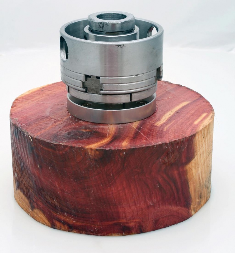

Meh ... I'ld love to get my grubby lil paws on a decent 4-jaw scrolling chuck. Faceplate works OK for small stuff, for me ... but I'm still using this lil bitty mini wood lathe from HFT. I have a tiny 3-jaw scrolling chuck, and that works a little better, for small bowls and boxes, but it won't securely hold a larger bowl ...
Last attempt was a 4-inch bowl. It flew off the lathe twice, after I had flipped it to hollow out the center, and that was with a 1-inch long tenon on it that I really tightened down on with my tommy bars. The second time, I had to dodge quick, and knocked my pen mandrel onto the floor and stepped on it ... :(
The 3-jaw chuck holds small items pretty well, usually. I use it to drill my blanks on the lathe with no problem, but it's got flat jaws with no serrations or dovetail. In order to put it to use, I really need pressure from the tailstock live center or a drill bit to keep the workpiece secure.
At this point, I just can't justify the cost of spending 180 dollars on a decent chuck, because it costs nearly twice as much as my lathe... and I'm looking for a new job. :P
Hmm .... that might be part of my problem .... but considering that the price of that scrolling 3-jaw chuck was only 32 dollars from Harbor Freight Tools, as opposed to a 4-jaw scrolling chuck (Barracuda 2) for 180 dollars .... That's just a little out of my price range. :(
I couldn't find anything else I could use in my price range that would fit my mini wood lathe. The 3-jaw was #1MT.
Hmm .... that might be part of my problem .... but considering that the price of that scrolling 3-jaw chuck was only 32 dollars from Harbor Freight Tools, as opposed to a 4-jaw scrolling chuck (Barracuda 2) for 180 dollars .... That's just a little out of my price range. :( I couldn't find anything else I could use in my price range that would fit my mini wood lathe. The 3-jaw was #1MT.
Yeah, it's not really worth getting a good chuck until you get a bit bigger lathe.
I find a faceplate more secure than a four jaw chuck. I turn stuff up to 15" in diameter. I have had tenons split out on much smaller stuff. Faceplate is much cheaper and gives you more design flexibility. The only draw back is wasting part of the blank if you do not use a waste block. I guess each to his own.
There are many methods for sure. Lyle Jamison uses only faceplates and glue blocks for turning. No chucks.
Most variety is on initial mounting from what I can see.
95% percent of turners seem to use a chuck once the bowl is reversed for hollowing.
Really that depends on how good the attachment is.
attachment.php
Here we see a 2" faceplate securely attached to the bowl blank....
attachment.php
Same faceplate attached to the nova chuck.

I can use a faceplate and turn a small bowl, sure ... it comes out nice if I hollow it and finish the inside and most of the outside that way, but then I part it off and the bottom needs to be finished by hand... I don't really like this method.
I've tried using my 3-jaw to turn a small bowl, told you guys what happened there... It wasn't terribly fun. I turned the outside between centers and managed to turn a 1-inch long tenon on the bottom, then flipped it around to hold in the 3-jaw. It kept wiggling out any time my tailstock wasn't in use.
I'm thinking I may need to just buy another 3-jaw and modify the jaws to give it a very slight dovetail grab. I can't do that yet because that will make it impossible for me to drill my blanks with it anymore, and I only have just the 1 chuck.
I appreciate you looking for a used chuck for me, but as I already mentioned, I'm between jobs ... currently have no money to spare. Thanks for thinking about me and taking the time to look around.
I've determined that my little 1/3 hp mini wood lathe wasn't really meant to do much more than perhaps a 4-inch bowl. I do have a large wood blank that started out nearly 6 inches in diameter. I have found that anything more than extremely light cuts really bogs the speed down or stops the lathe .... which is very bad for my motor and pulley belt. The most I have been able to do with this blank is to turn it round ... it's going to sit on a shelf and wait for a while.

Thanks Charlie for the comment. How was the charing done
Dan,
This demonstrator (from another local club)used a propane bottle torch. He scorched to black but not charred as much as the table top in that video.
Last year, we had Jimmy Clewes doing a 2 or 3 day workshop and the meeting demo. He also did a burnt bowl. Some will lightly brush the scorched/charred surface or even wire brush the surface and then re burn for a more textured, blackened finish. Oak and Ash work well for this.
A matte or satin spray finish is good to seal in the soot and provide some finish without the high shine.
My torched oak pen I had at MAPG last year turned out well and had a rustic, textured effect.
Skie, why would you ever put a 1" tenon on the bottom of your bowl blank? Have you ever checked out any bowl turning videos on You-Tube? If not, I'd suggest that you do, or talk to a bowl turner. All you need for a tenon is about 1/2", anything over that will usually bottom out on the chuck. All you want the tenon to do is to hold the blank level and square to the chuck. It can't do that properly, if it is bottomed out. Bottom line is, you never want your blank to bottom out in the chuck. And, you will never need a 1" tenon, on any bowl blank. I'm not surprised that the bowl blank went flying, with the tenon being so long. The blank was just floating in the air, it wasn't resting up against the face of the chuck jaws like it should.
Len
The 3-jaw chuck has a 1 inch depth of jaws.... I needed that much tenon length to put the bottom of my bowl against the face of the chuck jaws. It WAS NOT bottomed out. I wanted as much wood against the gripping faces of the chuck as possible, without bottoming in the center of the chuck.
I've seen a lot of videos online already ... Captain Eddie is one of my favorites, as is The Naked Turner (thank god he doesn't really turn stuff while naked, it refers to the wood, not him!)

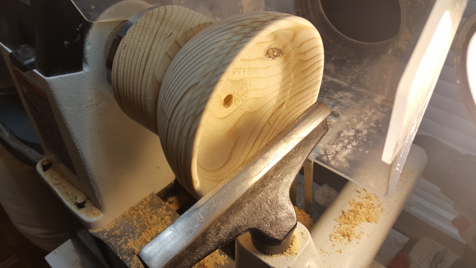

Thank you so much for all the likes, comments and suggestions on how to finish. I started turning the inside and it's going good so far. I think I'm going to look in to a bowl gouge or a round Carbide tool, it's a bit hard to get a curved near the bottom with the cutter I have.

What cutter do you have? In my earlier days making bowls I was ill equipped but I bought some bowl gouges, 2 sizes, and a round nose scraper which have became the best investment that I could buy.
I also have three thickness calipers but the big red one is my go-to caliper (link posted earlier)
Scrapers are very good but nothing and I mean nothing will beat a good bowl gouge. I profile some very very long wings (irish grind) on mine and essentially it is 3 chisels in one.
the other thing that really upped my game was S curved tool rest. I have 2 sizes and I have full support to the bottom of the bowl be it the inside or the outside. I can also shape the bowl to the tool rest and get good shape :)
Also a word of caution.
The gap between the tool rest and the cutting surface. If it is LARGE there is a greater safety risk at play. A catch can cause tremendous damage to you and to the bowl. the tail end of the chisel can easily swing up and hit you in the face.
I agree with Ed, you can't beat a bowl gouge. I actually have 5 but the one I use more than all the others combined is my Woodriver (Woodcraft brand) with the very swept back wings. It does 80% of my bowl work inside and outside and like Ed it is like having several chisels in one. My other bowl gouges are a Sorby and 3 from PSI. I bought the 3 from PSI as a set that was very inexpensive and I have re-profiled them several times to experiment. They work very well.
I also have a heavy duty scraper for the inside. I believe I got it from PSI.
I have carbide tools but I do not use them on regular bowls. I do, sometimes, use them on end grain hallow forms.
