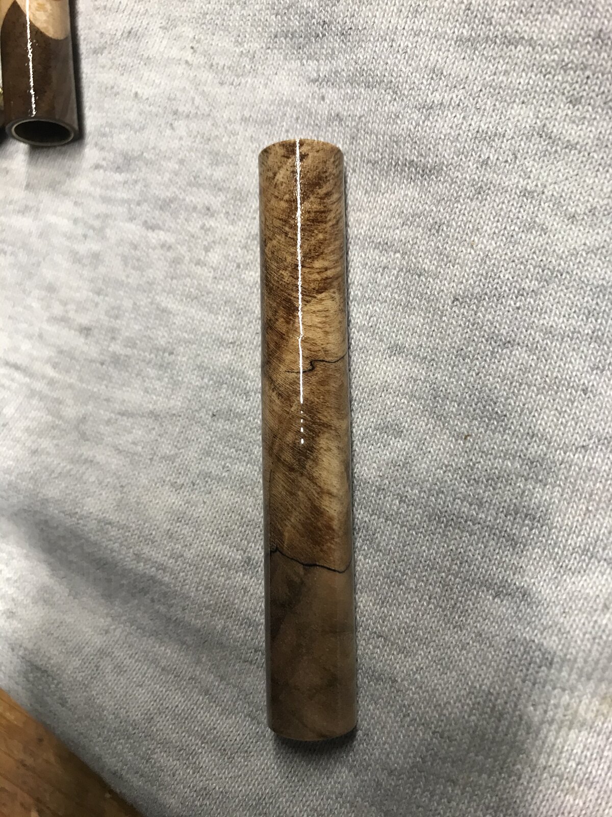

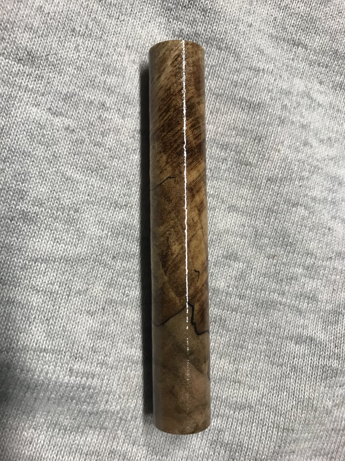

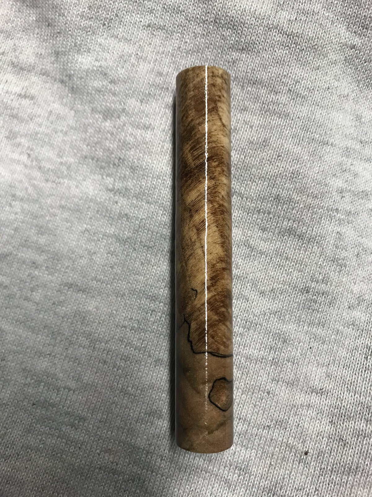

Hello all, I turned a spalted maple pen and noticed, only after turning, that the bottom portion, along the spalting line was a slightly different color. More muted but still interesting. I am used to larger color differences with spalting.
I went to my copy of Understanding Wood by R. Hoadley, but I still don't understand the effect of spalting on coloring and brightness, etc. Possibly lack of nutrients? Obviously I'm not scientist, but does someone know why this happens so that I can explain it to friends and clients?

Thanks for giving me the incentive to re-read Hoadley . I am in no way an expert , but there are a few things that could be going on with your piece .
Your suggestion of nutrient differences could enter into it in several ways . Nutrients stored in a piece of wood will reflect the site where it was grown . Many plant species are bio-accumulators of some chemical elements that are only needed in very small amounts , if at all , for their metabolism . Concentration of those elements can vary widely with topography and soil type . They in turn may well affect fungal growth , and will probably affect different fungi differently . It is quite possible that several different fungi are present in your sample , perhaps both sap staining and white rot types as described by Hoadley . His descriptions of how fungal advance through wood may change with the seasons , and with wet/dry cycles , are also pertinent .
Don`t know if that helps you or not . I commend your desire to provide customers with a detailed story of the wood . Spalted woods are fun . Keep exploring !
I have had many pieces of wood with that exact appearance and in my view, 2 things may have happened, 1 is the fungi hasn't yet reached that bottom area or 2, that part of the wood has a different density or is saturated with sap resins still no broken down, fungi keeps away of that.

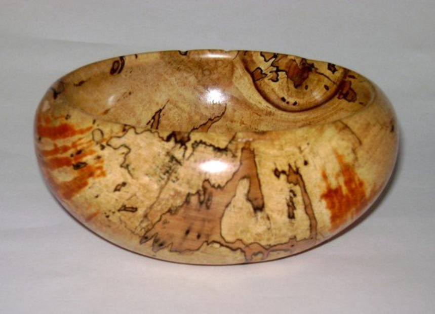

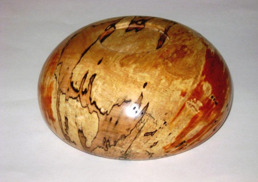

What happens is different mold spores compete for space (if you will) Some mold will die off... then later, a different type will also grow into the same area. These mold spores can vary in color and how the travel through the wood. You can see how a few different mold spores actually attacked this maple bowl I made. I have no idea what mold made the orangish coloring... but I'd love to find out and grow it.
