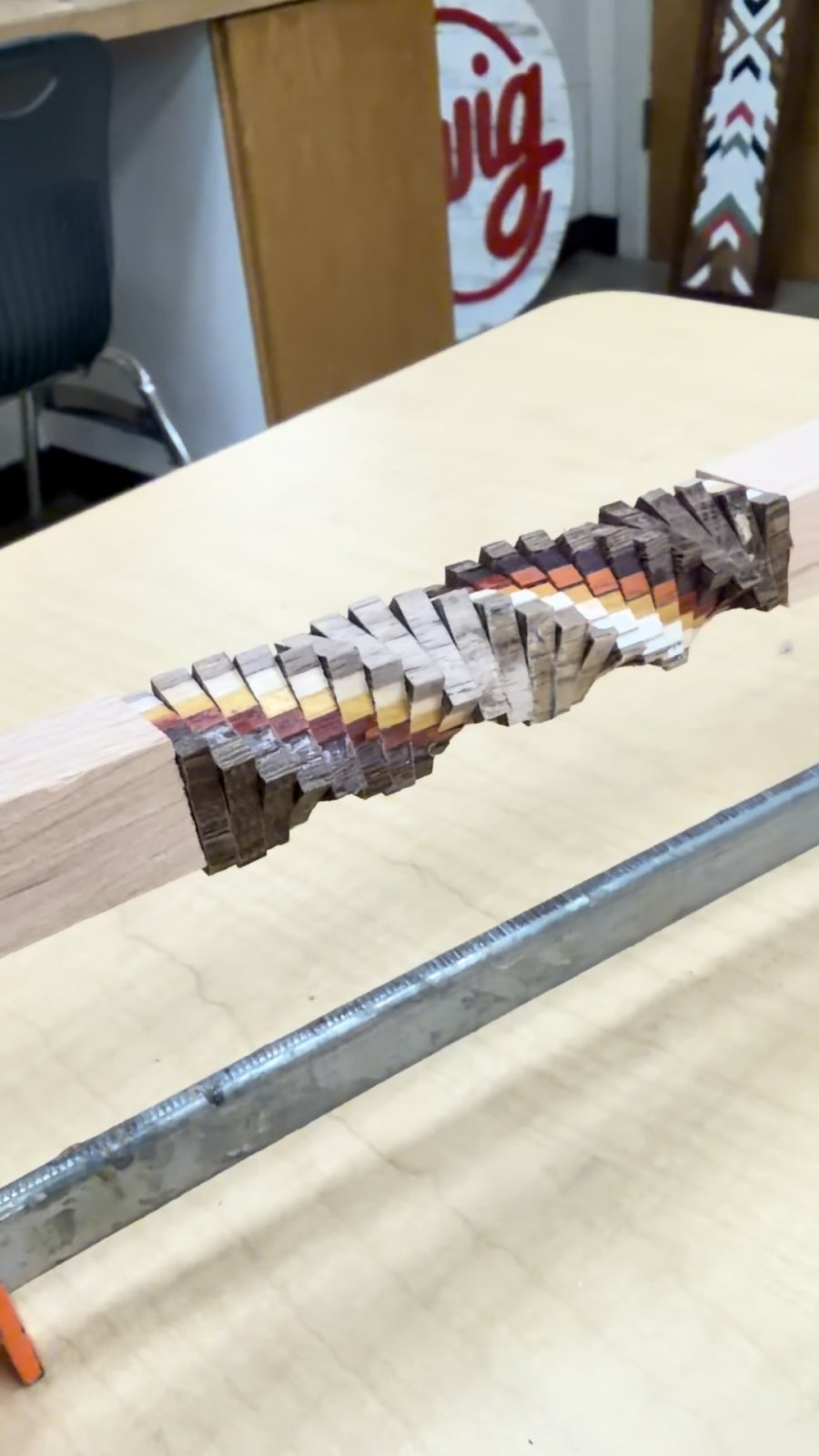

Hello! I've been planning on making this segmented blank for a while. I want to make sure I know exactly how I'm going to do everything before I get started on it.
The question I had was how do you sand segmented blanks while avoiding bleed-out or getting sanding dust stuck to other colored woods?
I'd really appreciate any opinions and/or advice you have, thank you in advance!

Looks very nice. I love your timber/color choices and the attention to spacing. Your rotation of the segments looks excellent. Not sure, and it may be the photo angle, but maybe a slight indent/space between the segments??? An added wood/misc/credit card/etc spacer may be helpful. If only a slight divot, I have used Mylands Sanding Sealer for minot dips before final sanding. BUT - I really like this design - it was popular back 'in the day' but not as common now. Still a very nice design and one where you can show sloppy attention, or as with yours - excellent attention to subtle elements. Thanks for sharing. 👏 👏 👏
Thank you for your tips! There is a slight gap between the segments. I think they are caused by the blade when I was cutting on the bandsaw. I should've sanded more before I glued them. Luckily, there is clear epoxy filled between the gaps and you can't see the brass tube. 👍🏼😀
OK. I suggest that there would be be no need to sand the blank down further before gluing and casting (If you did). Sanding down further would make the blank look better, but really no better for the final turning and sanding. - You're good!!
