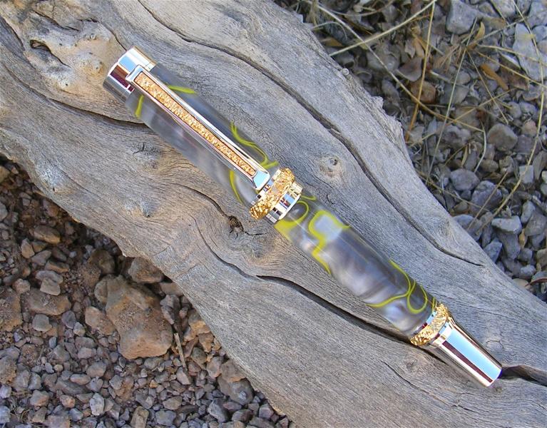

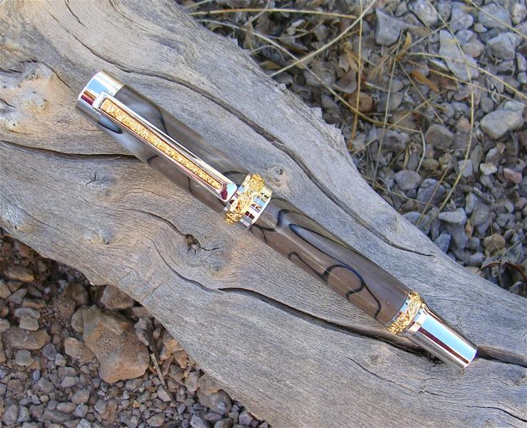

A couple of Roman Harvest Rollerballs in Rhodium and TiGold accents.

James, like them both, good match of component and blank.

Very cool! Fit-n-finish are spot-on.
Psst, grab that chunk of wood them great pens are laying on in the photo shoot, and turn it....I bet it looks awesome inside!

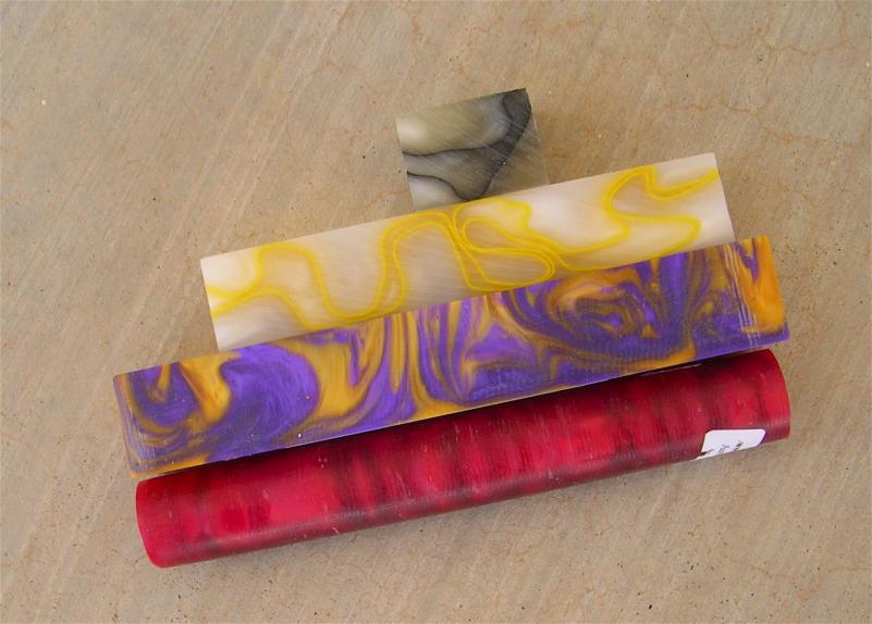

At first I used to do the same thing, paint the tubes until I used a very translucent blank and saw the air pockects in the epoxy.
As Roy says, paint the inside of the pen blanks prior to glueing in the brass tubes. On these rollerballs I used some Liquitex acrylic paints I have kicking around. Antique Bronze one and Antique Silver on the other. Since the blanks were pretty translucent I applied a second coat in case of streaking.
I took a small dab of the paint on a toothpick and colored the epoxy as well.
The two Roman harvest Fountain Pens I made with these also have thin walls as I like the look of straighter barrels.
The blanks in the picture are from BearToothWoods, top to bottom:
Berea AA-44
BearTooth Acrylic Lemon Peel
Amalgam-Mutt Louisianna Lava
BearTooth Acrylic Rage Red
Berea AA-44
