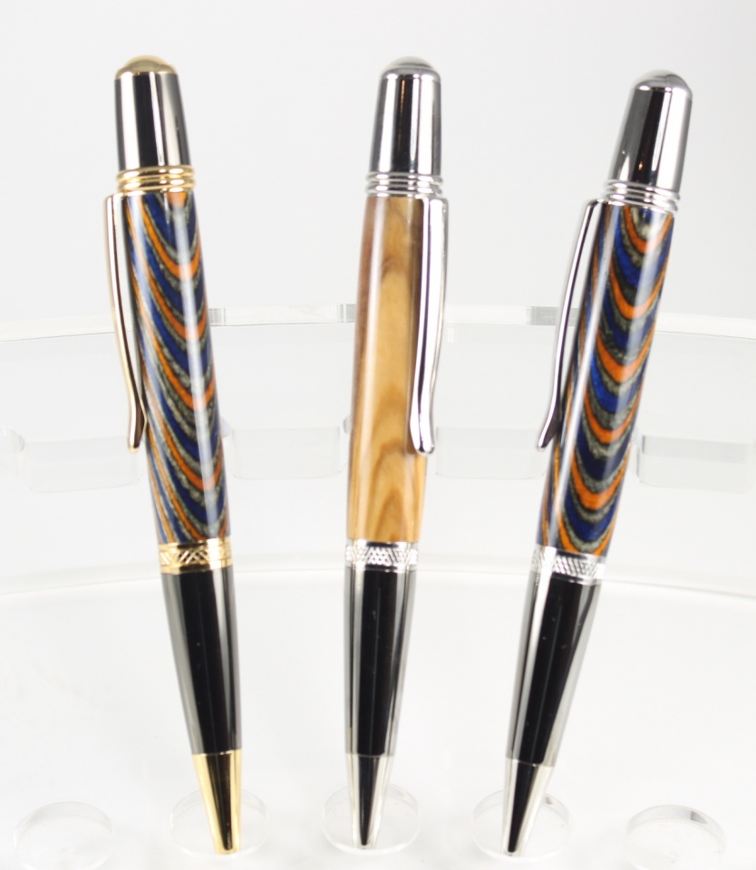

I just tried GluBoost for the first time today. I used to do the CA/BLO method. I did use BLO onto one of my pens to see if it "popped" the color, but it made almost no difference. I didn't do BLO between layers as I was using their accelerator instead. I will say this is MUCH faster to get done than my CA/BLO and thats was pretty quick.
Gold on left was plain. Middle is olive wood (nothing done to the wood to eliminate oil). Right was wiped with BLO before finish.
All were GREAT and very quick. So far I'm a fan.
