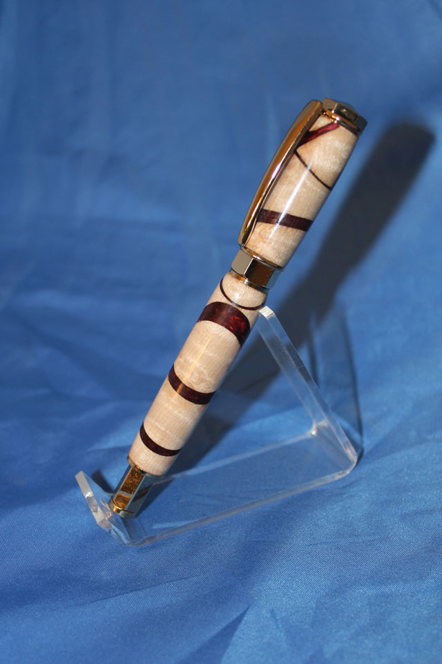

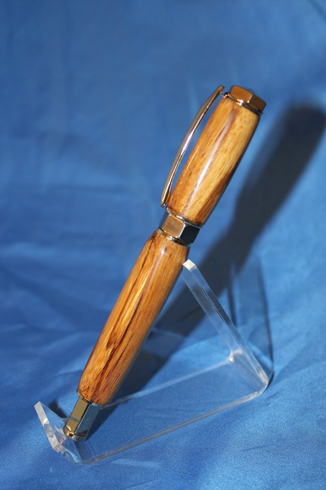

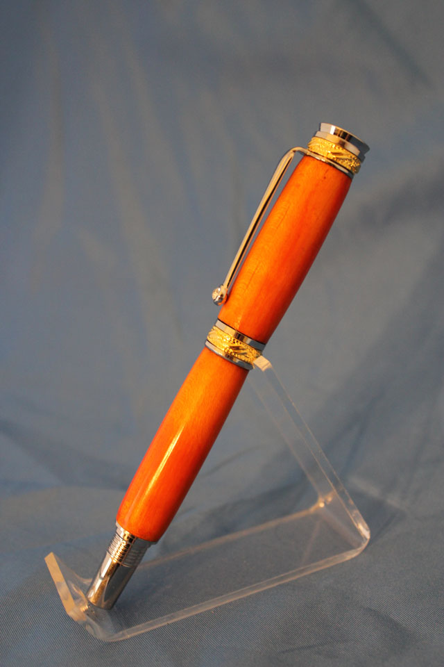

I have attached some pictures. I classic wood pen with 4 coats of GluBoost. The half wood / half acrylic I mentioned above. And finally the amber tinted maple blank. I caution I am not a photographer so please be kind to my skills there.
If you have any question or comments – let me know. For anyone going to Turn On! Chicago I will be demoing it there and will have it available for the Friday night "Pens For Troops" turning session.

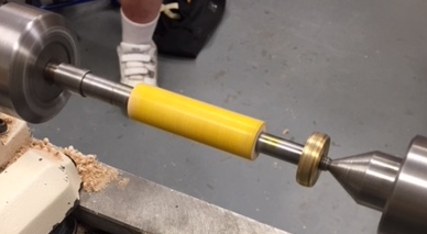

I've had a chance to play with the GluBoost products for a few weeks now and even gave a brief demonstration for the Richmond Woodturners of some of the features. I ordered one bottle of Fill and finish pro (medium), Fill and finish thin, the Gluboost accelerator and one of the vintage color tint packages. Over the 12 years I have been making pens, I've used several brands of CA but for the recent past I've settled on Titebond thin and medium and Satellite City accelerator. For one, I like the CA bottles and two, our local Woodcraft carries them and I like to support the local store.
The reasons I wanted to give this a try include wanting to try new things, to see if the accelerator would eliminate the white spots when I try to make a patch, to see how the tints work as described, to see if the tints would act as a colorant to laser etched or CNC carved patterns and to see if the medium would do a better job at building up a smooth surface over etched items.
First, the bottle. One of the reported features was a metal tip inside the cap to help avoid buildup. Yes, it's there, but it's also on my bottles of Titebond which appear to be exactly the same bottle except with a black rather than a clear cap.
I should note that I sometimes used only 2 or 3 coats of thin on some woods and with buffing am able to get a very high gloss smooth surface. Can I do the same with GluBoost? Yes. I've also built up fairly heavy thicknesses on some clay, abalone and snakeskin blanks and have personally never see the cracking that many have reported. Maybe I'm lucky, but I cannot comment on this feature.
For open grained woods such as walnut and purple heart and burls, I normally wet sand with 220 grit and a few drops of CA to seal the pores and open spots. I wanted to see of the fill and finish pro could eliminate that step. The answer is no.
As for buildup over laser etched barrels, I general use enough coats of thin and or medium so that you can't feel the indentations from the laser. Since this is more of a volume needed, I find no functional difference between the Titebond and GluBoost.

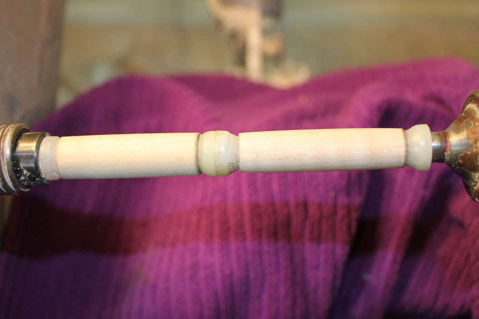

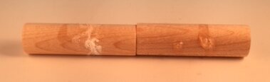

To test to see if the accelerator did not create white spots, I placed a liberal amount of CA on a barrel and sprayed liberal amounts of GluBoost on one blank and Satellite City on the other. This is where I definitely saw a big difference. The one on the right is GluBoost. If you experience this phenomenon, the GluBoost is definitely the accelerator of choice.
attachment.php
The last tests were on the tints. I first tried it as a color fill for a CNC engraved blank. While it did fill color the engraving, it also colored the surrounding areas which I was able to sand off. Would it work? Yes, but I think there are better methods at least for me. The last test was with several pigments and tints and the two brands of CA I had. There must be something a little special about the GluBoost tint as Transtint and other pigments tended to clump up. When the GluBoost tint was mixed with either CA, it stayed liquid long enough for easy application to a blank using a Q-Tip and applying with the lathe turned off. I'm not sure if I ever need to tint something and there are probably other method methods, but this was pretty cool. Perhaps a sunburst is in my future.
attachment.php
Bottom line: The most interesting features for me are the elimination of white spots when using GluBoost accelerator and the ability to tint. The CA is on the high side of pricing but not exorbitant relative to what I have been using. I do wish the accelerator came in a larger quantity. Listed on the bottle is net weight 2.4 ounces whereas the Satellite City lists net weight 6 ounces at similar pricing. For me, it will be a "special purpose" accelerator.
