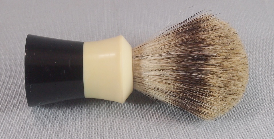

My restoration of my Grandfather's brush
I used pliers to pull out the hair, bored out the glue with a forstner's bit, did a little clean up of the hole with a dremel tool, polished the handle with Hut's plastic polish and epoxied in the new knot. Voila'
Did you use a special type of epoxy to glue in the knot? I was thinking almost any epoxy or CA would both resist water enough for this application.
Cwalker935
May 18, 2014
3,506
Richmond, Va
I just used 5 minute expoxy.
