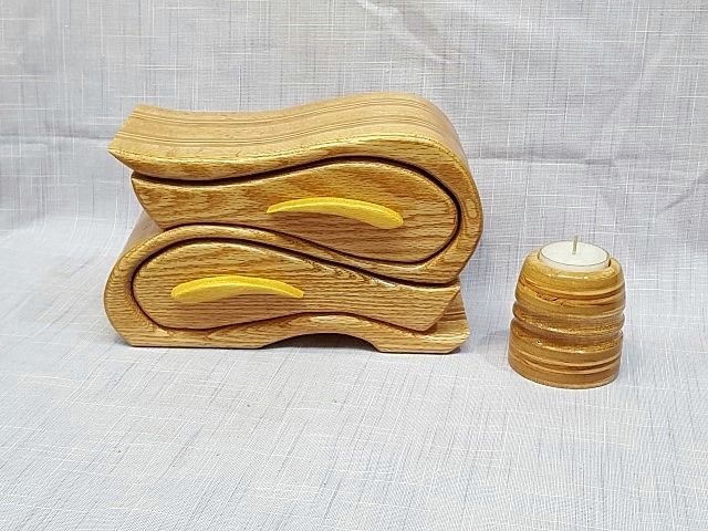

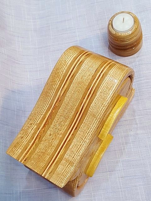

Glued up the block for this one yesterday afternoon . Got it up to this point today.
Will post another picture after finishing the inside of the drawers.
The Tea light was made by salvaging the wood out of the inside of the two deepest drawer compartments . .

These are very neat, but I'm stumped by how you manage to save the chunks from inside the drawers. Do you not glue up the full block then cut the shape or am I missing something. ......
W.Y.
Aug 10, 2008
1,656
BC, Canada
You cut out the small block of the drawers from the original large block .
Then cut off the front and back of the drawer pieces and hollow them out with the band saw and then glue the front and back on .
Thanks for asking .
There are lots of videos on you tube that shows the whole process from start to finish .
